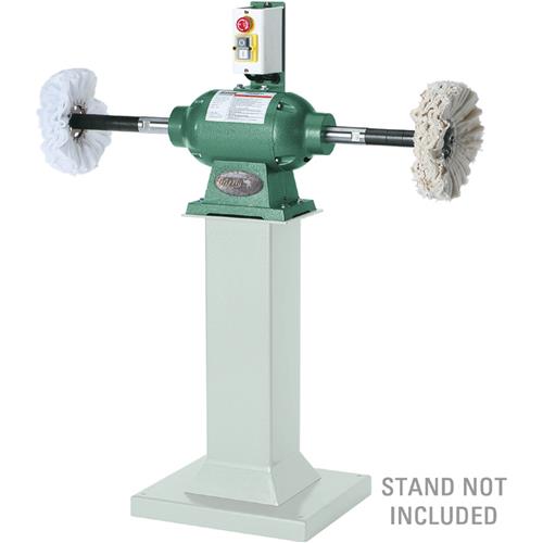

We have resolved the age old problem of bumping into the motor housing when buffing.
This Buffing Machine is designed for buffing large (bulky) items, where it is critical to have clearance to properly buff as well as prevent damage to the item being buffed.
Excellent for projects like buffing guitar bodies, bowls, pool cues, etc...The G3622 has a special motor that turns at a slower RPM that is required for large wheels and to prevent burning off the finish.
Each Buffing Machine includes sets of different size spacers to be able to accommodate different wheel widths.
- Motor: 220V, 60HZ, 6 Pole
- R.P.M.: 1,200
- Amps: 8
- Overall height: 45-3/8" (with optional stand)
- Width: 38-1/2"
- Depth: 15-3/4"
- Stand height: 36-3/4"
- Shaft size with thread: 7/8" x 8"
- Wrench size: 1-3/8"
- Bushings (1", 1-1/2", 2"L): 4, 4, 2 per set
- Shipping weight approx.: 103 lbs.
- Optional stand available - order model # G4789
