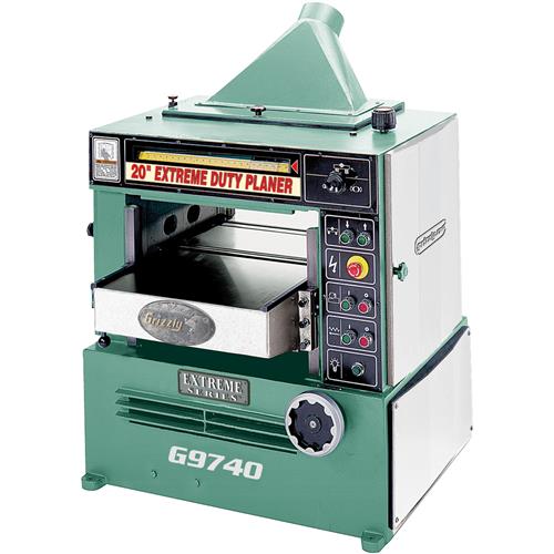

We mean exactly what we say: this planer is for
extreme duty!
This machine is solidly built weighing a massive 1700 pounds, power up/down control for the table and variable speed feed. And there's more! The bed rollers on this machine are power driven and adjustable for height when rough-cut lumber is milled. Segmented chip breakers and four knife cutterhead means you can get the best possible finish. Check out the impressive specs and features below, and you will agree that this workhorse makes a great investment.
Maximum cutting width: 20"
Maximum cutting height: 9"
Maximum depth of cut: 5/16"
Minimum stock thickness: 1/4"
Minimum stock length: 10"
Cutterhead diameter: 4-5/8"
Knives: 4 high speed steel 20-1/8" x 1-3/16" x 1/8"
Table size: 20-1/8" x 35-3/8"
Cutterhead R.P.M.: 5000
Rate of feed per minute: 20-40 F.P.M.
Number of cuts per inch: 83.3-41.6
Number of cuts per minute: 20,000
Motor: 7-1/2 H.P., 220V, three phase
Cutterhead power transfer: Belt drive
Motor bearings: Shielded and lubricated ball bearings
Overall size: 42-1/2"H x 38-1/2"W x 35-3/8"D
Crate size: 46"H x 46"W x 42-1/2"D
Shipping weight approx. 1700 lbs.
Features:
Precision-ground cast iron table
Power feed rollers are steel, serrated infeed and polished outfeed
Micro adjustment of table height
Variable feed rate
6" dust port
Convenient control panel
See page
61
of our 2008 Grizzly Catalog!
