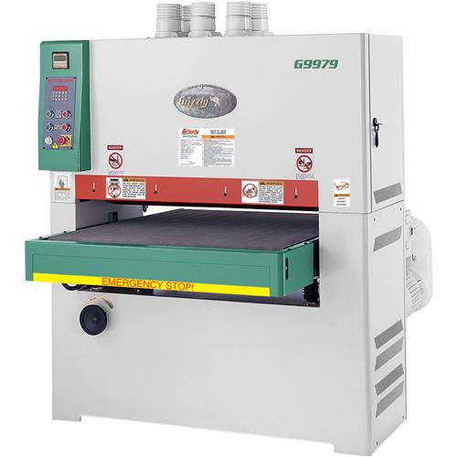

Description
When your sanding needs fall under the category of production level, look no further than Grizzly for your wide belt sander. Manufactured for the industrial user, these machines feature state of the art electronics, precisely engineered components & innovative design & construction. Whether you need to sand a silky smooth finish on a highly figured tabletop, dimension rough lumber or simply run panels all day long, these sanders will make light work of the toughest jobs. We have a limited supply of stock that is CSA certified. Please call 1-800-523-4777 for more details, as these are available upon request only. Shipping exceptions may apply.
  • Sanding belt motor: 25 HP
  • Voltage/Phase: 220/440V*, 3-Phase
  • Belt feed motor: 2 HP
  • Table elevation motor: 1/4 HP
  • Pressure roller type (double): Rubber
  • Infeed Drum: Spiral Grooved Rubber
  • Outfeed drum: Steel
  • Belt roller diameter (each): 4"
  • Platen: Micro Adjustable Graphite/Felt
  • Size of sanding belt: 43" x 60"
  • Maximum board dimensions: 43"W x 6"H
  • Minimum board length: 14"
  • Conveyor speeds: Variable, 14-60 FPM
  • Surface speed of drums: 2,200 FPM
  • Shipping weight approx.: 2490 lbs.
    Features:
  • Convenient control panel with separate switches for each motor
  • Amp meter load sensing system
  • Disc brake system for emergency stops
  • Variable feed speeds
  • Fast belt changes (takes less tan 30 seconds!)
  • Pneumatic sanding belt oscillation control
  • Digital readout to within 0.005"
  • (5) 4" dust ports
  • 440V operation requires purchasing additional components and installation by our technicians. Please call customer service at (570) 546-9663 for more information.
