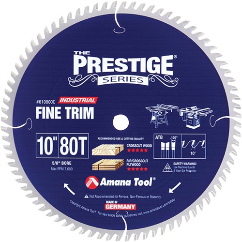

Image for Amana T32910 - 10" x 5/8" x 80T ATB Electro-Blu Trim Blade
Our trim blade, suitable for use on table saws, sliding table saws, radial arms, and miter saws of all types, leaves a super-smooth finish when cutting hard or softwood. It is especially suited to trimming and sizing veneers and laminates, in single sheets or in stacks. The alternate top bevel grind and high tooth counts produce excellent, chip-free cuts. The 10° hook angle provides effortless feeding.
Benefits of Electro-Blu™ Coating
  • Reduces resin accumulation and heat build-up
  • Tips stay sharper longer resulting in extended blade life
  • Applied by using an electrostatic bonding process
  • Diameter: 10" (250mm)
  • Teeth: 80
  • Bore: 5/8"
  • Tooth Grind: ATB
  • Hook Angle: 10°
  • Kerf: .126" (3.2mm)
  • Plate: .087" (2.2mm)
