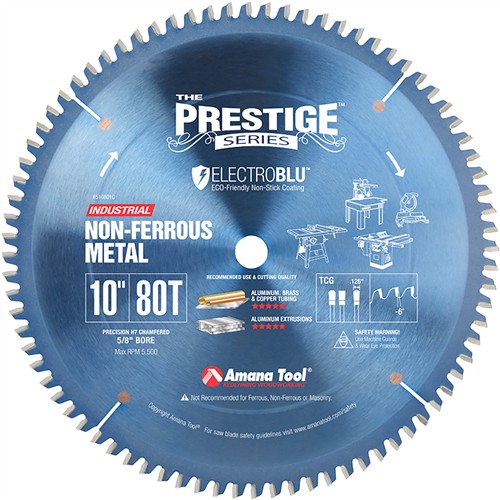

Amana T32907 - 10" x 5/8" x 80T TCG Ripping Saw Blade
T32907 Amana 10" x 5/8" x 80T TCG Electro-Blu Ripping Saw Blade
Thanks to its special carbide formulation and blade geometry, this is the ideal blade for cutting relatively thin-walled aluminum and non-ferrous extrusions and frames. The negative hook angle (-6°), triple-chip grind and thick plate combine to produce a superior finish. The blade can also be used to cut other "difficult" materials such as plastic, PVC tubing, fiberglass and ACM (Aluminum Composite Material).
Warning: Never attempt to cut ferrous metals with these blades.
Clamp down the workpiece. For optimal results and extended saw blade sharpness use blade wax, mist lubricant system or air cooling.
Benefits of Electro-Blu™ Coating
  • Reduces resin accumulation and heat build-up
  • Tips stay sharper longer resulting in extended blade life
  • Applied by using an electrostatic bonding process
  • Diameter: 10" (250mm)
  • Teeth: 80
  • Bore: 5/8"
  • Tooth Grind: TCG
  • Hook Angle: -6°
  • Kerf: .126" (3.2mm)
  • Plate: .102" (2.6mm)
