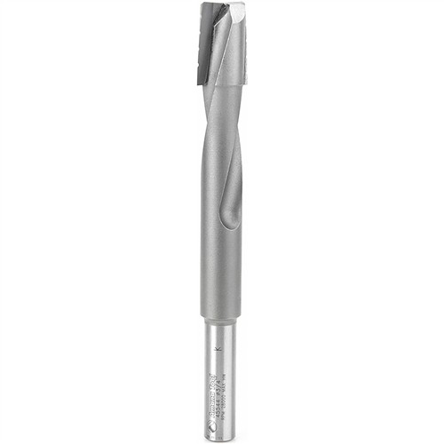

These bits are designed to do deep slot and holes for tenon, especially in doors, chairs, tables etc. Special carbide with a 1" long up-shear and chipbreaker for fast cuts and chip clearance. For use in lock mortising machines and door machines.
Warning: DO NOT USE THESE BITS ON A DRILL PRESS MACHINE UNDER ANY CIRCUMSTANCES
  • Diameter: 3/4"
  • Cutting Height: 1"
  • Shank: 1/2"
  • Overall Length: 6-5/8"
  • Flutes: 2
