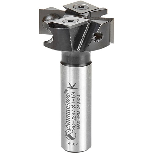

Amana T32920 - Insert Carbide Mini Spoilboard Surfacing Rabbeting Slab Leveler 1/2" Shank Router Bit
Amana T32920 Insert Carbide Mini Spoilboard Surfacing Rabbeting Slab Leveler 1/2" Shank Router Bit
Mini insert carbide spoilboard surfacing & rabbeting with scorer, great for cutting tight corners.
Features unique 2+2 insert knife design that contains two cutting flutes and two up-shear scorers, which provide a smoother finish at the bottom of the cut than traditional two-knife style router bits. Great for surface planing.
Also suitable for router sled machines. Make sure that your router sled is fully stable and squared.
Perfect for:
  • Resurfacing spoilboards using CNC
  • 2+2 spoilboards contain two bottom scorers for better performance, finer surface finish and better clearance for 90° corners.
  • Planing large glued up panels using CNC
  • Surfacing and finishing wood using timber slab machines
  • Rabbeting or slotting
    Designed for planing & rabbeting the following materials:
  • MDF
  • Fiberboard
  • HDF/LDF
  • Balsa Core
  • Epoxy (Epoxy Resins)
  • High Density Urethane (HDU Board)
  • Plastic/Acrylic
  • Plywood/Chipboard
  • Hardwood/Softwood
  • Ultra-High-Molecular-Weight Polyethylene (UHMWPE)*
    * Use lower CNC spindle RPM and adjusted feed-rate to prevent Melting and adhesion of the acrylic material to the tool.
    Featuring:
  • 2+2 design
  • 4-sided solid carbide insert knives
  • Exclusive carbide grade for highest quality of cut
  • Maximum cutting efficiency
  • Faster material removal process
  • Max RPM: 24,000
    These industrial router bits feature solid carbide insert knives with four cutting edges that allow users to rotate the knife when one side becomes dull providing the highest-quality finish available on woodworking tools. See T33209 and T33210 for replacement carbide inserts for this router bit.
    Recommendations: For surfacing solid woods it is recommended to remove both bottom scorers
