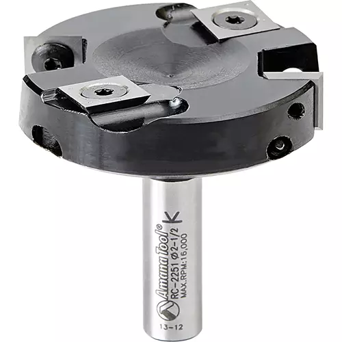

Amana T32919 - Insert Carbide Spoilboard Surfacing Rabbeting Slab Leveler 1/2" Shank Router Bit
Amana T32919 Insert Carbide Spoilboard Surfacing Rabbeting Slab Leveler 1/2" Shank Router Bit
A great tool for fast removal of materials over a large surface area.
Features unique 2+2 insert knife design that contains two cutting flutes and two up-shear scorers, which provide a smoother finish at the bottom of the cut than traditional two-knife style router bits. The scorer leaves an improved finish at the bottom of the cut. Great for surface planing.
Also suitable for router sled machines. Make sure that your router sled is fully stable and squared.

  • Flattening live edge slabs using router sleds/mills or CNC machines
  • Resurfacing spoilboards using CNC
  • 2+2 spoilboards contain two bottom scorers for better performance, finer surface finish and better clearance for 90° corners.
  • Planing large glued up panels using CNC
  • Surfacing and finishing wood using timber slab machines
  • Rabbeting or slotting

    * Use lower CNC spindle RPM and adjusted feed-rate to prevent Melting and adhesion of the acrylic material to the tool.

  • Max RPM: 19,000
    These industrial router bits feature solid carbide insert knives with four cutting edges that allow users to rotate the knife when one side becomes dull providing the highest-quality finish available on woodworking tools. See T33207 and T33208 for replacement carbide inserts for this router bit.
    Recommendations: For surfacing solid woods it is recommended to remove both bottom scorers
