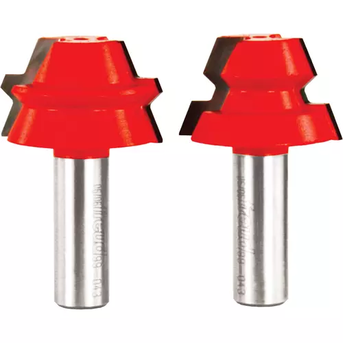

T33483 Freud 1-15/32" Lock Miter Bit
Create rock-solid interlocking corner joints with this lock miter bit.
The lock miter bit is designed to cut two complementary pieces of wood that will fit together like a puzzle.
One piece of wood has a vertical edge with a deep groove cut into it, and the other piece has a horizontal edge with a matching protruding tongue.
When the two pieces are joined together, the tongue fits snugly into the groove, creating a strong and secure joint.
The 45° joint formed by this lock miter bit is often used in the construction of cabinets, furniture, and other woodworking projects.
For routing solid hardwood or softwood on table mounted routers or CNC machines only.
- Shank diameter: 1/2"
- Number of cutters: 2
- Angle: 22.5°
- Cutter diameter: 1-15/32"
- Cutting length: 7/8"
- Overall length: 2-3/8"
- Maximum RPM: 16,000
- Creates remarkably strong interlocking joints
- Freud Perma-SHIELD® Coating
- Use on CNC or table-mounted routers only
- Best for hardwood and softwood, also routs plywood and composites
