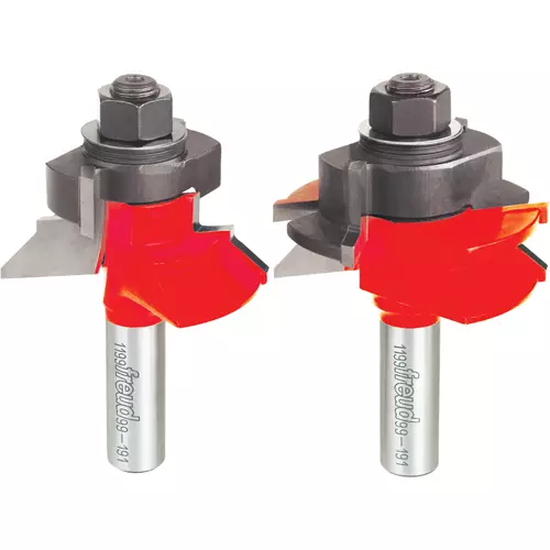

T33484 Freud 2-11/64" "V" Panel Bit Set
A bit set to create beautiful "V" Groove paneling.
A "V" Panel Bit Set is a type of router bit set that is used to create a decorative V-shaped groove or panel in a piece of wood.
The set usually consists of two router bits–one for making the groove and the other for creating the corresponding tongue.
V-Groove paneling is ideal for ceilings, walls, wainscoting or cabinets, and this set lets you mill from the stock that best suits your project.
The set includes two 1/2" shank bits with spacers that allow you to produce "V" paneling from 1/2", 3/4", or 1" thick stock.
Use these bits only in table-mounted routers.
- Shank diameter: 1/2"
- Angle: 45°
- Cutter diameter: 2-11/64"
- Cutting length: 1-1/8"
- Overall length: 3-3/8"
- Maximum RPM: 16,000
- Mills V-Groove paneling from any hardwood, softwood, or composite material
- Includes spacers to rout 1/2", 3/4" or 1" stock
- Use only in table-mounted routers
- Freud Perma-SHIELD® Coating
