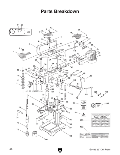

Parts for G0482 22" Floor Model Heavy-Duty Drill Press
Parts Diagrams for G0482 - 22" Floor Model Heavy-Duty Drill Press
Parts List for Parts for G0482 22" Floor Model Heavy-Duty Drill Press
*DISCD*SPINDLE PULLEY
*DISCD*HEX NUT M33-1.5 LH
$3.45
*DISCD*PULLEY COVER
$92.90
Now: PS68M
PHLP HD SCR M6-1 X 10
*DISCD*COVER KNOB M6-1
BALL BEARING 6203ZZ
Now: PVA25
V-BELT A25
*DISCD*PULLEY MIDDLE
$17.25
Now: PR54M
INT RETAINING RING 15MM
Now: PVA40
V-BELT A40
Now: PR74M
INT RETAINING RING 45MM
*DISCD*SHAFT ASSEMBLY
*DISCD*MOTOR PULLEY
SET SCREW M6-1 X 10
*DISCD*STRAIN RELIEF
*DISCD*MOTOR CORD
*DISCD*CORD W/PLUG
*DISCD*PULLEY INSERT
$17.25
Now: PR75M
INT RETAINING RING 66MM
*DISCD*BEARING SPACER
BALL BEARING 6007ZZ
SET SCREW M8-1.25 X 28
Now: PN03M
HEX NUT M8-1.25
LOCK NUT M12-1.75
*DISCD*COIL SPRING & CAP
Now: G8988
Safety Paddle Switch
Now: PS74M
PHLP HD SCR M4-.7 X 14
*DISCD*LIGHT SWITCH
*DISCD*SWITCH PLATE
Now: PS74M
Now: PS09M
PHLP HD SCR M5-.8 X 10
*DISCD*SWITCH BOX
$7.50
Now: PN03M
HEX NUT M8-1.25
*DISCD*DEPTH STOP BRACKET
Now: PS04M
PHLP HD SCR M8-1.25 X 20
*DISCD*POST DEPTH STOP
*DISCD*DEPTH STOP NUT M12-1.75
Now: PS68M
*DISCD*MOTOR BRACKET SUPPORT
Now: PS09M
*DISCD*CORD CLAMP
Now: PR05M
EXT RETAINING RING 15MM
45
*DISCD*WING SCREW M10-1.5 X 32
46
Now: PS39M
PHLP HD SCR M8-1.25 X 10
*DISCD*ADJUSTING LEVER
48
Now: PR02M
EXT RETAINING RING 14MM
49
*DISCD*LEVER SHAFT
50
Now: PB07M
HEX BOLT M8-1.25 X 25
51
*DISCD*MOTOR PLATE
52
LOCK WASHER 12MM
53
Now: PN09M
HEX NUT M12-1.75
54
*DISCD*MOTOR 1-1/2HP 110/220V
$277.75
55
Now: PN03M
HEX NUT M8-1.25
56
*DISCD*RUBBER SEAL
57
*DISCD*JUNCTION BOX
$3.45
58
Now: PS05M
PHLP HD SCR M5-.8 X 8
59
Now: PS17M
PHLP HD SCR M4-.7 X 6
60
SET SCREW M10-1.5 X 12
61
Now: PS09M
62
*DISCD*LAMP BRACKET
63
*DISCD*SPACER
64
*DISCD*PINION SHAFT
$37.10
65
*DISCD*DOWNFEED HANDLE M10-1.75
66
*DISCD*DOWNFEED KNOB M10-1.75
67
Now: PN41M
HEX NUT M25-2 LH
68
BALL BEARING 6005ZZ
69
*DISCD*QUILL BASKET
70
*DISCD*QUILL
71
THRUST BEARING 51107
72
BALL BEARING 6007ZZ
73
*DISCD*SPINDLE
$54.35
74
*DISCD*DRIFT KEY
75
*DISCD*ARBOR MT4/JT3
76
Now: G8583
1/32"-5/8" x JT3 Keyless Drill Chuck
77
*DISCD*RACK
$20.45
78
Now: PS14M
PHLP HD SCR M6-1 X 12
79
*DISCD*RACK COLLAR
$7.50
80
*DISCD*COLUMN
80-1
*DISCD*COLUMN AND FLANGE
81
*DISCD*TABLE BRACKET
82
*DISCD*CORD PROTECTOR
83
*DISCD*GEAR SHAFT
$2.05
84
*DISCD*CORD FOR LAMP
85
Now: PB03M
HEX BOLT M8-1.25 X 16
86
*DISCD*ADJUSTMENT HANDLE
87
*DISCD*COLUMN LOCK HANDLE
$5.20
88
*DISCD*ELEVATING WORM
89
*DISCD*HELICAL GEAR
90
*DISCD*ZERO SCALE
91
*DISCD*TABLE
92
Now: PN32M
HEX NUT M14-2
93
Now: PW10M
FLAT WASHER 14MM
94
*DISCD*ARM STUD M14-2 X 63
95
Now: PB33M
HEX BOLT M12-1.75 X 50
96
LOCK WASHER 12MM
97
*DISCD*BASE FLANGE
$64.40
98
*DISCD*BASE
99
100
*DISCD*DOOR CLOSED HORIZONTAL
$6.05
ELECTRICITY 1.4W X 1.2H
*DISCD*MACHINE ID LABEL
*DISCD*SPEED CHART
$1.49
HEX WRENCH 3MM
HEX WRENCH 5MM
106
*DISCD*CHUCK GUARD ASSEMBLY
MANUAL
*DISCD*MANUAL FOR G0482 01/06
