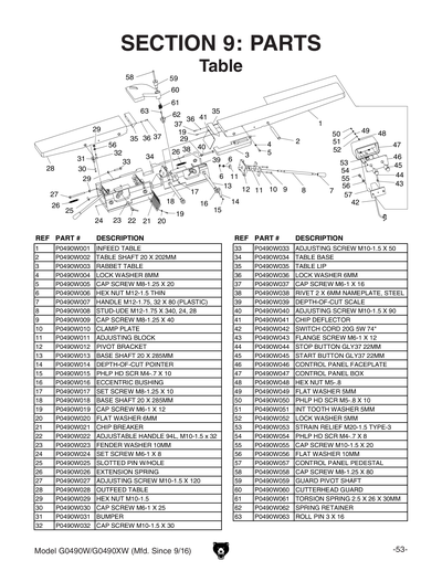

*DISCD*INFEED TABLE
$169.95
*DISCD*TABLE SHAFT 20 X 202MM
*DISCD*RABBET TABLE
LOCK WASHER 8MM
CAP SCREW M8-1.25 X 20
Now: PN60M
HEX NUT M12-1.5 THIN
*DISCD*HANDLE M12-1.75, 32 X80 (PLASTIC)
$2.60
*DISCD*STUD-UDE M12-1.75 X 340, 24, 28
$6.65
CAP SCREW M8-1.25 X 40
*DISCD*CLAMP PLATE
$1.49
*DISCD*ADJUSTING BLOCK
*DISCD*PIVOT BRACKET
*DISCD*BASE SHAFT 20 X 285MM
*DISCD*DEPTH-OF-CUT POINTER
Now: PS38M
PHLP HD SCR M4-.7 X 10
*DISCD*ECCENTRIC BUSHING
SET SCREW M8-1.25 X 10
CAP SCREW M6-1 X 12
Now: PW03M
FLAT WASHER 6MM
*DISCD*CHIP BREAKER
*DISCD*ADJUSTABLE HANDLE 94L, M10-1.5X32
FENDER WASHER 10MM
SET SCREW M6-1 X 8
*DISC'D*ROLL PIN 6 X 5
*DISCD*EXTENSION SPRING
*DISCD*ADJUSTING SCREW M10-1.5 X 120
*DISCD*OUTFEED TABLE
$148.65
Now: PN02M
HEX NUT M10-1.5
CAP SCREW M6-1 X 25
*DISCD*BUMPER
$2.30
CAP SCREW M10-1.5 X 30
*DISCD*ADJUSTING SCREW M10-1.5 X 50
*DISCD*TABLE BASE
*DISCD*TABLE LIP
$8.65
LOCK WASHER 6MM
CAP SCREW M6-1 X 16
RIVET 2 X 6MM NAMEPLATE, STEEL
*DISCD*DEPTH-OF-CUT SCALE
*DISCD*ADJUSTING SCREW M10-1.5 X 90
*DISCD*CHIP DEFLECTOR
*DISCD*SWITCH CORD 20G 5W 74"
$6.65
FLANGE SCREW M6-1 X 12
*DISCD*STOP BUTTON GLY37 22MM
$5.75
45
*DISCD*START BUTTON GLY37 22MM
46
*DISCD*CONTROL PANEL FACEPLATE
*DISCD*CONTROL PANEL BOX
48
Now: PN06M
HEX NUT M5-.8
49
Now: PW02M
FLAT WASHER 5MM
50
Now: PS09M
PHLP HD SCR M5-.8 X 10
51
INT TOOTH WASHER 5MM
52
LOCK WASHER 5MM
53
*DISCD*STRAIN RELIEF M20-1.5 TYPE-3
54
Now: PS07M
PHLP HD SCR M4-.7 X 8
55
CAP SCREW M10-1.5 X 20
56
Now: PW04M
FLAT WASHER 10MM
57
*DISCD*CONTROL PANEL PEDESTAL
58
CAP SCREW M8-1.25 X 80
59
*DISCD*GUARD PIVOT SHAFT
$9.80
60
*DISCD*CUTTERHEAD GUARD
$17.25
60-1
*DISCD*RUBBER BUMPER
$1.49
61
*DISCD*TORSION SPRING 2.5 X 26 X 30MM
$1.49
62
*DISCD*SPRING RETAINER
$10.65
63
ROLL PIN 3 X 16

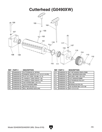

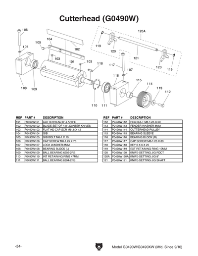

CUTTERHEAD 8" 4-KNIFE
$97.75
101A
*DISCD*CUTTERHEAD 8" ASSEMBLY
Now: H4982
8" x 3/4" x 1/8" HSS Jointer Knives, Set of 4
FLAT HD CAP SCR M5-.8 X 12
*DISCD*GIB
$1.75
*DISCD*GIB BOLT M6-1 X 10
$1.49
106
CAP SCREW M8-1.25 X 70
107
LOCK WASHER 8MM
108
*DISCD*BEARING BLOCK (L)
109
BALL BEARING 6203-2RS
110
Now: PR25M
INT RETAINING RING 47MM
111
BALL BEARING 6204-2RS
112
Now: PB09M
HEX BOLT M8-1.25 X 20
113
FENDER WASHER 8MM
114
*DISCD*CUTTERHEAD PULLEY
115
*DISCD*BEARING SLEEVE
$2.30
116
*DISCD*BEARING BLOCK (R)
117
118
KEY 6 X 6 X 25
119
Now: PR01M
EXT RETAINING RING 10MM
120
*DISCD*KNIFE-SETTING JIG FOOT
120A
121
*DISCD*KNIFE-SETTING JIG SHAFT

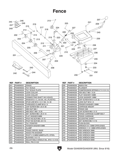

200
*DISCD*COMPLETE FENCE ASSY
$293.25
201
*DISCD*FENCE
$114.75
202
*DISCD*TILT SCALE W/PLATE
$1.49
203
204
*DISCD*LOCK COLLAR
$4.05
205
*DISCD*LOCK COLLAR
$3.45
206
*DISCD*CONNECTING SHAFT W/2 HOLES
$7.20
207
*DISCD*KNOB M10-1.5, 35 DIA, 44L PLASTIC
208
*DISCD*STUD UDE M10-1.5 X 100, 12, 30
209
*DISCD*THREADED CLAMP M10-1.5
$1.49
210
CAP SCREW M8-1.25 X 30
211
Now: PN01M
HEX NUT M6-1
212
Now: PB10M
HEX BOLT M6-1 X 25
213
214
Now: PW03M
FLAT WASHER 6MM
215
Now: PS68M
PHLP HD SCR M6-1 X 10
216
Now: PS09M
217
*DISCD*TILT POINTER
$1.49
218
FENDER WASHER 5MM
219
*DISCD*CLAMP
$1.49
220
*DISCD*FENCE SWIVEL BASE
$26.75
221
*DISCD*INDEX PIN WASHER
$1.49
222
223
*DISCD*BUSHING 14 X 15
$1.75
224
*DISCD*ADJUSTABLE HANDLE 94L, M10-1.5X50
225
ROLL PIN 3 X 20
226
*DISCD*INDEX PIN
$4.35
227
*DISCD*PLUNGER
$5.50
228
*DISCD*COMPRESSION SPRING 0.7 X 12 X 15
$1.49
229
Now: PB08M
HEX BOLT M6-1 X 20
230
Now: PW04M
FLAT WASHER 10MM
231
LOCK WASHER 10MM
232
233
LOCK NUT M10-1.5
234
FENDER WASHER 10MM
235
*DISCD*CARRIAGE MOUNT
$42.55
236
*DISCD*FENCE GIB
$5.50
237
CAP SCREW M6-1 X 12
238
*DISCD*FENCE CARRIAGE CLAMP BOLT
$4.35
239
$45.75
240
*DISCD*ECCENTRIC SHAFT
$7.50
241
SET SCREW M6-1 X 16
242
*DISCD*PUSH BLOCK
243
WRENCH 8 X 10MM OPEN-ENDS
244
WRENCH 11 X 13MM OPEN-ENDS
245
HEX WRENCH 3MM
246
HEX WRENCH 4MM
247
HEX WRENCH 5MM
248
HEX WRENCH 6MM
249
HEX WRENCH 8MM

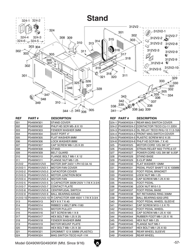

*DISCD*STAND COVER
$14.95
302
Now: PS09M
303
FENDER WASHER 5MM
304
*DISCD*DUST PORT 4"
305
Now: PW01M
FLAT WASHER 8MM
306
LOCK WASHER 8MM
307
308
*DISCD*STAND
309
*DISCD*BELT GUARD
310
FLANGE BOLT M6-1 X 12
311
FLANGE NUT M8-1.25
312
*DISCD*MOTOR 3HP 240V 1-PH V1
312-1
*DISCD*MOTOR FAN COVER
312-10
*DISCD*R CAPACITOR 40M 450V 2 X 3-3/4
312-2
*DISCD*CAPACITOR COVER
312-3
*DISCD*MOTOR JUNCTION BOX
312-4
*DISCD*MOTOR FAN
312-5
*DISCD*S CAPACITOR 300M 250V 2 X 3-3/4
312-7
*DISCD*CONTACTOR
312-8
*DISCD*CENTRIFUGAL SWITCH
312-9
BALL BEARING 6205ZZ
312V2
*DISCD*MOTOR 3HP 240V 1-PH V2.04.16
312V2-1
312V2-10
*DISCD*R CAPACITOR 40M 450V 1-7/8 X 3-3/4
312V2-2
312V2-3
312V2-4
*DISCD*MOTOR FAN
312V2-5
*DISCD*S CAPACITOR 300M 250V 1-7/8 X 3-3
312V2-7
*DISCD*CONTACT PLATE
312V2-8
313
Now: PK55M
KEY 7 X 7 X 40
314
*DISCD*RIBBED V-BELT 8PK-1180
$15.25
315
*DISCD*MOTOR PULLEY
$19.30
316
SET SCREW M6-1 X 8
317
Now: PB07M
HEX BOLT M8-1.25 X 25
318
FENDER WASHER 8MM
319
*DISCD*MOTOR MOUNT PLATE
$5.50
320
Now: PB26M
HEX BOLT M8-1.25 X 30
321
*DISCD*GROMMET 12 X 50MM (PLASTIC)
324
*DISCD*MAG SWITCH TECO HUF-11K
$79.65
324-1
*DISCD*REAR MAG SWITCH COVER
324-2
*DISCD*CONTACTOR TECO CU-11 220V
324-3
*DISCD*OL RELAY TECO RHU-10 11.3-16A
324-4
*DISCD*FRONT MAG SWITCH COVER
324-5
*DISCD*PLASTIC SCREW M12 X 25
324-6
Now: PS65M
PHLP HD SCR M4-.7 X 40
325
*DISCD*MOTOR CORD 12G 3W 37"
326
*DISCD*STRAIN RELIEF M22 TYPE-6 ST
327
*DISCD*POWER CORD 12G 3W 98" 6-20P
328
*DISCD*STAND BASE
$125.35
329
E-CLIP 9MM
330
Now: PW06M
FLAT WASHER 12MM
331
*DISCD*FOOT PEDAL ASSY
332
333
LOCK NUT M8-1.25
334
CAP SCREW M8-1.25 X 50
335
335A
$58.65
336
LOCK NUT M10-1.5
337
338
Now: PR21M
INT RETAINING RING 35MM
339
BALL BEARING 6202-2RS
340
341
CAP SCREW M10-1.5 X 70
342
343
CAP SCREW M8-1.25 X 100
344
*DISCD*RUBBER FOOT M8-1.25 X 16
345
Now: PN03M
HEX NUT M8-1.25
346
FLANGE NUT M6-1
347
Now: PB22M
HEX BOLT M8-1.25 X 50
348
*DISCD*REAR WHEEL SLEEVE
$2.30
349
*DISCD*REAR WHEEL
$6.65

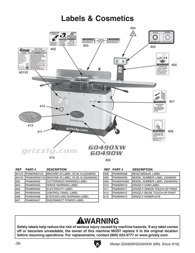

401
*DISCD*MACHINE ID LABEL V1
401V2
MACHINE ID LABEL W/TUV V2.09.16
$16.40
402
*DISCD*CUTTERHEAD WARNING LABEL
$1.75
403
*DISCD*FENCE WARNING LABEL
404
ELECTRICITY 1.4W X 1.2H
405
*DISCD*CONTROL PANEL LABEL
406
EYE/EAR/LUNG 2W X 3.3H
407
DISCONNECT 110V 2W X 3.3H
408
409
*DISCD*MODEL NUMBER LABEL
410
*DISCD*GRIZZLY.COM LABEL
411
N/S GRIZZLY GREEN G1023S
412
BEIGE REF G0555
413
Now: G8588
Nameplate - Small
