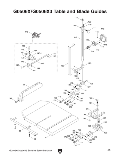

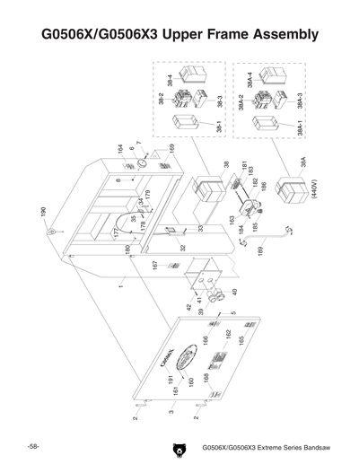

FRAME
HINGE
WHEEL GUARD UPPER
WHEEL GUARD LOWER
CAP SCREW 1/4-20 X 3/8
WHEEL GUARD LOCK KNOB
CAP SCREW 1/4-20 X 3/4
Now: PN05
HEX NUT 1/4-20

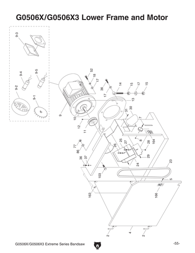

MOTOR 3HP 220V 3-PH
$326.95
9-1
MOTOR FAN
9-2
FAN COVER
9-3
JUNCTION BOX
9-4
S CAPACITOR 400M 125V 1-3/4 X 3-7/16
9-5
R CAPACITOR 30M 300V 1-9/16 X 2-3/8
Now: PK43M
KEY 8 X 8 X 45
MOTOR PULLEY
Now: PSS08
SET SCREW 5/16-18 X 1/2
MOTOR FLANGE
MOTOR FLANGE BOLT 3/8-16 X 1-1/4
Now: PN08
HEX NUT 3/8-16
Now: PW02
FLAT WASHER 3/8
Now: PLW04
LOCK WASHER 3/8
Now: PVA37
V-BELT A37
DUST BOARD
WOOD BOARD
Now: PB07
HEX BOLT 5/16-18 X 3/4
Now: PW07
FLAT WASHER 5/16
Now: PN02
HEX NUT 5/16-18
Now: PS06
PHLP HD SCR 10-24 X 3/8
CHIP CHUTE
Now: PS06
BLADE TENSION INDICATOR W/CABLE & SCREW
CAP SCREW 10-24 X 1/2
WIRE BRACKET
Now: PS06
Now: PB58
HEX BOLT 3/8-16 X 2
Now: PN08
HEX NUT 3/8-16
MAG SWITCH 3HP 3PH 9A
38-1
MAG SWITCH BACK COVER
38-2
CONTACTOR 220V 60HZ 3PH SHIHLIN
38-3
THERMAL OVERLOAD RELAY 220V 3HP 60HZ
38-4
MAG SWITCH FRONT COVER
38A
MAG SWITCH 440V-5A MPE-18
38A-1
38A-2
38A-3
THERMAL OVERLOAD RELAY SHIHL 220V 1PH 60
38A-4
*DISCD*ON SWITCH GREEN
*DISCD*OFF SWITCH RED
POWER CONTROL PANEL
Now: PS06
CONNECTION PLATE
BRAKE LINING
45
Now: PB18
HEX BOLT 3/8-16 X 1
46
Now: PB19
HEX BOLT 1/4-20 X 1/2
FOOT BRAKE PEDAL
48
Now: PLW04
LOCK WASHER 3/8
49
Now: PN08
HEX NUT 3/8-16
50
SPRING HELICAL 110MM
51
Now: PN08
HEX NUT 3/8-16
52
Now: PB18
HEX BOLT 3/8-16 X 1
53
*DISCD*STOP SWITCH
54
CAP SCREW M4-.7 X 35
55

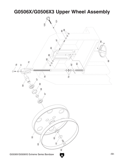

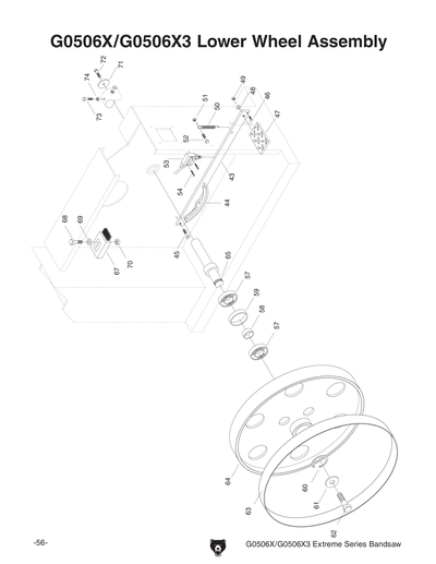

WHEEL UPPER
56
WHEEL SHAFT UPPER
57
BALL BEARING 6205ZZ
58
*DISCD*IN BUSHING
59
*DISCD*OUT BUSHING
60
Now: PR26M
INT RETAINING RING 52MM
61
LOWER WHEEL FLAT WASHER 10MM
62
Now: PB07
63
*DISCD*RUBBER CROWN
64
*DISCD*WHEEL LOWER
65
WHEEL SHAFT LOWER
66
BRUSH BRACKET
67
BRUSH
68
Now: PB03
HEX BOLT 5/16-18 X 1
69
Now: PW07
FLAT WASHER 5/16
70
Now: PN02
HEX NUT 5/16-18
71
LOWER WHEEL SHAFT WASHER 3/8-2"
72
Now: PB21
HEX BOLT 3/8-16 X 3/4
73
Now: PB24
HEX BOLT 3/8-16 X 1-1/4
74
Now: PN08
HEX NUT 3/8-16
75
ARBOR BRACKET
76
Now: PB42
HEX BOLT 1/2-12 X 2
77
Now: PN06
HEX NUT 1/2-12
78
BLADE TENSION SHAFT
79
THRUST BEARING 51104
82
INDICATOR WIRE PULLER
83
SPRING HELICAL 50MM
84
BRACKET HOLDER
85
Now: PN06
HEX NUT 1/2-12
86
Now: PW01
FLAT WASHER 1/2
87
BRACKET SHAFT
88
Now: PN06
HEX NUT 1/2-12
89
TENSION HANDWHEEL
90
Now: PSS05
SET SCREW 5/16-18 X 1/4

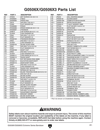

91
*DISCD*TABLE
92
*DISCD*FENCE RAIL
93
Now: PB18
HEX BOLT 3/8-16 X 1
94
Now: PW02
FLAT WASHER 3/8
95
*DISCD*FENCE
96
*DISCD*FENCE KNOB 3/8"-16 X 1-1/4"
97
*DISCD*TRUNNION W/BRACKET
98
CAP SCREW 3/8-16 X 1-1/4
99
Now: PLW04
LOCK WASHER 3/8
100
Now: PB42
HEX BOLT 1/2-12 X 2
Now: PW01
FLAT WASHER 1/2
TRUNNION BRACKET
Now: PB53
HEX BOLT 1/2-12 X 1
Now: PLW07
LOCK WASHER 1/2
BLADE GUIDE FORK
106
Now: PB07
107
Now: PW07
FLAT WASHER 5/16
108
*DISCD*SHAFT CUP
109
Now: PB03
110
Now: PLW01
LOCK WASHER 5/16
111
*DISCD*LOCK KNOB 3/8-16 X 2-1/4"
112
GUIDE SHAFT
113
Now: PR19M
EXT RETAINING RING 28MM
114
ELEVATION GEAR SHAFT
115
*DISCD*GEAR SHAFT BASE
116
Now: PB07
117
Now: PLW01
LOCK WASHER 5/16
118
*DISCD*HANDWHEEL
119
*DISCD*SPRING KEY M4 X 40
120
*DISCD*TRACK KNOB 1/2 - 12 X 2-1/2
121
Now: PN08
HEX NUT 3/8-16
122
BLADE GUIDE GUARD
123
BLADE GUARD BRACKET
124
Now: PB19
125
Now: PLW02
LOCK WASHER 1/4
126
Now: PW06
FLAT WASHER 1/4
127
*DISCD*BLADE GUIDE HOLDER
128
Now: PB03
129
Now: PW07
FLAT WASHER 5/16
130
Now: PB07
131
*DISCD*ADJUSTMENT BRACKET
132
*DISCD*BRACKET ARBOR
133
BLADE GUIDE BASE
136
*DISCD*GUIDE BEARING SHAFT
138
BALL BEARING 6202ZZ
139
*DISCD*SLIDING BASE
140
*DISCD*COMPLETE MITER GAUGE
140-1
MITER GAUGE BODY
141
T-SLOT WASHER 13MM
142
Now: PFH03
FLAT HD SCR 1/4-20 X 1/2
143
MITER BAR
144
MITER GAUGE BOLT 1/4-20 X 5/8
145
STOP PIN
146
BLOCK
147
*DISCD*INDICATOR
148
Now: PS29
PHLP HD SCR 6-32 X 5/8
149
Now: PS06
150
HANDLE 5/16-18 X 1-1/2
151
Now: PW07
FLAT WASHER 5/16
152
Now: PN12
HEX NUT 6-32
160
Now: G8589
Nameplate - Large
161
TAP SCREW M4 X 11
162
MACHINE ID LABEL
163
ELECTRICITY 1.4W X 1.2H
164
UNPLUG BANDSAW 2W X 3.3H
165
***USE PLABEL-19A***
166
DONT OPEN 2W X 3.3H
167
168
169
BS MOVING/ADJUST 2W X 3.3H
174
*DISCD*THRUST BEARING SHAFT
175
BALL BEARING 6202RS
176
E-CLIP 15MM
177
CABLE CLIP
178
CABLE NUT 6-32
179
Now: PS37
PHLP HD SCR 6-32 X 5/16
180
Now: PS06
181
TERMINAL BLOCK
182
TERMINAL BLOCK
183
Now: PN07
HEX NUT 10-24
184
Now: PW03
FLAT WASHER #10
185
STRAIN RELIEF PG16 TYPE-6 ST
186
TERMINAL BLOCK
188
TAP SCREW 10-24 X 1/2
189
MOTOR POWER CORD
190
LIFTING RING 10MM
191
MODEL NUMBER LABEL
MAN
