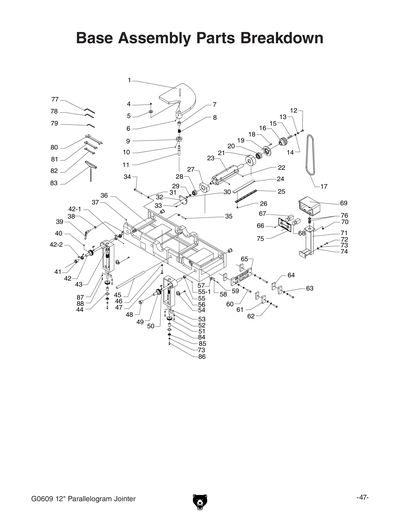

CUTTERHEAD GUARD
$96.35
FLAT HD SCR M8-1.25 X 16
CUTTERHEAD GUARD FLAT WASHER
$1.90
SET SCREW M6-1 X 12
ADAPTER
$1.90
TORSION SPRING
$1.90
SHAFT COLLAR
$6.90
SET SCREW M6-1 X 12
SHAFT
$3.25
CUTTERHEAD PULLEY SCREW
$1.90
LOCK WASHER 10MM
Now: PW04M
FLAT WASHER 10MM
Now: PK111
KEY 8 X 8 X 60
CAST IRON CUTTERHEAD PULLEY V1.01.09
$11.90
16V2
ALUMINUM CUTTERHEAD PULLEY V2.03.09
$21.60
Now: PVA54
V-BELT A54
17V2
RIBBED V-BELT 8PK-1371 V2.03.09
$21.60
CAP SCREW M6-1 X 20
BEARING COVER
$11.25
BALL BEARING 6206ZZ
BEARING SUPPORT
$39.95
FLAT HD SCR M5-.8 X 12
CUTTERHEAD 12" 4-KNIFE
$204.50
Now: H9246
12" x 1-1/8" x 1/8" HSS Jointer Knives for G0609, Set of 4
KNIFE BAR GIB
$6.50
KNIFE LOCK/GIB SCREW
$1.90
BEARING SUPPORT
$33.45
BALL BEARING 6204-2RS
Now: PW01M
FLAT WASHER 8MM
CUTTERHEAD SCREW
$1.90
Now: PN02M
HEX NUT M10-1.5
BEARING COVER
$12.95
CAP SCREW M6-1 X 20
HEX BOLT M10-1.5 X 150
SET SCREW M10-1.5 X 60
BASE
SET SCREW M6-1 X 12
Now: PW04M
FLAT WASHER 10MM
LOCK HANDLE
$10.45
SET SCREW M6-1 X 8
ECCENTRIC BUSHING
$3.65
SHAFT
42-1
LEFT TORSION SPRING
42-2
RIGHT TORSION SPRING
STOP BLOCK
Now: PR21M
INT RETAINING RING 35MM
45
SHAFT
$11.25
46
LOCK WASHER 10MM
Now: PB32M
HEX BOLT M10-1.5 X 25
48
BUSHING
$3.65
49
WORM GEAR
$15.15
50
Now: PK12M
KEY 5 X 5 X 30
51
GEAR
$15.15
52
WORM
$25.60
53
Now: PK37M
KEY 4 X 4 X 16
54
SLIDE STOP BLOCK
55
SLIDE STOP BLOCK
55-1
SET SCREW M8-1.25 X 10
56
BASE FLAT SCREW
57
POINTER
$1.90
58
Now: PW02M
FLAT WASHER 5MM
59
Now: PS09M
PHLP HD SCR M5-.8 X 10
60
Now: PB73M
HEX BOLT M10-1.5 X 50
61
CLAMP BLOCK
$3.20
62
LOCK WASHER 10MM
63
Now: PW04M
FLAT WASHER 10MM
64
CLAMPING BLOCK (OUTER)
65
CLAMP PLATE
$83.75
66
TAP SCREW M4 X 8
67
*DISCD*STOP BUTTON 1 ARROW V1
67V2
E-STOP BUTTON NHD NLB22-R 22MM V2.01.11
68
*DISCD*START BUTTON SOLID V1
68V2
START BUTTON CLEAR V2.01.11
69
SWITCH BOX
$19.10
70
FLANGE SCREW M6-1 X 16
71
SWITCH BOX BRACKET
$21.60
72
Now: PB32M
73
LOCK WASHER 10MM
74
Now: PW04M
FLAT WASHER 10MM
75
CONTROL PANEL PLATE
$9.40
76
STRAIN RELIEF M20 TYPE-6 ST
77
HEX WRENCH 10MM
78
HEX WRENCH 8MM
79
HEX WRENCH 3MM
80
WRENCH 17 X 19MM OPEN-ENDS
81
WRENCH 12 X 14MM OPEN-ENDS
82
WRENCH 10 X 12MM OPEN-ENDS
83
T-HANDLE WRENCH 4MM
$7.80
84
BUSHING
85
BALL BEARING 6202ZZ
86
Now: PB06M
HEX BOLT M8-1.25 X 12
87
Now: PW03M
FLAT WASHER 6MM
88
Now: PB02M
HEX BOLT M6-1 X 12

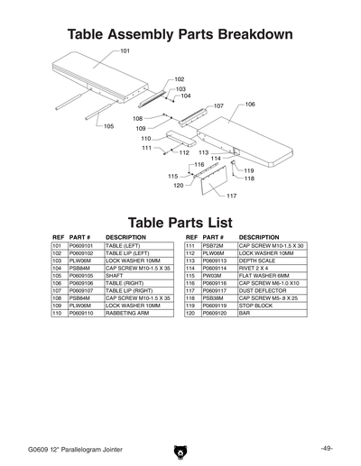

LEFT TABLE
$403.10
LEFT TABLE LIP
$25.20
LOCK WASHER 10MM
CAP SCREW M10-1.5 X 35
SHAFT
106
RIGHT TABLE
$512.90
107
RIGHT TABLE LIP
$26.25
108
109
LOCK WASHER 10MM
110
RABBETING ARM
111
CAP SCREW M10-1.5 X 30
112
LOCK WASHER 10MM
113
DEPTH SCALE
$1.90
114
RIVET 2 X 4MM NAMEPLATE, STEEL
115
Now: PW03M
FLAT WASHER 6MM
116
CAP SCREW M6-1 X 10
117
DUST DEFLECTOR
118
CAP SCREW M5-.8 X 25
119
STOP BLOCK
$4.35
120

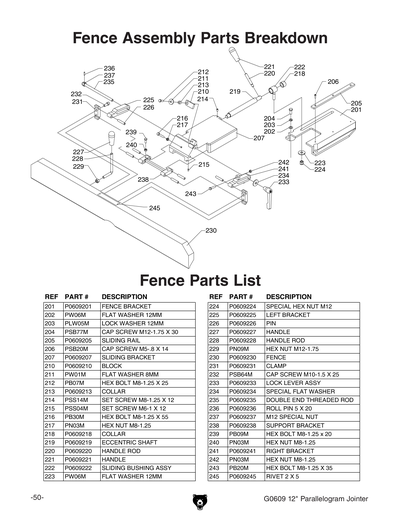

BAR
201
FENCE BRACKET
$33.45
202
Now: PW06M
FLAT WASHER 12MM
203
LOCK WASHER 12MM
204
CAP SCREW M12-1.75 X 30
205
SLIDING RAIL
$9.00
206
CAP SCREW M5-.8 X 14
207
SLIDING BRACKET
$35.95
210
BLOCK
$4.70
211
Now: PW01M
FLAT WASHER 8MM
212
Now: PB07M
HEX BOLT M8-1.25 X 25
213
COLLAR
$5.10
214
SET SCREW M8-1.25 X 12
215
SET SCREW M6-1 X 12
216
Now: PB30M
HEX BOLT M8-1.25 X 55
217
Now: PN03M
HEX NUT M8-1.25
218
COLLAR
$1.90
219
ECCENTRIC SHAFT
$16.20
220
HANDLE ROD
$1.90
221
HANDLE
$1.90
222
SLIDING BUSHING ASSY
$2.90
223
Now: PW06M
FLAT WASHER 12MM
224
FENCE BRACKET HEX NUT M12-1.75
$1.90
225
LEFT BRACKET
$4.35
226
$6.50
227
HANDLE
$1.90
228
HANDLE ROD
$2.90
229
Now: PN09M
HEX NUT M12-1.75
230
FENCE
$286.10
231
CLAMP
$20.15
232
CAP SCREW M10-1.5 X 25
233
LOCK LEVER ASSY
$7.95
234
LOCK LEVER FLAT WASHER 13 X 35 X 3
$1.90
235
DOUBLE END THREADED ROD
$6.15
236
ROLL PIN 5 X 20
237
ACORN NUT M12-1.75 PINNED
$1.90
238
SUPPORT BRACKET
$9.40
239
Now: PB09M
HEX BOLT M8-1.25 X 20
240
Now: PN03M
HEX NUT M8-1.25
241
RIGHT BRACKET
$4.35
242
Now: PN03M
HEX NUT M8-1.25
243
Now: PB20M
HEX BOLT M8-1.25 X 35
245

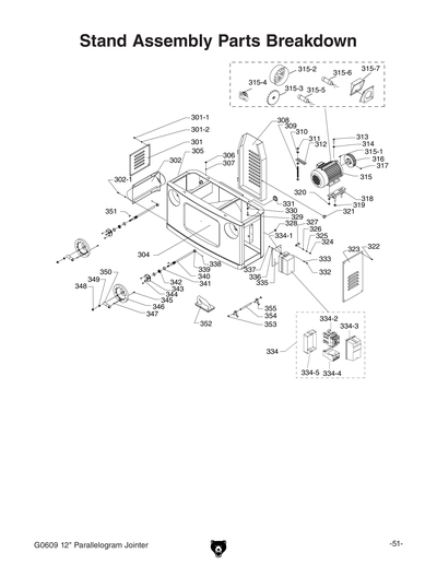

301
LEFT ACCESS DOOR
301-1
BUTTON HD CAP SCR M6-1 X 20
301-2
Now: PW03M
FLAT WASHER 6MM
302
DUST HOOD
$50.70
302-1
BUTTON HD CAP SCR M6-1 X 10
304
TAP SCREW M4 X 8
305
CABINET
306
RUBBER WASHER 8MM
307
SET SCREW M8-1.25 X 15
308
PULLEY COVER
$47.45
309
TENSION ROD
$2.20
310
Now: PW06M
FLAT WASHER 12MM
311
Now: PN09M
HEX NUT M12-1.75
312
TENSION PLATE
$9.50
313
HEX BOLT M10-1.5 X 45
314
Now: PW04M
FLAT WASHER 10MM
315

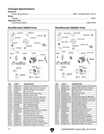

MOTOR 3HP 1PH 240V 60HZ V1.06.06
$420.50
315-1
Now: PK33M
KEY 5 X 5 X 45
315-2
MOTOR FAN COVER V1.06.06
315-3
MOTOR FAN V1.06.06
$3.25
315-4
CENTRIFUGAL SWITCH V1.06.06
315-5
S CAPACITOR 200M 250V 1-9/16 X 3-9/16
315-6
R CAPACITOR 20M 450V 1-9/16 X 2-3/4
$8.65
315-7
JUNCTION BOX V1.06.06

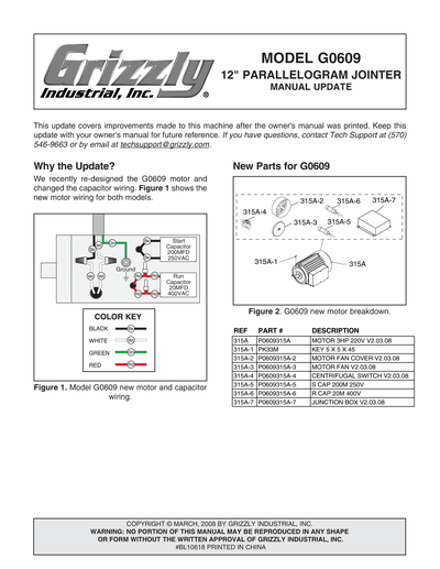

315A
MOTOR 3HP 240V 1-PH V2.03.08
315A-1
Now: PK33M
KEY 5 X 5 X 45
315A-10
CONTACT PLT-TUNGSTEN 5HP OR LESS
315A-2
MOTOR FAN COVER V2.03.08
315A-3
MOTOR FAN V2.03.08
315A-4
CENT SWITCH 5/8-3450
315A-5
315A-6
R CAPACITOR 20M 400V V2.03.08
315A-7
JUNCTION BOX V2.03.08
315A-8
BALL BEARING 6205ZZ
315A-9
BALL BEARING 6203ZZ
316
CAST IRON MOTOR PULLEY V1.01.09
$47.45
316V2
ALUMINUM MOTOR PULLEY V2.03.09
$33.10
317
SET SCREW M10-1.5 X 16
318
MOTOR BRACKET
$10.10
319
Now: PN09M
HEX NUT M12-1.75
320
Now: PN02M
HEX NUT M10-1.5
321
PULLEY COVER LOCK KNOB
322
323
RIGHT ACCESS DOOR
$19.85
324
LATCH HEX NUT M6-1
325
Now: PW03M
FLAT WASHER 6MM
326
ADAPTOR
327
LATCH
328
SMALL PANEL GASKET
329
CAP SCREW M10-1.25 X 25
330
LOCK WASHER 10MM
331
CONTROL PANEL CORD GASKET
332
CAP SCREW M6-1 X 10
333
Now: PW03M
FLAT WASHER 6MM
334
*DISCD*MAGNETIC SWITCH V1
334-1
Now: PS06M
PHLP HD SCR M5-.8 X 20
334-2
CONTACTOR 12D 230V
$133.70
334-3
MAG SWITCH COVER ASSEMBLY
$25.90
334-4
OL RELAY NHD NTH-17 14-17A
$41.40
334-5
334V2
MAGNETIC SWITCH V2.01.11
$154.95
335
SWITCH PLATE
335A
KNIFE SETTING JIG ASSEMBLY
336
Now: PW02M
FLAT WASHER 5MM
337
Now: PN06M
HEX NUT M5-.8
338
SET SCREW M6-1 X 8
339
COLLAR
$6.15
340
SPIRAL GEAR SHAFT
$22.35
341
Now: PR29M
INT RETAINING RING 32MM
342
BALL BEARING 6206ZZ
343
BEARING SUPPORT
344
FLAT HD SCR M6-1 X 8
345
346
HANDWHEEL
$23.40
347
ROLL PIN 4 X 10
348

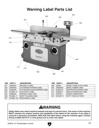

401
MACHINE ID LABEL NO CSA V1
$16.40
401V2
MACHINE ID LABEL CSA V2.08.12
402
CUTTERHEAD WARNING LABEL
403
CUTTERHEAD GUARD LABEL 4.1W X 2.2H
404
ELECTRICITY 1.4W X 1.2H
405
CONTROL PANEL PLATE
406
407
408
Now: G8589
Nameplate - Large
409
MODEL NUMBER LABEL
$16.50
410
EAR PROTECTION/RESPIRATOR 2W X 3.3H
411
DISCONNECT 220V 2W X 3.3H
412
N/S GRIZZLY GREEN G1023S
413
GREY PUTTY REF G0504
414
HANDWHEEL UP/DOWN LABEL
$1.25
