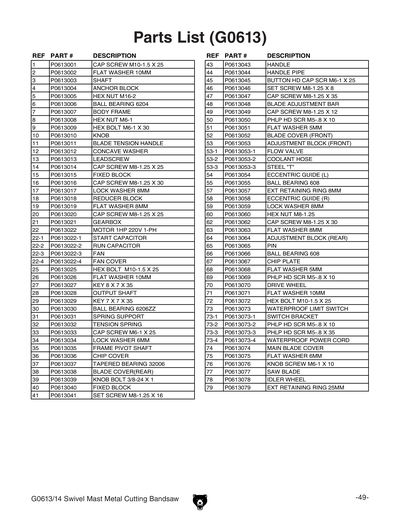

Parts for G0613 7" x 8-1/4" 1 HP Swivel Metal-Cutting Bandsaw
Parts Diagrams for G0613 - 7" x 8-1/4" 1 HP Swivel Metal-Cutting Bandsaw
Parts List for Parts for G0613 7" x 8-1/4" 1 HP Swivel Metal-Cutting Bandsaw

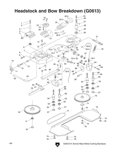

CAP SCREW M10-1.5 X 25
Now: PW04M
FLAT WASHER 10MM
SHAFT
$13.60
ANCHOR BLOCK V1
$40.80
4V2
ANCHOR BLOCK V2.02.24
$44.75
Now: PN13M
HEX NUT M16-2
BALL BEARING 6204ZZ
BODY FRAME
$383.75
Now: PN01M
HEX NUT M6-1
Now: PB29M
HEX BOLT M6-1 X 30
KNOB
$16.95
BLADE TENSION HANDLE
$50.15
BELLVILLE WASHER 10MM
$1.60
LEADSCREW
$8.20
CAP SCREW M8-1.25 X 25
FIXED BLOCK V1
$19.35
15V2
FIXED BLOCK V2.02.24
$21.00
CAP SCREW M8-1.25 X 30
LOCK WASHER 8MM
REDUCER BLOCK
$44.45
Now: PW01M
FLAT WASHER 8MM
GEARBOX
21-1
GEARBOX SEAL PLATE
$5.50
MOTOR 1PH 220V
$381.55
22-1
S CAPACITOR 300M 250V 1-1/2 X 2-3/4
22-2
R CAPACITOR 30M 250V 1-1/2 X 2-1/2
$15.35
22-3
FAN
22-4
FAN COVER
$11.85
Now: PB32M
HEX BOLT M10-1.5 X 25
Now: PW04M
FLAT WASHER 10MM
KEY 8 X 7 X 35
OUTPUT SHAFT
$32.65
KEY 7 X 7 X 35
BALL BEARING 6206ZZ
SPRING SUPPORT
$4.85
TENSION SPRING
$10.65
CAP SCREW M6-1 X 25
LOCK WASHER 6MM
FRAME PIVOT SHAFT
$34.80
CHIP COVER
$2.75
TAPERED ROLLER BEARING 30206
BLADE COVER REAR
$5.65
*DISCD*KNOB BOLT 3/8-24 X 1 V1
39V2
LOCK KNOB BOLT M10-1.5 X 15 V2.06.08
$5.50
*DISCD*FIXED BLOCK V1
40V2
BLADE GUIDE LOCK PLATE V2.06.08
$6.40
SET SCREW M8-1.25 X 16
HANDLE
HANDLE PIPE
45
BUTTON HD CAP SCR M6-1 X 20
46
SET SCREW M8-1.25 X 8
CAP SCREW M8-1.25 X 35
48
BLADE ADJUSTMENT BAR
$43.20
49
CAP SCREW M8-1.25 X 12
50
Now: PS09M
PHLP HD SCR M5-.8 X 10
51
Now: PW02M
FLAT WASHER 5MM
52
BLADE COVER FRONT
$6.20
53
ADJUSTMENT BLOCK FRONT
$43.25
53-1
FLOW VALVE 8MM V1
$25.70
53-1V2
FLOW VALVE 6MM V2.05.11
$25.70
53-2
*DISCD*COOLANT HOSE V1
53-2V2
COOLANT HOSE 6MM ID V2.05.11
53-3
STEEL T-CONNECTOR 8MM V1
$7.25
53-3V2
STEEL T-CONNECTOR 6MM V2.05.11
$7.25
54
ECCENTRIC GUIDE L
$3.70
55
Now: G3845
Bearing - 22mm x 8mm
57
Now: PR39M
EXT RETAINING RING 8MM
58
ECCENTRIC GUIDE R
$3.70
59
LOCK WASHER 8MM
60
Now: PN03M
HEX NUT M8-1.25
62
63
Now: PW01M
FLAT WASHER 8MM
64
ADJUSTMENT BLOCK REAR
$27.55
65
PIN
66
Now: P608Z
BALL BEARING 608Z
67
CHIP PLATE
$7.25
68
Now: PW02M
FLAT WASHER 5MM
69
Now: PS09M
70
DRIVE WHEEL
$83.60
71
Now: PW04M
FLAT WASHER 10MM
72
Now: PB32M
73
WATERPROOF LIMIT SWITCH
$38.10
73-1
SWITCH BRACKET
$6.05
73-2
Now: PS09M
73-3
Now: PS75M
PHLP HD SCR M5-.8 X 35
73-4
WATERPROOF POWER CORD
$14.25
74
MAIN BLADE COVER
$125.05
75
Now: PW03M
FLAT WASHER 6MM
76
KNOB SCREW M6-1 X 10
$1.49
77
SAW BLADE
$124.60
78
IDLER WHEEL
$82.15
79
Now: PR11M
EXT RETAINING RING 25MM

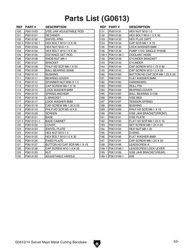

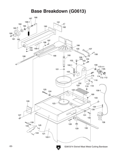

100
VISE JAW ADJUSTABLE ROD
$13.30
RETAINER
$2.20
SWIVEL ARM
$188.40
102-1
Now: PB14M
HEX BOLT M10-1.5 X 35
102-2
SWIVEL ARM SCALE
$1.60
102-3
RIVET
$1.60
Now: PN02M
HEX NUT M10-1.5
Now: PB01M
HEX BOLT M10-1.5 X 30
DISTANCE SET ROD
$11.45
106
KNOB NUT M6-1
$3.65
107
BRACKET
$12.30
108
Now: PS26M
PHLP HD SCR M6-1 X 20
109
BALL BEARING 32006
110
BUSHING
$10.65
111
BEARING COVER
$11.85
112
SPANNER NUT M30 X 1.5 W/O-RING
$13.15
113
CAP SCREW M6-1 X 16
114
LOCK WASHER 6MM
115
*DISCD*SPRING ANCHOR
$2.00
116
*DISCD*L-BRACKET
117
LOCK WASHER 8MM
118
119
Now: PS05M
PHLP HD SCR M5-.8 X 8
120
SCREEN
$8.50
121
BASE
$441.30
121-1
BASE CABINET
$205.60
122
COVER
$47.10
123
SWIVEL PLATE
$52.25
124
Now: PN02M
HEX NUT M10-1.5
125
Now: PB01M
126
FIXED PLATE
$6.05
127
BUTTON HD CAP SCR M6-1 X 16
128
CAP SCREW M10-1.5 X 35
129
$9.70
130
ADJUSTABLE HANDLE
131
Now: PN02M
HEX NUT M10-1.5
132
Now: PB01M
133
HEX PLUG 3/8PT
$2.20
134
CAP SCREW M6-1 X 16
135
LOCK WASHER 6MM
136
*SEE EXTENDED DESCRIPTION*
136-1
COOLANT HOSE V1
$7.80
136-1V2
COOLANT HOSE 8MM ID V2.05.11
$1.85
136-2
FLOW VALVE V1
$25.60
136-2V2
FLOW VALVE V2.07.07
$25.60
136-3V2
PUMP JUNCTION BOX V2.07.07
$11.20
136V2
PUMP 110V 1PH V2.07.07
$170.00
136V2-1
PIPE ELBOW MALE 3/8" X 8MM
$1.60
136V2-4
R CAPACITOR FJ SHGSR-V 3MFD 400V
$11.20
136V3
PUMP 110V 1PH V3.02.24
$161.85
136V3-1
136V3-2
FLOW VALVE V2.07.07
136V3-3
PUMP JUNCTION BOX
$10.20
136V3-4
R CAPACITOR 1M 350V
$2.60
136V3-5
136V3X
PUMP 220V 1PH V3.02.24
$169.90
136V3X-1
136V3X-2
FLOW VALVE V2.07.07
136V3X-3
PUMP JUNCTION BOX
136V3X-4
R CAPACITOR 1M 350V
136V3X-5
139
CYLINDER BRACKET
$8.50
143
CYLINDER
144
CAP SCREW M12-1.75 X 80
145
CAP SCREW M10-1.5 X 55
149
THRUST BEARING 51203
150
BLADE TENSION GAUGE
$87.90
180
BUTTON HD CAP SCR M8-1.25 X 20
181
Now: PW01M
FLAT WASHER 8MM
182
HANDWHEEL
$15.30
182-1
Now: H3207
Plastic Handle - 4" x 3/8"-16
183
Now: PSS17
SET SCREW 5/16-18 X 5/16
184
BEARING COVER
$6.45
185
THRUST BEARING 51106
186
VISE BED
$116.25
186-1
SCALE POINTER
$1.60
187
TENSION SPRING
$7.25
188
BUSHING
$7.05
189
Now: PS11M
PHLP HD SCR M6-1 X 16
190
VISE JAW BRACKET FRONT
$110.55
191
VISE PLATE
$24.80
192
FLAT HD SCR M8-1.25 X 16
193
SET SCREW M8-1.25 X 20
194
Now: PN03M
HEX NUT M8-1.25
195
196
Now: PW01M
FLAT WASHER 8MM
197
CAP SCREW M8-1.25 X 20
198
LEADSCREW A
$20.85
198-1
LEADSCREW LOCK LEVER
$15.45
199
VISE JAW BRACKET REAR
$192.95
199-1
$4.60

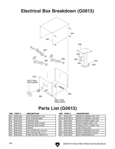

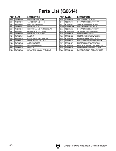

232
LOCK WASHER 6MM
233
CAP SCREW M6-1 X 35
234
Now: PW01M
FLAT WASHER 8MM
235
CONTROL BOX
$31.40
235A
CONTROL BOX ASSY
$336.00
235AV2
CONTROL BOX ASSY V2.06.08
$292.55
237
CONTROL BOX COVER
$25.85
238
*DISCD**CONTROL BOX STAND V1
238V2
CONTROL BOX STAND V2.06.08
$90.60
242
HANDLE
$1.85
243
244
Now: PS14M
PHLP HD SCR M6-1 X 12
255
PUMP ROTARY SWITCH
$20.55
257
E-STOP BUTTON W/ON-OFF KEDU KJD12/120V
$27.20
257A
ON/OFF EMERGENCY SWITCH 220V
$28.45
258
MOTOR POWER CORD 110V
$10.90
259
PUMP POWER CORD 110V
$10.90
260
POWER SUPPLY CORD 110V
$10.90
262
JUNCTION BLOCK
$11.85
263
CIRCUIT BREAKER 15A 110V
$7.25
263A
CIRCUIT BREAKER 7A 220V 1P
$240.75
264
220V CONVERSION KIT V1
$36.25
264V2
220V CONVERSION KIT V2.02.24
$72.45

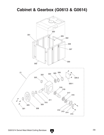

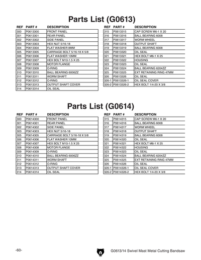

300
PANEL FRONT
$138.90
301
PANEL REAR
$138.90
302
SIDE PANEL
$132.85
303
Now: PN02
HEX NUT 5/16-18
304
Now: PW01M
FLAT WASHER 8MM
305
Now: PCB01
CARRIAGE BOLT 5/16-18 X 5/8
306
Now: PW04M
FLAT WASHER 10MM
307
Now: PB32M
308
MOTOR FLANGE
$50.50
309
O-RING
$3.05
310
BALL BEARING 6006ZZ
311
WORM SHAFT
$65.25
312
O-RING
$3.05
313
*DISCD*OUTPUT SHAFT COVER
314
OIL SEAL
$3.95
315
CAP SCREW M6-1 X 20
316
BALL BEARING 6008ZZ
317
WORM GEAR 30T
$114.45
318
OUTPUT SHAFT
$45.65
319
BALL BEARING 6008ZZ
320
OIL SEAL
$6.70
321
Now: PB10M
HEX BOLT M6-1 X 25
322
HOUSING
$413.00
322A
COMPLETE GEAR BOX ASSY
$498.15
323
OIL SEAL
$6.70
324
BALL BEARING 6204ZZ
325
Now: PR79M
INT RETAINING RING 19MM
326
OIL SEAL
$6.70
326-1
OIL SEAL COVER
$4.30
326-2
Now: PB51
HEX BOLT 1/4-20 X 3/8
330
***USE P0614021***

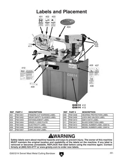

401
FINGERS CUT WARNING LABEL
$4.25
402
403
ENTANGLEMENT LABEL
$4.25
404
GRIZZLY LOGO PLATE
$7.00
405
ELECTRICITY 1.4W X 1.2H
406
407
DISCONNECT POWER-DOOR 2W X 3.3H
408
EAR PROTECTION 2W X 3.3H V2.04.08
409
LOCK & UNLOCK LABEL
$1.49
410
DATA LABEL
$1.05
411
BLADE DIRECTION LABEL
$1.60
412
MODEL NUMBER LABEL
$16.40
BOX2
COMPLETE BOX 2 OF 2 FOR G0613
$419.65
MAN
MANUAL FOR G0613 11/06
$13.50
