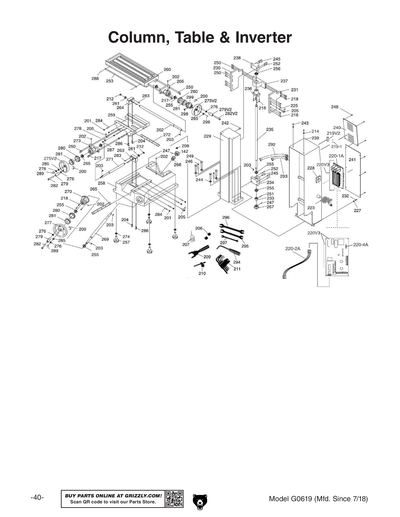

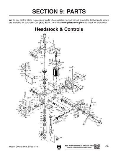

Parts Diagrams for G0619 - 6" x 21" 1 HP Mill / Drill

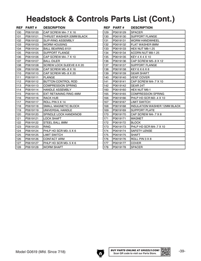

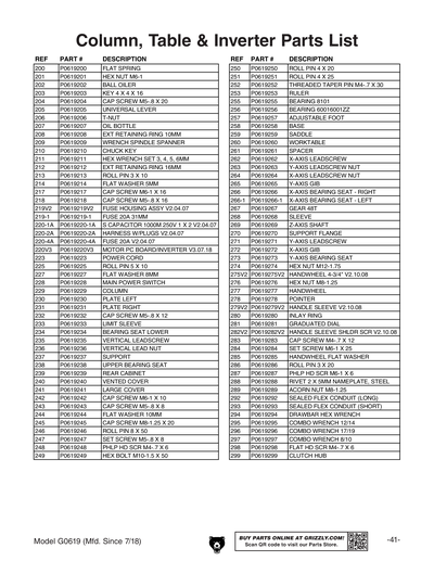

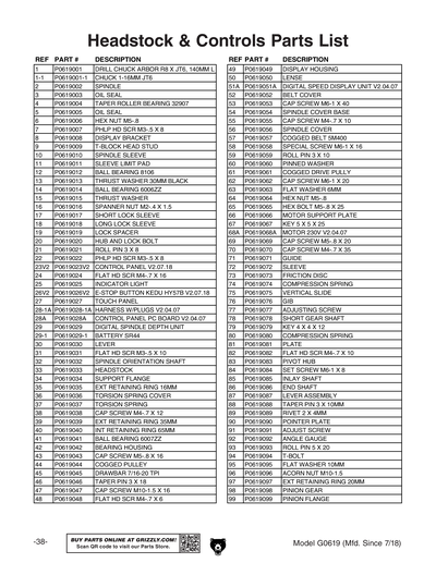

Parts List for Parts for G0619 6" x 21" 1 HP Mill / Drill
DRILL CHUCK ARBOR R8 X JT6, 140MM L
$11.40
1-1
CHUCK 1-16MM JT6
$24.15
SPINDLE
$182.25
2-1
SPINDLE SET SCREW DRIVE PIN
$2.20
OIL SEAL
$4.70
TAPERED ROLLER BEARING 32907
$231.75
OIL SEAL
$2.90
Now: PN06M
HEX NUT M5-.8
Now: PS79M
PHLP HD SCR M3-.5 X 8
DISPLAY BRACKET
$2.60
T-BLOCK HEAD STUD
$2.60
SPINDLE SLEEVE
$70.85
SLEEVE LIMIT PAD
$15.70
Now: P8106
THRUST BEARING 8106
THRUST WASHER 30MM BLACK
$2.90
BALL BEARING 6006ZZ
THRUST WASHER
$4.60
SPANNER NUT M2-.4 X 1.5
$1.90
SHORT LOCK SLEEVE
LOCK SLEEVE LONG
LOCK SPACER
HUB & LOCK BOLT
ROLL PIN 3 X 8
Now: PS79M
CONTROL PANEL V1
$4.60
23V2
CONTROL PANEL V2.07.18
FLAT HD SCR M4-.7 X 16
POWER INDICATOR LIGHT ZD-10 GRN
E-STOP BUTTON ONPOW LAS1-A
26V2
E-STOP BUTTON KEDU HY57B V2.07.18
$34.20
CONTROL PANEL LABEL
$5.00
*DISCD*CONTROL PANEL PC BOARD V1.01.07
28-1A
HARNESS W/PLUGS V2.04.07
$10.45
28A
CONTROL PANEL PC BOARD V2.04.07
$101.50
DIGITAL SPINDLE DEPTH UNIT
$97.70
LEVER
$1.90
FLAT HD SCR M6-1 X 50
SPINDLE ORIENTATION SHAFT
HEADSTOCK
33A
COMPLETE HEADSTOCK ASSY. W/ MOTOR
$2,528.30
SUPPORT FLANGE
Now: PR06M
EXT RETAINING RING 16MM
TORSION SPRING COVER
$6.15
TORSION SPRING
$2.90
CAP SCREW M4-.7 X 12
Now: PR12M
EXT RETAINING RING 35MM
Now: PR63M
INT RETAINING RING 65MM
BALL BEARING 6007ZZ
BEARING HOUSING
$12.25
CAP SCREW M5-.8 X 16
COGGED PULLEY
$75.85
45
DRAWBAR 7/16-20 TPI
$7.20
45-1
DRAWBAR HEX WRENCH
46
TAPER PIN 3 X 18
$1.90
CAP SCREW M10-1.5 X 16
48
FLAT HD SCR M4-.7 X 6
49
DISPLAY HOUSING
$5.10
50
LENSE
$1.90
51A
DIGITAL SPEED DISPLAY UNIT V2.04.07
$37.10
52
BELT COVER
$30.50
53
CAP SCREW M6-1 X 40
54
SPINDLE COVER BASE
55
CAP SCREW M4-.7 X 10
56
SPINDLE COVER
$6.15
57
COGGED BELT 5M400
$10.45
58
PULLEY SCREW M6-1 X 16
$1.90
59
ROLL PIN 3 X 10
60
PINNED WASHER
$1.90
61
COGGED DRIVE PULLY
$19.10
62
CAP SCREW M6-1 X 20
63
Now: PW03M
FLAT WASHER 6MM
64
Now: PN06M
HEX NUT M5-.8
65
Now: PB94M
HEX BOLT M5-.8 X 25
66
MOTOR SUPPORT PLATE
67
Now: PK23M
KEY 5 X 5 X 25
68A
MOTOR 230V V2.04.07
$465.20
69
CAP SCREW M5-.8 X 20
70
CAP SCREW M4-.7 X 35
71
GUIDE
$7.95
72
SLEEVE
73
FRICTION DISC
74
COMPRESSION SPRING
75
VERTICAL SLIDE
$97.75
76
$16.45
77
ADJUSTING SCREW
$2.60
78
SHORT GEAR SHAFT
$6.15
79
Now: PK69M
KEY 4 X 4 X 12
80
COMPRESSION SPRING
81
PLATE
82
FLAT HD SCR M4-.7 X 10
83
PIVIOT HUB
84
SET SCREW M6-1 X 8
85
INLAY SHAFT
$3.65
86
END SHAFT
$1.90
87
LEVER ASSY
$3.65
88
TAPER PIN 3 X 10
$1.90
89
RIVET 2 X 4MM
$1.90
90
POINTER PLATE
$1.90
91
ADJUST SCREW
$1.90
92
ANGLE GAUGE
$2.20
93
ROLL PIN 5 X 20
94
T-BOLT
$2.90
95
Now: PW04M
FLAT WASHER 10MM
96
Now: PN41M
HEX NUT M25-2 LH
97
Now: PR09M
EXT RETAINING RING 20MM
98
PINION GEAR
$16.60
99
PINION FLANGE
$10.10
100
CAP SCREW M4-.7 X 16
THRUST WASHER 20MM BLACK
$1.90
SLIP RING ASSY
$18.00
WORM HOUSING
Now: P8101
THRUST BEARING 8101
SUPPORT FLANGE
106
107
BALL OILER
108
SCREW LOCK SLEEVE 6 X 20
109
110
111
FLANGE
112
BUTTON CONTROL ROD
$1.90
113
COMPRESSION SPRING
$1.90
114
HANDLE ASSY
$7.20
115
EXT RETAINING RING 4MM
$1.90
116
RACK HUB
117
ROLL PIN 3 X 14
118
MAGNETIC BLOCK SMALL
119
UNIVERSAL HANDLE
120
SPINDLE LOCK HANDKNOB
$11.20
121
LOCK SHAFT
$1.90
122
STEEL BALL 8MM
123
RING
$1.90
124
Now: PS12M
PHLP HD SCR M3-.5 X 6
125
LIMIT SWITCH
126
CONTACT ARM
$1.90
127
Now: PS12M
128
WORM SHAFT
129
SPACER
130
SUPPORT FLANGE
131
WORM HANDWHEEL
132
Now: PW01M
FLAT WASHER 8MM
133
Now: PN03M
HEX NUT M8-1.25
134
Now: PN18M
ACORN NUT M8-1.25
135
Now: PK05M
KEY 4 X 4 X 10
136
CAP SCREW M5-.8 X 12
137
SUPPORT FLANGE
138
Now: PK65M
KEY 4 X 4 X 8
139
GEAR SHAFT
$21.95
140
VENT COVER
141
142
GEAR 24T
$16.60
160
Now: PN01M
HEX NUT M6-1
165
COMPRESSION SPRING
$4.00
166
***USE PFH56M***
167
LIMIT SWITCH
$4.35
168
INSULATION WASHER 12MM BLACK
$1.90
169
SUPPORT PLATE
$19.10
170
CAP SCREW M4-.7 X 8
171
MAGNET
$1.90
172
BLOCK
$1.90
173
Now: PS38M
PHLP HD SCR M4-.7 X 10
174
SAFETY LENSE
$7.95
175
SHAFT
$5.75
176
ROLL PIN 3 X 8
177
COVER
$96.35
178
SPACER
$65.45
200
FLAT SPRING
$1.90
201
Now: PN01M
HEX NUT M6-1
202
BALL OILER
$2.90
203
Now: PK37M
KEY 4 X 4 X 16
204
205
LEVER ASSY
206
T-NUT
$3.65
207
OIL BOTTLE
$2.90
208
Now: PR01M
EXT RETAINING RING 10MM
209
WRENCH SPINDLE SPANNER
$15.90
210
DRL CHK KEY 7.92MM TH 11T SD-16.2MM
211
WRENCH HEX SET 3, 4, 5, 6MM
$4.00
212
Now: PR01M
213
ROLL PIN 3 X 10
214
Now: PW02M
FLAT WASHER 5MM
217
CAP SCREW M6-1 X 16
218
219
FUSE HOUSING ASSY V1.01.09
219-1
FUSE 20A 31MM
$1.90
219V2
FUSE HOUSING ASSY V2.04.07
220-1A
S CAPACITOR 1000M 250V 1 X 2
$14.35
220-2A
$12.25
220-4A
FUSE 20A V2.04.07
$1.90
220A
MOTOR PC BOARD/INVERTER V2.04.07
$334.25
220V3
MOTOR PC BOARD/INVERTER V3.07.18
$445.65
223
POWER CORD
$5.75
225
ROLL PIN 5 X 10
227
Now: PW01M
FLAT WASHER 8MM
228
MAIN POWER SWITCH
$8.75
229
COLUMN
230
PLATE LEFT
231
PLATE RIGHT
232
233
LIMIT SLEEVE
$1.90
234
BEARING SEAT LOWER
235
VERTICAL LEADSCREW
$16.60
236
VERTICAL LEAD NUT
$27.35
237
SUPPORT
238
UPPER BEARING SEAT
$6.15
239
CABINET REAR
$60.10
240
VENTED COVER
$2.90
241
COVER LARGE
242
CAP SCREW M6-1 X 10
243
CAP SCREW M5-.8 X 8
244
Now: PW04M
FLAT WASHER 10MM
245
CAP SCREW M8-1.25 X 20
246
ROLL PIN 8 X 50
247
SET SCREW M5-.8 X 8
248
Now: PS17M
PHLP HD SCR M4-.7 X 6
249
Now: PB73M
HEX BOLT M10-1.5 X 50
250
ROLL PIN 4 X 20
251
KEY 5 X 25
252
THREADED TAPER PIN M4-.7 X 30
$1.90
253
RULER
$2.90
255
Now: P8101
THRUST BEARING 8101
256
BALL BEARING 6001ZZ
257
ADJUSTABLE FOOT
$3.65
258
BASE
259
SADDLE
$239.00
260
WORKTABLE
$146.65
261
SPACER
$1.90
262
X-AXIS LEADSCREW
$14.35
263
Y-AXIS LEADSCREW NUT
$19.10
264
X-AXIS LEADSCREW NUT
$19.10
265
Y-AXIS GIB
$3.65
266
X-AXIS BEARING SEAT - RIGHT
$9.00
266-1
X-AXIS BEARING SEAT - LEFT
$9.00
267
GEAR 48T
$16.60
268
SLEEVE
$2.90
269
Z-AXIS SHAFT
$10.10
270
SUPPORT FLANGE
271
Y-AXIS FEED SCREW
$7.20
272
X-AXIS GIB
$4.00
273
Y-AXIS BEARING SEAT
$8.65
274
Now: PN09M
HEX NUT M12-1.75
275
HANDWHEEL 3-7/8" V1.01.07
$11.20
275V2
HANDWHEEL 4-3/4" V2.10.08
$22.70
276
Now: PN03M
HEX NUT M8-1.25
277
HANDWHEEL
$16.60
278
POINTER
$1.49
279
HANDLE SLEEVE V1.01.07
$1.90
279V2
HANDLE SLEEVE V2.10.08
$1.90
280
INLAY RING
$5.75
281
GRADUATED DIAL
$79.45
282
SHOULDER SCREW M8-1.25 X 55 V1.01.07
$1.90
282V2
HANDLE SLEEVE SHOULDER SCREW V2.10.08
$1.90
283
284
SET SCREW M6-1 X 25
285
HANDWHEEL FLAT WASHER
$1.90
286
ROLL PIN 3 X 20
287
Now: PS37M
PHLP HD SCR M6-1 X 6
288
289
Now: PN18M
ACORN NUT M8-1.25
292
SEALED FLEX CONDUIT LONG
$5.75
293
SEALED FLEX CONDUIT SHORT
294
DRAWBAR HEX WRENCH
$3.10
295
WRENCH 12 X 14MM OPEN-ENDS
296
WRENCH 17 X 19MM OPEN-ENDS
297
WRENCH 8 X 10MM OPEN-ENDS
298
299
CLUTCH HUB
$16.60
300
TABLE END PLATE (LEFT) ASSEMBLY
$60.10
301
READ MANUAL 2.8W X 1.5H
302
ENTANGLEMENT HAZARD 1.5W X 2.5H

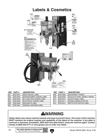

303
FACE SHIELD & SAFETY GLASSES 2W X 3.3H
304
ELECTRICITY 1.4W X 1.2H
305
EMERGENCY STOP LABEL
$1.25
306
MACHINE ID LABEL
$16.40
307
GENERAL WARNING LABEL
308
DISCONNECT 110V 2.8W X 1.5H
309
N/S GRIZZLY GREEN G1023S
310
TOUCH PANEL LABEL
$16.25
311
SPINDLE BREAK-IN NOTICE
312
DEPTH STOP NOTICE LABEL
KIT1
ELECTRICAL UPGRADE KIT V2.04.07
$977.90
MAN
MANUAL G0619 MFD-05.07-06.18 V1.05.07
$12.50
MANV2
MANUAL G0619 MFD-07.18+ V2.10.18
