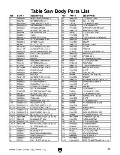

Parts List for Parts for G0713 10" 1-3/4 HP Left-Tilting Contractor Style Table Saw with Riving Knife

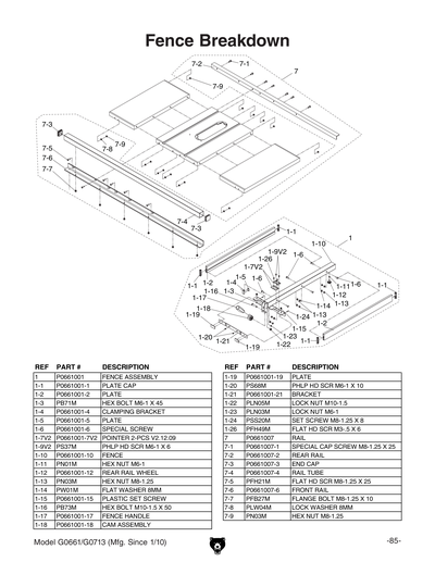

*DISCD*FENCE ASSEMBLY
1-1
PLATE CAP
1-10
FENCE
1-11
Now: PN01M
HEX NUT M6-1
1-12
RAIL WHEEL REAR
1-13
Now: PN03M
HEX NUT M8-1.25
1-14
Now: PW01M
FLAT WASHER 8MM
1-15
SET SCREW PLASTIC
1-16
Now: PB73M
HEX BOLT M10-1.5 X 50
1-17
FENCE HANDLE
1-18
CAM ASSEMBLY
1-19
PLATE
1-2
PLATE
1-20
Now: PS68M
PHLP HD SCR M6-1 X 10
1-21
BRACKET
1-22
LOCK NUT M10-1.5
1-23
LOCK NUT M6-1
1-24
SET SCREW M8-1.25 X 8
1-26
FLAT HD SCR M3-.5 X 6
1-3
Now: PB71M
HEX BOLT M6-1 X 45
1-4
CLAMPING BRACKET
1-5
PLATE
1-6
FENCE SCREW
1-7
POINTER 2PCS V2.12.09
1-7V2
1-9
Now: PS68M
1-9V2
Now: PS37M
PHLP HD SCR M6-1 X 6

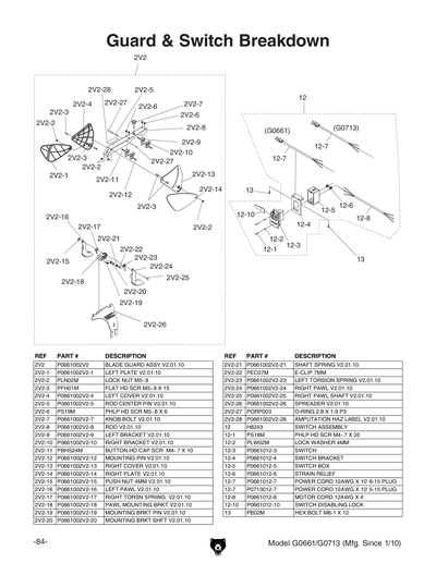

2V2
BLADE GUARD ASSY V2.01.10
2V2-1
LEFT PLATE V2.01.10
2V2-10
RIGHT BRACKET V2.01.10
2V2-11
BUTTON HD CAP SCR M4-.7 X 10
2V2-12
MOUNTING PIN V2.01.10
2V2-13
RIGHT COVER V2.01.10
2V2-14
RIGHT PLATE V2.01.10
2V2-15
PUSH NUT 4MM V2.01.10
2V2-16
LEFT PAWL V2.01.10
2V2-17
RIGHT TORSN SPRING V2.01.10
2V2-18
PAWL MOUNTING BRKT V2.01.10
2V2-19
MOUNTING BRKT PIN V2.01.10
2V2-2
LOCK NUT M5-.8
2V2-20
***USE P0869318***
2V2-21
SHAFT SPRING V2.01.10
2V2-22
E-CLIP 7MM
2V2-23
LEFT TORSION SPRING V2.01.10
2V2-24
RIGHT PAWL V2.01.10
2V2-25
RIGHT PAWL SHAFT V2.01.10
2V2-26
***USE PSB1110718***
2V2-27
O-RING 2.8 X 1.9 P3
2V2-28
AMPUTATION HAZ LABEL V2.01.10
2V2-3
FLAT HD SCR M5-.8 X 15
2V2-4
LEFT COVER V2.01.10
2V2-5
ROD CENTER PIN V2.01.10
2V2-6
Now: PS19M
PHLP HD SCR M5-.8 X 6
2V2-7
KNOB BOLT V2.01.10
2V2-8
BLADE GUARD BODY
2V2-9
LEFT BRACKET V2.01.10

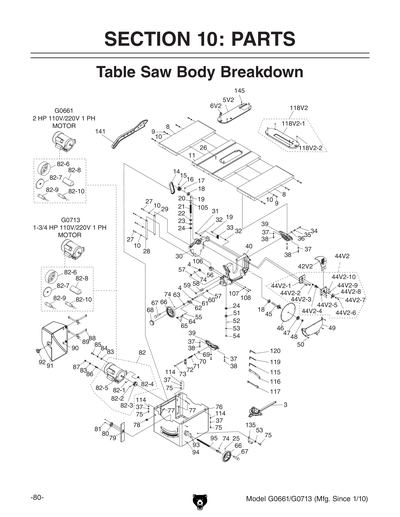

MITER GAUGE ASSEMBLY
SET SCREW M5-.8 X 5
5V2
Zero Clearance Table Saw Insert for G0661, G0713 & G0732
6V2
LOCK KNOB M5-.8 V2.01.10
RAIL
7-1
RAIL CAP SCREW M8-1.25 X 25
7-2
*DISCD*REAR RAIL
7-3
END CAP
7-4
RAIL TUBE
7-5
FLAT HD SCR M8-1.25 X 25
7-6
FRONT RAIL
7-7
FLANGE BOLT M8-1.25 X 10
7-8
LOCK WASHER 8MM
7-9
Now: PN03M
HEX NUT M8-1.25
EXTENSION TABLE
Now: PB09M
HEX BOLT M8-1.25 X 20
LOCK WASHER 8MM
TABLE
Now: D4151
Paddle Switch 120/230V
12-1
Now: PS18M
PHLP HD SCR M4-.7 X 25
12-2
LOCK WASHER 4MM
12-3
Now: D4151
12-4
SWITCH BRACKET
12-5
SWITCH BOX
12-6
STRAIN RELIEF M16 TYPE-1 SNAP-IN
12-7
POWER CORD 12AWG X 10' 5-15 PLUG
12-8
MOTOR CORD 12AWG X 4'
12-9
SWITCH DISABLING PIN 3/16 X 2-1/8"
Now: PB02M
HEX BOLT M6-1 X 12
RIBBED BELT 170J6
SPINDLE PULLEY
Now: PK34M
KEY 5 X 5 X 20
BALL BEARING 6203-2RS
CAP SCREW M8-1.25 X 16
LEADSCREW WASHER 8MM
ELEVATION LEADSCREW
BUSHING
GASKET
THRUST BEARING 51102
SET SCREW M5-.8 X 8
SET SCREW M8-1.25 X 20
CAP SCREW M8-1.25 X 35
COLUMN FRONT
REAR COLUMN
BRACKET
CAP SCREW M8-1.25 X 20
Now: PN03M
HEX NUT M8-1.25
EXTENSION SPRING
FLANGE BOLT M6-1 X 40
COMPRESSION SPRING
Now: PW03M
FLAT WASHER 6MM
EXT TOOTH WASHER 8MM
Now: PB07M
HEX BOLT M8-1.25 X 25
TRUNNION BRACKET
TRUNNION
42V2
RIVING KNIFE V2.01.10
44V2
BRACKET V2.01.10
44V2-1
MOUNTING BASE V2.01.10
44V2-10
SET SCREW M5-.8 X 8
44V2-2
44V2-3
COMPRESSION SPRING V2.01.10
44V2-4
LOCKING BOLT V2.01.10
44V2-5
MOUNTING BRACKET PLATE V2.01.10
44V2-6
BUTTON HD CAP SCR M5-.8 X 12
44V2-7
LOCK WASHER 5MM
44V2-8
HANDLE V2.01.10
44V2-9
BUTTON HD CAP SCR M5-.8 X 16
45
*DISCD* SPINDLE
46
BLADE 10" X 40T
BLADE MOUNTING FLANGE
48
ARBOR NUT 5/8"-12
49
BLADE COVER
50
Now: PS75M
PHLP HD SCR M5-.8 X 35
51
LEFT BEVEL GEAR
52
Now: PK05M
KEY 4 X 4 X 10
53
Now: PW01M
FLAT WASHER 8MM
54
LOCK NUT M8-1.25
55
EXT TOOTH WASHER 5MM
56
RIGHT BEVEL GEAR
57
Now: PW08M
FLAT WASHER 16MM
58
*DISCD*SHAFT
59
EXT TOOTH WASHER 16MM ZY CHROMATE
60
SHAFT
61
COLLAR
62
SUPPORT PLATE
63
COLLAR
64
POINTER
65
FLANGE SCREW M5-.8 X 10
66
HANDWHEEL
67
HANDWHEEL HANDLE
68
LOCKING KNOB 5/16-18
69
Now: PW01M
FLAT WASHER 8MM
70
E-CLIP 8MM
71
COMPRESSION SPRING
72
HANDLE W/BUSHING
73
SHAFT
74
Now: PK69M
KEY 4 X 4 X 12
75
Now: PB03M
HEX BOLT M8-1.25 X 16
76
CABINET
77
REUSABLE BEADED CABLE TIE
78
STRAIN RELIEF 3/4" TYPE-1 SNAP-IN
79
PLATE
80
BRACKET
81
LOCK NUT M5-.8

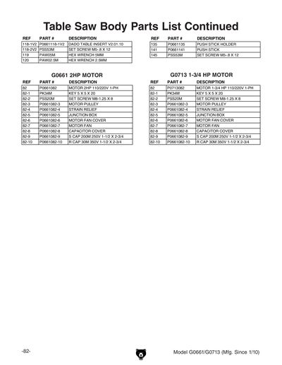

82
MOTOR 1-3/4HP 110V/220V 1-PH
$319.75
82-1
Now: PK34M
KEY 5 X 5 X 20
82-10
R CAPACITOR 35M 300V 1-1/2 X 2-3/4 V1
82-10V2
82-2
82-3
MOTOR PULLEY
82-4
82-5
JUNCTION BOX
82-6
MOTOR FAN COVER
82-7
MOTOR FAN
82-8
CAPACITOR COVER
82-9
S CAPACITOR 200M 125V 1-1/2 X 2-3/4
82-9V2
83
Now: PW04M
FLAT WASHER 10MM
84
LOCK WASHER 10MM
85
Now: PB01M
HEX BOLT M10-1.5 X 30
86
SHAFT
87
LOCK NUT M10-1.5
88
Now: PS09M
PHLP HD SCR M5-.8 X 10
89
HINGE
90
Now: PN06M
HEX NUT M5-.8
91
*DISCD*COVER
92
KNOB BOLT M8-1.25 X 30
93
Now: PS08M
PHLP HD SCR M5-.8 X 12
94
TAP SCREW M5 X 12
95
*DISCD*TILT LEADSCREW
96
Now: PW01M
FLAT WASHER 8MM
97
Now: PN03M
HEX NUT M8-1.25
98
CARRIAGE BOLT M8-1.25 X 12

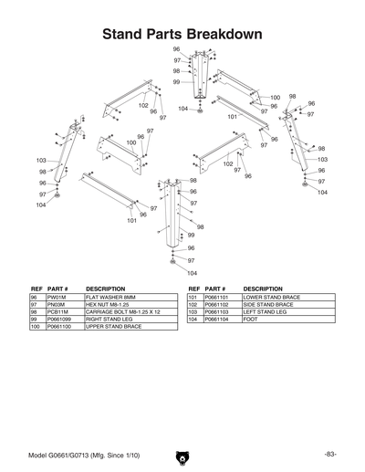

99
RIGHT STAND LEG
100
UPPER STAND BRACE
LOWER STAND BRACE
SIDE STAND BRACE
*DISCD*LEFT STAND LEG
FOOT
Now: PW01M
FLAT WASHER 8MM
106
*DISCD*LEADSCREW NUT
107
LOCK WASHER 6MM
108
CAP SCREW M6-1 X 30
114
Now: PW01M
FLAT WASHER 8MM
115
HEX WRENCH 6MM
116
ARBOR WRENCH
117
WRENCH 11 X 13MM OPEN-ENDS
118-1V2
DADO TABLE INSERT V2.01.10
118-2V2
SET SCREW M5-.8 X 12
118V2
*DISCD*DADO TBL INSERT ASSY V2.01.10
119
HEX WRENCH 5MM
120
HEX WRENCH 2.5MM
135
PUSH STICK HOLDER
141
PUSH STICK
145

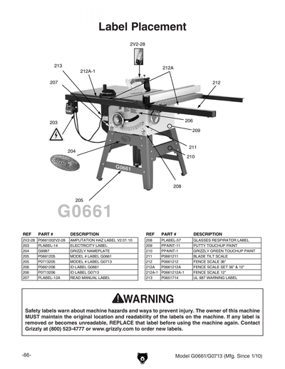

203
ELECTRICITY 1.4W X 1.2H
204
Now: G9987
Nameplate - Mini
205
MODEL NUMBER LABEL
206
MACHINE ID LABEL
207
208
GLASSES/RESPIRATOR 2W X 3.3H
209
GREY PUTTY REF G0504
210
N/S GRIZZLY GREEN G1023S
211
BLADE TILT SCALE
212
FENCE SCALE 36"
212A
FENCE SCALE SET 36" & 12"
212A-1
FENCE SCALE 12"
213
UL 987 WARNING LABEL
MAN
MANUAL FOR G0661 04/10
