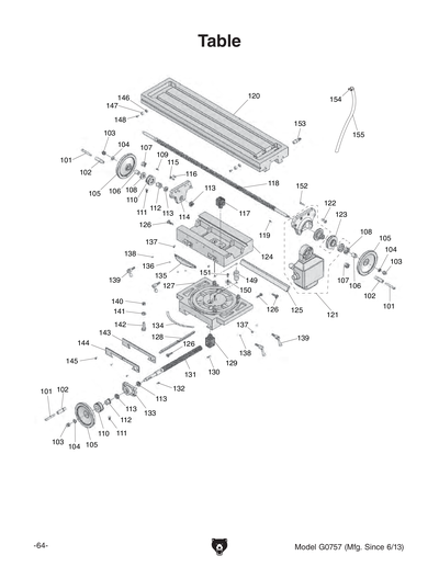

Parts for G0757 9" x 39" 2 HP Horizontal/Vertical Mill with Power Feed
Parts Diagrams for G0757 - 9" x 39" 2 HP Horizontal/Vertical Mill with Power Feed
Parts List for Parts for G0757 9" x 39" 2 HP Horizontal/Vertical Mill with Power Feed

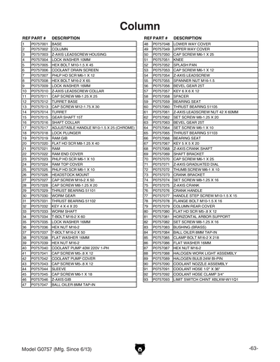

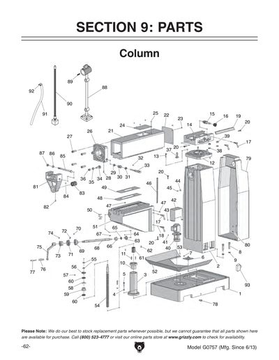

BASE
$2,116.75
COLUMN
$2,718.35
Z-AXIS LEADSCREW HOUSING
$325.65
LOCK WASHER 10MM
HEX BOLT M10-1.5 X 45
COOLANT DRAIN SCREEN
$17.25
Now: PS14M
PHLP HD SCR M6-1 X 12
HEX BOLT M16-2 X 65
LOCK WASHER 16MM
Z-AXIS LEADSCREW COLLAR
$75.90
CAP SCREW M8-1.25 X 25
TURRET BASE
$389.95
12-1
TURRET SCALE
$13.70
CAP SCREW M12-1.75 X 30
TURRET
$690.75
GEAR SHAFT 15T
$64.70
SHAFT COLLAR
$9.00
ADJUSTABLE HANDLE M10-1.5 X 25 (CHROME)
$18.00
LOCK PLUNGER
$1.80
RAM GIB
$53.60
FLAT HD SCR M8-1.25 X 40
$2,005.35
RAM END COVER
$14.40
Now: PS68M
PHLP HD SCR M6-1 X 10
RAM TOP COVER
$11.20
Now: PS68M
HEADSTOCK MOUNT
$378.85
CAP SCREW M16-2 X 50
CAP SCREW M8-1.25 X 20
THRUST BEARING 51101
WORM GEAR
$29.15
THRUST BEARING 51102
Now: PK48M
KEY 4 X 4 X 20
WORM SHAFT
$33.45
T-BOLT M16-2 X 60
$4.70
LOCK WASHER 16MM
Now: PN13M
HEX NUT M16-2
T-BOLT M16-2 X 50
Now: PW08M
FLAT WASHER 16MM
Now: PN13M
HEX NUT M16-2
COOLANT PUMP 40W 220V 1-PH
40-1
PUMP HOSE FITTING (PLASTIC)
$4.70
CAP SCREW M5-.8 X 12
COOLANT PUMP COVER
$22.35
SLEEVE
$2.60
45
CAP SCREW M6-1 X 18
46
Z-AXIS GIB
$64.00
BALL OILER 8MM PRESS-IN
48
LOWER WAY COVER
$6.90
49
UPPER WAY COVER
$11.20
50
CAP SCREW M6-1 X 25
51
KNEE
$1,916.20
51-1
WAY COVER
$40.25
52
SPLASH PAN
$111.45
53
CAP SCREW M6-1 X 12
54
Z-AXIS LEADSCREW
$231.85
55
SPANNER NUT M16-1.5
$1.90
56
BEVEL GEAR 25T
$31.35
57
Now: PK81M
KEY 6 X 6 X 12
58
SPACER
$2.60
59
BEARING SEAT
$13.70
60
THRUST BEARING 51105
61
Z-AXIS LEADSCREW NUT 42 X 60MM & COLLAR
$165.00
62
SET SCREW M8-1.25 X 20
63
BEVEL GEAR 25T
$29.15
64
SET SCREW M6-1 X 10
65
THRUST BEARING 51103
66
BEARING SEAT
$11.20
67
Now: PK34M
KEY 5 X 5 X 20
68
Z-AXIS CRANK SHAFT
$64.70
69
SHAFT BRACKET
$9.00
70
CAP SCREW M6-1 X 25
71
Z-AXIS GRADUATED DIAL
$29.00
72
THUMB SCREW M6-1 X 10
$2.25
73
CRANK BRACKET
$17.25
74
SET SCREW M8-1.25 X 16
75

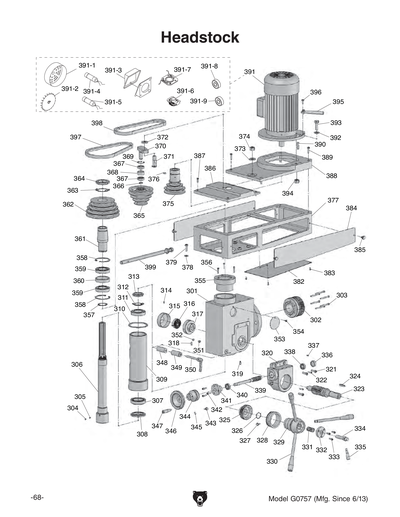

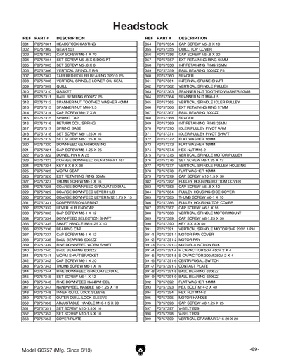

349
OUTER QUILL LOCK SLEEVE
$17.85
350
ADJUSTABLE HANDLE M10-1.5 X 90
$17.25
351
SET SCREW M10-1.5 X 10
352
353
COVER PLATE
$6.90
354
CAP SCREW M5-.8 X 10
355
QUILL TOP COVER
$100.35
356
CAP SCREW M5-.8 X 30
357
Now: PR56M
EXT RETAINING RING 45MM
358
Now: PR67M
INT RETAINING RING 75MM
359
BALL BEARING 6009ZZ P5
360
SPACER
$11.20
361
INTERNAL SPLINE SHAFT
$96.00
362
VERTICAL SPINDLE PULLEY
$167.15
363
EXT TOOTH WASHER 50MM
$4.70
364
SPANNER NUT M50-1.5
$15.85
365
VERTICAL SPINDLE IDLER PULLEY
$167.15
366
Now: PR18M
EXT RETAINING RING 17MM
367
Now: G3850
Bearing - 35mm x 17mm
368
SPACER
$6.90
369
Now: PR21M
INT RETAINING RING 35MM
370
IDLER PULLEY PIVOT ARM
$33.45
371
IDLER PULLEY PIVOT SHAFT
$11.20
372
Now: PW08M
FLAT WASHER 16MM
373
Now: PW08M
FLAT WASHER 16MM
374
Now: PN13M
HEX NUT M16-2
375
VERTICAL SPINDLE MOTOR PULLEY
$111.45
376
SET SCREW M8-1.25 X 12
377
VERTICAL SPINDLE PULLEY HOUSING
$512.50
378
Now: PW04M
FLAT WASHER 10MM
379
CAP SCREW M10-1.5 X 30
382
PULLEY HOUSING BOTTOM COVER
$33.45
383
384
PULLEY HOUSING SIDE COVER
$22.35
385
386
PULLEY HOUSING TOP COVER
$57.95
387
CAP SCREW M6-1 X 16
388
VERTICAL SPINDLE MOTOR MOUNT
$405.75
389
CAP SCREW M8-1.25 X 30
390
Now: PK41M
KEY 8 X 8 X 40
391
VERTICAL SPINDLE MOTOR 3HP 220V 1-PH
$1,011.95
391-1
MOTOR FAN COVER
$27.00
391-2
MOTOR FAN
$27.00
391-3
MOTOR JUNCTION BOX
$22.35
391-4
R CAPACITOR 50M 450V 2 X 4
$30.60
391-5
S CAPACITOR 300M 250V 2 X 4 LAI
391-6
CENTRIFUGAL SWITCH
$9.00
391-7
CONTACT PLATE
$4.70
391-8
BALL BEARING 6206ZZ
391-9
BALL BEARING 6206ZZ
392
Now: PW10M
FLAT WASHER 14MM
393
HEX BOLT M14-2 X 40
394
Now: PN32M
HEX NUT M14-2
395
MOTOR HANDLE
$33.45
396
397
Now: PVB29
V-BELT B29
398
Now: PVB29
V-BELT B29
399
VERTICAL DRAWBAR 7/16-20 X 20
$58.25

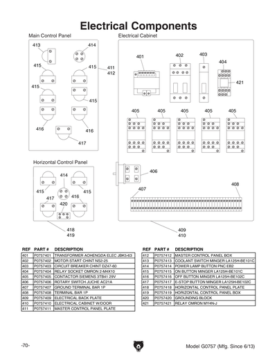

401
TRANSFORMER JBK5 160VA 220/400V-27V
$156.00
402
MOTOR START CHINT NS2-25
$121.25
403
CIRCUIT BREAKER 2A CHINT DZ47-60 C2 1P
$29.15
404
RELAY SOCKET OMRON 2-M4X10
$33.45
405
CONTACTOR SIEMENS 3TH82 24V
406
ROTARY SWITCH JUCHE AC21A
$78.00
407
GROUND TERMINAL BAR 1P
$15.85
408
TERMINAL BAR 1P
409
ELECTRICAL BACK PLATE
$40.25
410
ELECTRICAL CABINET W/DOOR
$84.85
411
MASTER CONTROL PANEL PLATE
$13.70
412
MASTER CONTROL PANEL BOX
$31.35
413
COOLANT SWITCH MINGER LA125H-BE101C
$31.35
414
POWER LAMP BUTTON PNC EB2
$31.35
415
ON BUTTON MINGER LA125H-BE101C
$31.35
416
OFF BUTTON MINGER LA125H-BE102C
$31.35
417
E-STOP BUTTON MINGER LA125H-BE102C
$49.25
418
HORIZONTAL CONTROL PANEL PLATE
$11.20
419
HORIZONTAL CONTROL PANEL BOX
$49.25
420
GROUNDING BLOCK
$33.45
421
RELAY OMRON MY4N-J
$40.25

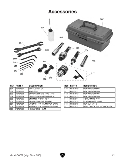

501
BOTTLE FOR OIL
502
TOOLBOX
503
SPINDLE SLEEVE MT#3-MT#2
504
DRILL CHUCK ARBOR R8 X B16
505
END MILL ARBOR R8-1"
$115.90
506
SPINDLE SLEEVE R8-MT#3
507
WRENCH 17 X 19MM OPEN-ENDS
508
WRENCH 22 X 24MM OPEN-ENDS
509
HEX WRENCH 8MM
510
HEX WRENCH 6MM
511
HEX WRENCH 5MM
512
HEX WRENCH 4MM
513
HEX WRENCH 3MM
514
T-BOLT M14-2 X 60
$4.70
515
Now: PW10M
FLAT WASHER 14MM
516
Now: PN32M
HEX NUT M14-2
517

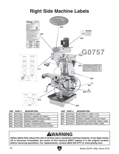

DRILL CHUCK B16 W/CHUCK KEY

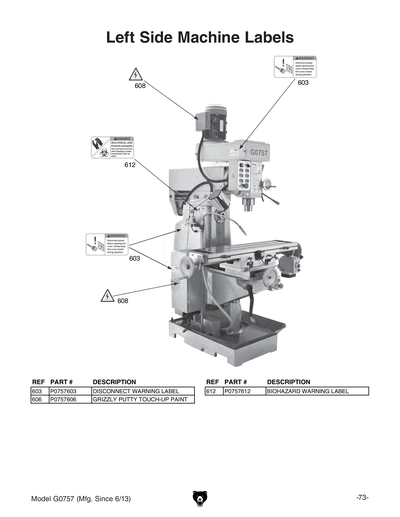

601
MACHINE ID LABEL
$16.40
602
Now: G8588
Nameplate - Small
603
DISCONNECT 220V 3.8W X 2H
604
MODEL NUMBER LABEL
$16.40
605
V-BELT CONFIGURATION LABEL
$9.70
606
GREY PUTTY REF G0504
607
ELECTRICITY 0.7W X 0.6H
608
ELECTRICITY 1.4W X 1.2H
609
N/S GRIZZLY GREEN G1023S
610
HORIZONTAL CONTROL PANEL LABEL
$9.70
611
612
BIOLOGICAL/POISON HAZARD 3.8W X 2H
613
HORIZONTAL SPINDLE MOTOR ID LABEL
$4.10
614
VERTICAL SPINDLE MOTOR ID LABEL
$4.10
P
HEX BOLT M16-2 X 65
$1.90
P
SET SCREW M5-.8 X 6 DOG-PT
$1.90
Z088V2
WORK LIGHT ASSEMBLY (LED) V2.01.15
