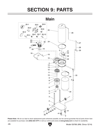

Parts Diagrams for G0786 - 2 HP Portable Dust Collector

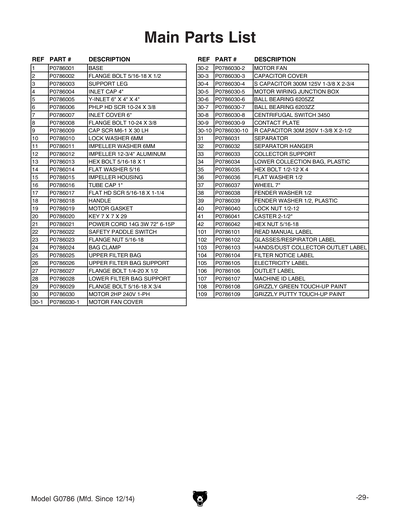

Parts List for Parts for G0786 2 HP Portable Dust Collector
BASE
Now: PFS20
FLANGE SCREW 5/16-18 X 1/2
SUPPORT LEG
INLET CAP 4"
$2.30
Y-INLET 6" X 4" X 4"
Now: PS06
PHLP HD SCR 10-24 X 3/8
INLET COVER 6"
Now: PFS03
FLANGE SCREW 10-24 X 3/8
CAP SCR M6-1 X 30 LH
LOCK WASHER 6MM
IMPELLER WASHER 6MM
IMPELLER 12-3/4" ALUMINUM
Now: PB03
HEX BOLT 5/16-18 X 1
Now: PW07
FLAT WASHER 5/16
IMPELLER HOUSING
$238.55
TUBE CAP 1"
$1.60
Now: PFH07
FLAT HD SCR 5/16-18 X 1-1/4
HANDLE
MOTOR GASKET
Now: PK28M
KEY 7 X 7 X 29
POWER CORD 14G 3W 72" 6-15P
Now: G8988
Safety Paddle Switch
Now: PFN02
FLANGE NUT 5/16-18
BAG CLAMP
$15.15
UPPER FILTER BAG
$53.45
UPPER FILTER BAG SUPPORT
$24.15
Now: PFS21
FLANGE SCREW 1/4-20 X 1/2
LOWER FILTER BAG SUPPORT
$24.15
Now: PFB02
FLANGE BOLT 5/16-18 X 3/4
MOTOR 2HP 240V 1-PH
30-1
MOTOR FAN COVER
30-10
Now: PC30
R CAPACITOR 30M 250V 1-3/8 X 2-1/2
30-2
MOTOR FAN
30-3
CAPACITOR COVER
30-4
S CAPACITOR 300M 125V 1-3/8 X 2-3/4
30-5
MOTOR WIRING JUNCTION BOX
30-6
BALL BEARING 6205ZZ
30-7
BALL BEARING 6203ZZ
30-8
CENT SWITCH 3450
30-9
CONTACT PLATE
SEPARATOR
SEPARATOR HANGER
$13.60
COLLECTOR SUPPORT
$14.10
LOWER COLLECTION BAG, PLASTIC
$9.20
Now: PB43
HEX BOLT 1/2-12 X 4
Now: PW01
FLAT WASHER 1/2
WHEEL 7"
Now: PWF04
FENDER WASHER 1/2
FENDER WASHER 1/2, PLASTIC
$3.05
LOCK NUT 1/2-12
$1.60
CASTER 2-1/2"
$9.20
Now: PN02
HEX NUT 5/16-18

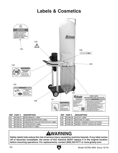

READ MANUAL 2.8W X 1.5H
GLASSES/RESPIRATOR 2.8W X 1.5H
HANDS/DUST COLLECTOR OUTLET 2.8W X 1.5H
FILTER NOTICE LABEL
ELECTRICITY 0.7W X 0.6H
106
OUTLET LABEL
$1.50
107
MACHINE ID LABEL
$16.40
108
N/S GRIZZLY GREEN G1023S
109
GREY PUTTY REF G0504
