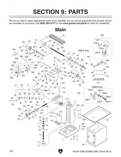

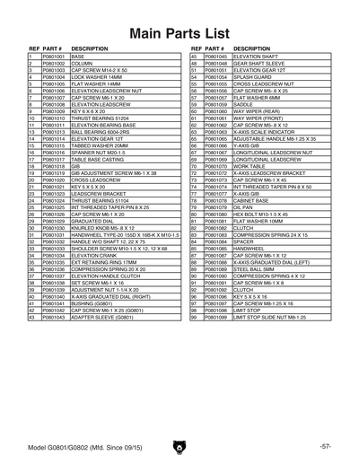

BASE
COLUMN
CAP SCREW M14-2 X 50
LOCK WASHER 14MM
Now: PW10M
FLAT WASHER 14MM
ELEVATION LEADSCREW NUT
CAP SCREW M6-1 X 20
ELEVATION LEADSCREW
Now: PK07M
KEY 6 X 6 X 20
THRUST BEARING 51204
ELEVATION BEARING BASE
BALL BEARING 6004-2RS
ELEVATION GEAR 12T
TABBED WASHER 20MM
SPANNER NUT M20-1.5
TABLE BASE CASTING
GIB
GIB ADJUSTMENT SCREW M6-1 X 38
CROSS LEADSCREW
Now: PK34M
KEY 5 X 5 X 20
LEADSCREW BRACKET
THRUST BEARING 51104
INT THREADED TAPER PIN 8 X 25
CAP SCREW M6-1 X 20
GRADUATED DIAL
KNURLED KNOB M5-.8 X 12
HANDWHEEL TYPE-20 155D X 16B-K X M10-1.5
HANDLE W/O SHAFT 12, 22 X 75
SHOULDER SCREW M10-1.5 X 12, 12 X 68
ELEVATION CRANK
Now: PR18M
EXT RETAINING RING 17MM
COMPRESSION SPRING 20 X 20
ELEVATION HANDLE CLUTCH
SET SCREW M6-1 X 16
ADJUSTMENT NUT 1-1/4 X 20
X-AXIS GRADUATED DIAL (RIGHT)
45
ELEVATION SHAFT
48
GEAR SHAFT SLEEVE
51
ELEVATION GEAR 12T
54
SPLASH GUARD
55
CROSS LEADSCREW NUT
56
CAP SCREW M5-.8 X 25
57
Now: PW03M
FLAT WASHER 6MM
59
SADDLE
60
WAY WIPER (REAR)
61
WAY WIPER (FRONT)
62
CAP SCREW M5-.8 X 12
63
X-AXIS SCALE INDICATOR
65
ADJUSTABLE HANDLE M8-1.25 X 35
66
Y-AXIS GIB
67
LONGITUDINAL LEADSCREW NUT
69
70
WORK TABLE
72
X-AXIS LEADSCREW BRACKET
73
CAP SCREW M6-1 X 45
74
INT THREADED TAPER PIN 8 X 50
77
X-AXIS GIB
78
CABINET BASE
79
OIL PAN
80
HEX BOLT M10-1.5 X 45
81
Now: PW04M
FLAT WASHER 10MM
82
CLUTCH
83
COMPRESSION SPRING 24 X 15
84
SPACER
85
HANDWHEEL
87
CAP SCREW M6-1 X 12
88
X-AXIS GRADUATED DIAL (LEFT)
89
STEEL BALL 5MM
90
COMPRESSION SPRING 4 X 12
91
CAP SCREW M6-1 X 8
92
CLUTCH
96
Now: PK08M
KEY 5 X 5 X 16
97
CAP SCREW M8-1.25 X 16
98
LIMIT STOP
99
LIMIT STOP SLIDE NUT M8-1.25

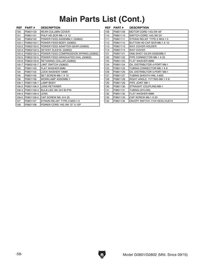

100
REAR COLUMN COVER
Now: PS14M
PHLP HD SCR M6-1 X 12
POWER FEED ASSEMBLY
$967.15
102-1
POWER FEED ASSEMBLY
102-2
POWER FEED ASSEMBLY
102-3
POWER FEED ASSEMBLY
102-4
POWER FEED ASSEMBLY
102-5
POWER FEED ASSEMBLY
102-6
POWER FEED ASSEMBLY
102-7
LIMIT SWITCH
$40.25
Now: PW03M
FLAT WASHER 6MM
LOCK WASHER 10MM
SET SCREW M6-1 X 10
106
WORKLAMP ASSEMBLY
106-1
LAMP BODY
106-2
LENS RETAINER
106-3
BULB LED 3W 24V BI-PIN
106-4
LENS
106-5
107
STRAIN RELIEF TYPE-3 M20-1.5
108
POWER CORD 14G 3W 72" 5-15P
109
MOTOR CORD 14G 5W 48"
110
SWITCH CORD 14G 3W 24"
111
STRAIN RELIEF TYPE-5 M24-1.5
112
BUTTON HD CAP SCR M6-1 X 10
113
WAY COVER HOLDER
114
WAY COVER
121
ONE-SHOT OILER ASSEMBLY
122
PIPE CONNECTOR M8-1 X 25
123
Now: PW01M
FLAT WASHER 8MM
124
OIL DISTRIBUTOR 4-PORT M8-1
125
TUBING CONNECTOR M8-1 X 8
126
OIL DISTRIBUTOR 5-PORT M8-1
127
TUBING SHEATH HNL 4-600
128
RIGHT-ANGLE FITTING M8-1 X 8
129
PIPE JOINT M8-1
130
STRAIGHT COUPLING M8-1
131
TUBING
132
Now: PW03M
FLAT WASHER 6MM
133
CAP SCREW M6-1 X 20
134
ON/OFF SWITCH ASSY KEDU KJD3 110V

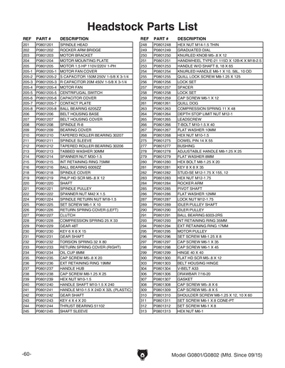

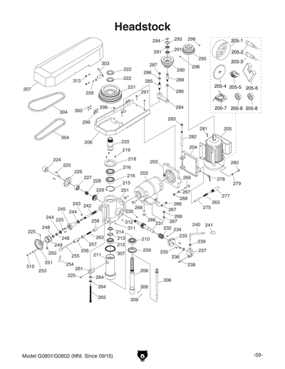

201
SPINDLE HEAD
202
ROCKER ARM BRIDGE
203
MOTOR BRACKET
204
MOTOR MOUNTING PLATE
205
MOTOR 1.5 HP 110V/220V 1-PH
205-1
MOTOR FAN COVER
205-2
S CAPACITOR 150M 250V 1-5/8 X 3-1/4
205-3
Now: PC20B
R CAPACITOR 20M 450V 1-5/8 X 3-1/4
205-4
MOTOR FAN
205-5
CENTRIFUGAL SWITCH
205-6
CAPACITOR COVER
205-7
CONTACT PLATE
205-8
BALL BEARING 6205ZZ
206
BELT HOUSING BASE
207
BELT HOUSING COVER
208
SPINDLE R-8
209
BEARING COVER
210
TAPERED ROLLER BEARING 30207
211
SPINDLE SLEEVE
212
TAPERED ROLLER BEARING 30206
213
TABBED WASHER 30MM
214
SPANNER NUT M30-1.5
215
Now: PR67M
INT RETAINING RING 75MM
216
BALL BEARING 6009ZZ
218
SPINDLE COVER
219
Now: PS08M
PHLP HD SCR M5-.8 X 12
220
SHAFT
221
SPINDLE PULLEY
222
SPANNER NUT M42 X 1.5
224
SPINDLE RETURN NUT M18-1.5
225
SET SCREW M6-1 X 10
226
RETURN SPRING COVER (LEFT)
227
CLUTCH
228
COMPRESSION SPRING 25 X 33
229
GEAR 48T
230
Now: PK99M
KEY 6 X 6 X 15
231
GEAR SHAFT
232
TORSION SPRING 32 X 80
233
RETURN SPRING COVER (RIGHT)
234
OIL CUP 8MM
235
CAP SCREW M5-.8 X 20
236
Now: PR08M
EXT RETAINING RING 19MM
237
HANDLE HUB
238
CAP SCREW M8-1.25 X 25
239
Now: PN02M
HEX NUT M10-1.5
240
HANDLE SHAFT M10-1.5 X 240
241
HANDLE M10-1.5 X 24D X 32L (PLASTIC)
242
GEAR SHAFT
243
Now: PK48M
KEY 4 X 4 X 20
244
THRUST BEARING 51102
245
SHAFT SLEEVE
248
HEX NUT M14-1.5 THIN
249
GRADUATED DIAL
250
251
HANDWHEEL TYPE-21 115D X 12B-K X M18-2.5
253
HANDWHEEL HANDLE 63L, M6-1 X 10
254
KNURLED HANDLE M6-1 X 10, 58L, 10 OD
255
QUILL LOCK SCREW M8-1.25 X 125
256
LOCK SET
257
SPACER
258
LOCK SET
259
CAP SCREW M6-1 X 12
261
QUILL DOG
263
COMPRESSION SPRING 11 X 48
264
DEPTH STOP LIMIT NUT M12-1
265
LEADSCREW
266
T-BOLT M10-1.5 X 40
267
Now: PW04M
FLAT WASHER 10MM
268
Now: PN02M
HEX NUT M10-1.5
275
DOWEL PIN 14 X 55
277
BUSHING
278
ADJUSTABLE HANDLE M8-1.25 X 25
279
Now: PW01M
FLAT WASHER 8MM
280
Now: PB09M
HEX BOLT M8-1.25 X 20
281
Now: PK09M
KEY 8 X 8 X 35
282
STUD-SE M12-1.75 X 155, 12
283
Now: PN09M
HEX NUT M12-1.75
284
ROCKER ARM
285
PIVOT SHAFT
286
Now: PW06M
FLAT WASHER 12MM
287
LOCK NUT M12-1.75
289
IDLER PULLEY SHAFT
290
IDLER PULLEY
291
BALL BEARING 6003-2RS
293
Now: PR21M
INT RETAINING RING 35MM
294
Now: PR18M
295
MOTOR PULLEY
296
SET SCREW M8-1.25 X 8
297
CAP SCREW M6-1 X 35
298
CAP SCREW M6-1 X 45
299
HINGE 40 X 40
300
FLAT HD SCR M5-.8 X 12
303
BELT HOUSING HINGE
304
Now: PVA33
V-BELT A33
306
DRAWBAR 7/16-20
307
GASKET
308
CAP SCREW M5-.8 X 6
309
CAP SCREW M5-.8 X 5
310
311
SET SCREW M6-1 X 8 CONE-PT
312
SET SCREW M6-1 X 8
313
Now: PN01M
HEX NUT M6-1

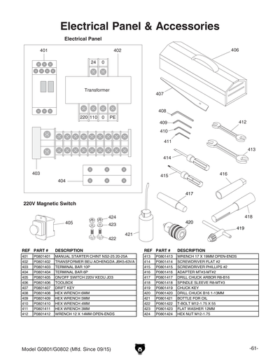

401
MANUAL STARTER CHINT NS2-25 20-25A
402
TRANSFORMER BEIJ AOHENGDA JBK5-63VA
403
TERMINAL BAR 10P
404
TERMINAL BAR 6P
405
ON/OFF SWITCH ASSY KEDU JD3 220V
406
TOOLBOX
407
DRIFT KEY
408
HEX WRENCH 6MM
409
HEX WRENCH 5MM
410
HEX WRENCH 4MM
411
HEX WRENCH 3MM
412
WRENCH 12 X 14MM OPEN-ENDS
413
WRENCH 17 X 19MM OPEN-ENDS
414
Now: PSDF2
SCREWDRIVER FLAT #2
415
Now: PSDP2
SCREWDRIVER PHILLIPS #2
416
ADAPTER MT#3-MT#2
417
DRILL CHUCK ARBOR R8-B16
418
SPINDLE SLEEVE R8-MT#3
419
CHUCK KEY
420
DRILL CHUCK B16 1-13MM
421
BOTTLE FOR OIL
422
T-BOLT M12-1.75 X 55
423
Now: PW06M
FLAT WASHER 12MM
424
Now: PN09M
HEX NUT M12-1.75

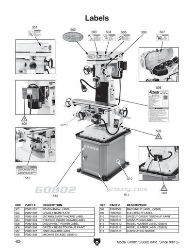

501
READ MANUAL 2.8W X 1.5H
502
Now: G9987
Nameplate - Mini
503
ENTANGLEMENT HAZARD 2.8W X 1.5H
504
FACE SHIELD & SAFETY GLASSES 1.5W X 2.5H
505
DISCONNECT 110V 2.8W X 1.5H
506
BEIGE REF G0555
507
PINCH HAZARD LABEL
508
MACHINE ID LABEL
509
ELECTRICITY 0.7W X 0.6H
510
N/S GRIZZLY GREEN G1023S
511
***USE PGZCOM-26B***
512
MODEL NUMBER LABEL
513
LUBRICATION NOTICE
