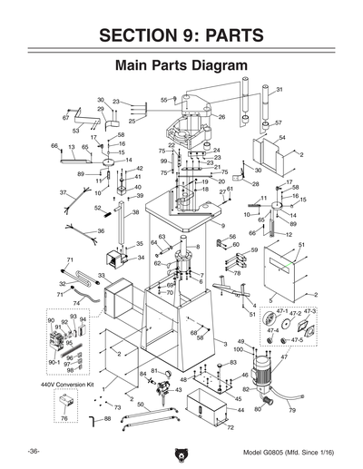

Parts Diagrams for G0805 - Super Heavy-Duty Angle Notcher, 9-Gauge

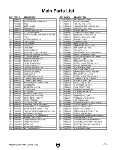

Parts List for Parts for G0805 Super Heavy-Duty Angle Notcher, 9-Gauge
FRONT COVER
BUTTON HD CAP SCR M6-1 X 8
BASE
NOTCH CHUTE
REAR COVER
CAP SCREW M14-2 X 50
Now: PW10M
FLAT WASHER 14MM
HYDR CYCLINDER LIAN HER LHC-FA-1412
TABLE
CAP SCREW M6-1 X 16
T-SLOT GUIDE
FENCE (RIGHT)
FENCE (LEFT)
MITER BODY
BLOCK GUIDE KEY
SHOULDER PIN M6-1 X 8, 8 X 40
ADJUSTABLE HANDLE 64L M10-1.5
ECCENTRIC SPACER
CAP SCREW M8-1.25 X 16
CUT SCALE (RIGHT)
LOWER BLADE (RIGHT)
LOWER BLADE (LEFT)
CAP SCREW M10-1.5 X 20
UPPER BLADE (RIGHT)
UPPER BLADE (LEFT)
HEAD CASTING
SET SCREW M10-1.5 X 30
CORNER GUARD (RIGHT)
CORNER GUARD (LEFT)
BUTTON HD CAP SCR M5-.8 X 10
MAIN COLUMN
CONDUIT 30" X 1/2" ID
CONTROL BOX
FOOT PEDAL
Now: PS20M
PHLP HD SCR M5-.8 X 15
POWER CORD 14G 4W 72"
E-STOP CORD 16G 3W 72"
E-STOP PEDESTAL
Now: PS07M
PHLP HD SCR M4-.7 X 8
EMERGENCY STOP SWITCH BOX
E-STOP RENY AC15-DC13 10A 600V
BUTTON HD CAP SCR M4-.7 X 45
PUMP ACTUATOR DSG-02-3C60-A2-N AC24
HYDRAULIC FLUID TANK
45
HYDRAULIC FLUID TANK COVER
46
Now: PB09M
HEX BOLT M8-1.25 X 20
MOTOR 3HP 220V/440V 3-PH
47-1
MOTOR FAN COVER
47-2
MOTOR FAN
47-3
MOTOR JUNCTION BOX
47-4
BALL BEARING 6206ZZ
47-5
BALL BEARING 6203ZZ
48
Now: PW01M
FLAT WASHER 8MM
49
Now: PB32M
HEX BOLT M10-1.5 X 25
50
HYDRAULIC TUBE 18"L X 3/4" O.D.
51
CAP SCREW M6-1 X 12
52
PLASTIC HANDLE
53
CLEAR CUTTER GUARD (PLASTIC)
54
COVER, REAR HEAD (METAL)
55
EYE BOLT 35MM, M16-2 X 26
56
SUPPORT PLATE
57
COPPER SLEEVE
58
KNOB 5-LOBE M6-1
59
LIMIT SWITCH TEND TZ-8104
60
CAP SCREW M6-1 X 16
61
Now: PN02M
HEX NUT M10-1.5
62
STRAIN RELIEF NPT 1/4-3/8 (BRASS)
63
Now: PR10M
EXT RETAINING RING 22MM
64
CLEVIS PIN, HEADLESS 24 X 126MM
65
ROLL PIN 4 X 14
66
SET SCREW M8-1.25 X 20
67
BUTTON HD CAP SCR M4-.7 X 10
68
FENDER WASHER 6MM
69
Now: PW06M
FLAT WASHER 12MM
70
CAP SCREW M12-1.75 X 25
71
STRAIN RELIEF TYPE-3 PG26 1/2"
72
CAP SCREW M8-1.25 X 10
73
74
CONDUIT 72" X 3/4" ID RIBBED
75
FLAT HD SCR M4-.7 X 6
76
OL RELAY TEND THR13-6.5 5-8A
78
Now: PS95M
PHLP HD SCR M3-.5 X 30
79
FLUID RETURN TUBE
80
HYDRAULIC FLUID FILTER
81
OIL PRESSURE GAUGE
82
OIL PUMP
83
RESERVOIR FILL CAP
84
PRESSURE VALVE HANDLE
88
HEX WRENCH 7MM
89
SHOULDER PIN M10-1.5 X 10, 12 X 50
90
CONTACTOR TC-11 24V
90-1
OL RELAY TEND 6-13A
91
RELAY SCLB-W-DPDT 24V 5A
92
RELAY SCLD-W-B-PDT-C 24V 5A
93
FUSE RT18W/32 X 690V
94
TRANSFORMER COM 110VA 220V/440V
95
TERMINAL BAR 21 POST
96
UP/DOWN SWITCH RENY AC15-DC13
97
MAN/AUTO SWITCH RENY AC15-DC13
98
ON/OFF BUTTON RENY AC15-DC13
99
CUT SCALE (LEFT)
100
Now: PW04M
FLAT WASHER 10MM

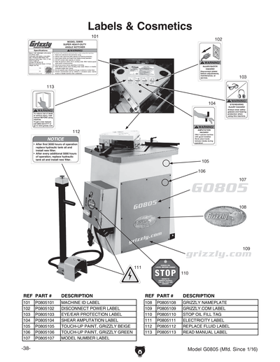

MACHINE ID LABEL
DISCONNECT 110V 1.5W X 2.5H
EYE/EAR PROTECTION LABEL
SHEAR AMPUTATION LABEL
GREY PUTTY REF G0504
106
N/S GRIZZLY GREEN G1023S
107
MODEL NUMBER LABEL
108
Now: G8589
Nameplate - Large
109
GRIZZLY.COM LABEL 13",BEIGE
110
STOP OIL FILL TAG 4W X 4H
111
ELECTRICITY 1.4W X 1.2H
112
REPLACE FLUID LABEL
113
READ MANUAL 1.5W X 2.5H
MAN
MANUAL G0805 MFD-01.16 V1.05.16
