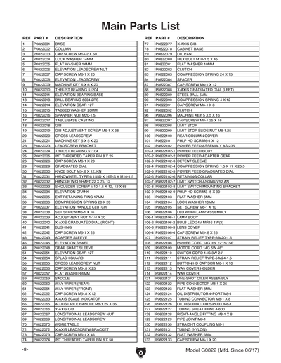

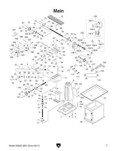

BASE
COLUMN
CAP SCREW M14-2 X 50
LOCK WASHER 14MM
Now: PW10M
FLAT WASHER 14MM
ELEVATION LEADSCREW NUT
CAP SCREW M6-1 X 20
ELEVATION LEADSCREW
Now: PK07M
KEY 6 X 6 X 20
THRUST BEARING 51204
ELEVATION BEARING BASE
BALL BEARING 6004-2RS
ELEVATION GEAR 12T
TABBED WASHER 20MM
SPANNER NUT M20-1.5
TABLE BASE CASTING
GIB
GIB ADJUSTMENT SCREW M6-1 X 38
CROSS LEADSCREW
Now: PK34M
KEY 5 X 5 X 20
LEADSCREW BRACKET
THRUST BEARING 51104
INT THREADED TAPER PIN 8 X 25
CAP SCREW M6-1 X 20
GRADUATED DIAL
KNURLED KNOB M5-.8 X 12
HANDWHEEL TYPE-8 155D X 16B-S X M10-1.5
HANDLE W/O SHAFT 12, 22 X 75
SHOULDER SCREW M10-1.5 X 12, 12 X 68
ELEVATION CRANK
Now: PR18M
EXT RETAINING RING 17MM
COMPRESSION SPRING 20 X 20
ELEVATION HANDLE CLUTCH
SET SCREW M6-1 X 16
ADJUSTMENT NUT 1-1/4 X 20
X-AXIS GRADUATED DIAL (RIGHT)
BUSHING
CAP SCREW M6-1 X 25
ADAPTER SLEEVE
45
ELEVATION SHAFT
48
GEAR SHAFT SLEEVE
51
ELEVATION GEAR 12T
54
SPLASH GUARD
55
CROSS LEADSCREW NUT
56
CAP SCREW M5-.8 X 25
57
Now: PW03M
FLAT WASHER 6MM
59
SADDLE
60
WAY WIPER (REAR)
61
WAY WIPER (FRONT)
62
CAP SCREW M5-.8 X 12
63
X-AXIS SCALE INDICATOR
65
ADJUSTABLE HANDLE M8-1.25 X 35
66
Y-AXIS GIB
67
LONGITUDINAL LEADSCREW NUT
69
70
WORK TABLE
72
X-AXIS LEADSCREW BRACKET
73
CAP SCREW M6-1 X 45
74
INT THREADED TAPER PIN 8 X 50
77
X-AXIS GIB
78
CABINET BASE ASSY
79
OIL PAN
80
HEX BOLT M10-1.5 X 45
81
Now: PW04M
FLAT WASHER 10MM
82
CLUTCH
83
COMPRESSION SPRING 24 X 15
84
SPACER
87
CAP SCREW M6-1 X 12
88
X-AXIS GRADUATED DIAL (LEFT)
89
STEEL BALL 5MM
90
COMPRESSION SPRING 4 X 12
91
CAP SCREW M6-1 X 8
92
CLUTCH
96
Now: PK08M
KEY 5 X 5 X 16
97
CAP SCREW M8-1.25 X 16
98
LIMIT STOP
99
LIMIT STOP SLIDE NUT M8-1.25
100
REAR COLUMN COVER
Now: PS14M
PHLP HD SCR M6-1 X 12
POWER FEED ASSEMBLY
102-1
POWER FEED ASSEMBLY
102-2
POWER FEED ASSEMBLY
102-3
POWER FEED ASSEMBLY
102-4
POWER FEED ASSEMBLY
102-5
POWER FEED ASSEMBLY
102-6
POWER FEED ASSEMBLY
102-7
LIMIT SWITCH
102-8
LIMIT SWITCH MOUNTING BRACKET
102-9
Now: PS95M
PHLP HD SCR M3-.5 X 30
Now: PW03M
FLAT WASHER 6MM
LOCK WASHER 10MM
SET SCREW M6-1 X 10
106
WORKLAMP ASSEMBLY
106-1
LAMP BODY
106-2
BULB LED 24V MR16 1W(3)
$18.00
106-3
LENS COVER
106-4
107
STRAIN RELIEF TYPE-3 M20-1.5
108
POWER CORD 14G 3W 72" 5-15P
109
MOTOR CORD 14G 5W 48"
110
SWITCH CORD 14G 3W 24"
111
STRAIN RELIEF TYPE-5 M24-1.5
112
BUTTON HD CAP SCR M6-1 X 10
113
WAY COVER HOLDER
114
WAY COVER
121
ONE-SHOT OILER ASSEMBLY
122
PIPE CONNECTOR M8-1 X 25
123
Now: PW01M
FLAT WASHER 8MM
124
OIL DISTRIBUTOR 4-PORT M8-1
125
TUBING CONNECTOR M8-1 X 8
126
OIL DISTRIBUTOR 5-PORT M8-1
127
TUBING SHEATH HNL 4-600
128
RIGHT-ANGLE FITTING M8-1 X 8
129
PIPE JOINT M8-1
130
STRAIGHT COUPLING M8-1
131
TUBING
132
Now: PW03M
FLAT WASHER 6MM
133
CAP SCREW M6-1 X 20

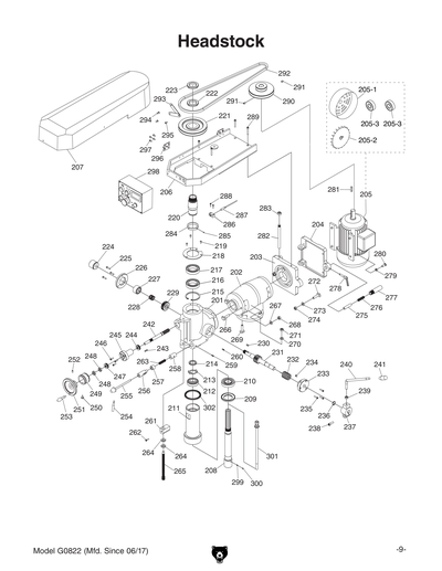

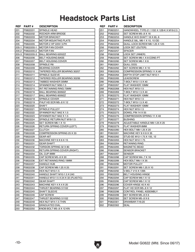

201
SPINDLE HEAD
202
ROCKER ARM BRIDGE
203
MOTOR BRACKET
204
MOTOR MOUNTING PLATE
205
MOTOR 2 HP 220V 3-PH
$717.70
205-1
MOTOR FAN COVER
205-2
MOTOR FAN
$21.60
205-3
BALL BEARING 6205ZZ
206
BELT HOUSING BASE
207
BELT HOUSING COVER
208
SPINDLE R8
209
BEARING COVER
210
TAPERED ROLLER BEARING 30207
211
SPINDLE SLEEVE
212
TAPERED ROLLER BEARING 30206
213
TABBED WASHER 30MM
214
SPANNER NUT M30-1.5
215
Now: PR67M
INT RETAINING RING 75MM
216
BALL BEARING 6009ZZ
217
BALL BEARING 6009ZZ
218
SPINDLE COVER
219
Now: PS08M
PHLP HD SCR M5-.8 X 12
220
SHAFT
221
SPINDLE PULLEY
222
SPANNER NUT M42 X 1.5
223
224
SPINDLE RETURN NUT M18-1.5
225
SET SCREW M6-1 X 10
226
RETURN SPRING COVER (LEFT)
227
CLUTCH
228
COMPRESSION SPRING 25 X 33
229
GEAR 48T
230
Now: PK99M
KEY 6 X 6 X 15
231
GEAR SHAFT
232
TORSION SPRING 32 X 80
233
RETURN SPRING COVER (RIGHT)
234
OIL CUP 8MM
235
CAP SCREW M5-.8 X 20
236
Now: PR08M
EXT RETAINING RING 19MM
237
HANDLE HUB
238
CAP SCREW M8-1.25 X 25
239
Now: PN02M
HEX NUT M10-1.5
240
HANDLE SHAFT M10-1.5 X 240
241
HANDLE M10-1.5 X 24 X 32 (PLASTIC)
242
GEAR SHAFT
243
Now: PK48M
KEY 4 X 4 X 20
244
THRUST BEARING 51102
245
SHAFT SLEEVE
246
CAP SCREW
247
248
HEX NUT M14-1.5 THIN
249
GRADUATED DIAL
250
KNOB BOLT M5-.8 X 12 KN
251
HANDWHEEL TYPE-21 115D X 12B-K X M18-2.5
252
SET SCREW M5-.8 X 16
253
HANDLE W/O SHAFT 18 X 65, 8
254
HANDLE 58L, M6-1 X 10, 10 OD
255
QUILL LOCK SCREW M8-1.25 X 125
256
LOCK SET (OUTER)
257
SPACER
258
LOCK SET (INNER)
259
SET SCREW M6-1 X 8 CONE-PT
260
SET SCREW M6-1 X 8
261
QUILL DOG
262
SET SCREW M6-1 X 10
263
COMPRESSION SPRING 11 X 48
264
DEPTH STOP LIMIT NUT M12-1
265
LEADSCREW
266
T-BOLT M10-1.5 X 40
267
Now: PW04M
FLAT WASHER 10MM
268
Now: PN02M
HEX NUT M10-1.5
269
T-BOLT M10-1.5 X 40
270
Now: PW04M
FLAT WASHER 10MM
271
Now: PN02M
HEX NUT M10-1.5
272
T-BOLT M10-1.5 X 40
273
Now: PW04M
FLAT WASHER 10MM
274
Now: PN02M
HEX NUT M10-1.5
275
DOWEL PIN 14 X 55
276
277
BUSHING
278
ADJUSTABLE HANDLE M8-1.25 X 25
279
Now: PW01M
FLAT WASHER 8MM
280
Now: PB09M
HEX BOLT M8-1.25 X 20
281
Now: PK09M
KEY 8 X 8 X 35
282
STUD-SE M12-1.75 X 155, 12
283
Now: PN09M
HEX NUT M12-1.75
284
RETAINING RING
285
MAGNETIC BEAD
286
SENSOR BRACKET
287
SENSOR
288
CAP SCREW M4-.7 X 16
289
Now: PB52M
HEX BOLT M6-1 X 35
290
MOTOR PULLEY
$44.60
291
SET SCREW M8-1.25 X 10
292
V-BELT V13 X 1395
293
BELT HOUSING HINGE
294
CAP SCREW M6-1 X 12
295
CAP SCREW M6-1 X 12
296
COVER HINGE 40 X 40
297
FLAT HD SCR M5-.8 X 12
298
CONTROL PANEL ASSEMBLY
$334.25
299
CAP SCREW M5-.8 X 6
300
CAP SCREW M5-.8 X 6
301
DRAWBAR 7/16-20
302
SEAL

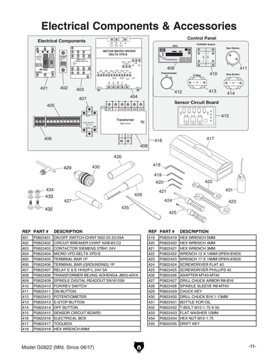

401
ON/OFF SWITCH CHINT NS2-25 20-25A
402
CIRCUIT BREAKER CHINT NXB-83 C2
403
CONTACTOR SIEMENS 3TB41 24V
404
MICRO VFD DELTA VFD-E
$1,033.85
405
TERMINAL BAR 10P
406
TERMINAL BAR 3P
407
RELAY E & E HH52P-L 24V 5A
408
TRANSFORMER BEJING AOHENGA JBK5-40VA
$64.40
409
SPINDLE DIGITAL READOUT SN161209
410
FOR/REV SWITCH
$31.35
411
ON BUTTON
412
POTENTIOMETER
413
E-STOP BUTTON
414
OFF BUTTON
415
SENSOR CIRCUIT BOARD
$44.60
416
ELECTRICAL BOX
417
TOOLBOX
418
HEX WRENCH 6MM
419
HEX WRENCH 5MM
420
HEX WRENCH 4MM
421
HEX WRENCH 3MM
422
WRENCH 12 X 14MM OPEN-ENDS
423
WRENCH 17 X 19MM OPEN-ENDS
424
Now: PSDF2
SCREWDRIVER FLAT #2
425
Now: PSDP2
SCREWDRIVER PHILLIPS #2
426
ADAPTER MT#3-MT#2
427
DRILL CHUCK ARBOR R8-B16
428
SPINDLE SLEEVE R8-MT#3
429
CHUCK KEY
430
DRILL CHUCK B16 1-13MM
431
BOTTLE FOR OIL
432
T-BOLT M12-1.75 X 55
433
Now: PW06M
FLAT WASHER 12MM
434
Now: PN09M
HEX NUT M12-1.75
435
DRIFT KEY

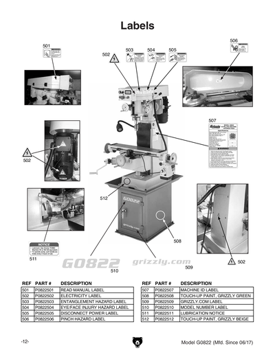

501
READ MANUAL 2.8W X 1.5H
502
ELECTRICITY 0.7W X 0.6H
503
ENTANGLEMENT HAZARD 2.8W X 1.5H
504
FACE SHIELD & SAFETY GLASSES 1.5W X 2.5H
505
DISCONNECT 110V 2.8W X 1.5H
506
PINCH HAZARD LABEL
507
MACHINE ID LABEL
508
N/S GRIZZLY GREEN G1023S
509
GRIZZLY.COM LABEL 9",BEIGE
510
MODEL NUMBER LABEL
511
LUBRICATION NOTICE
512
BEIGE REF G0555
