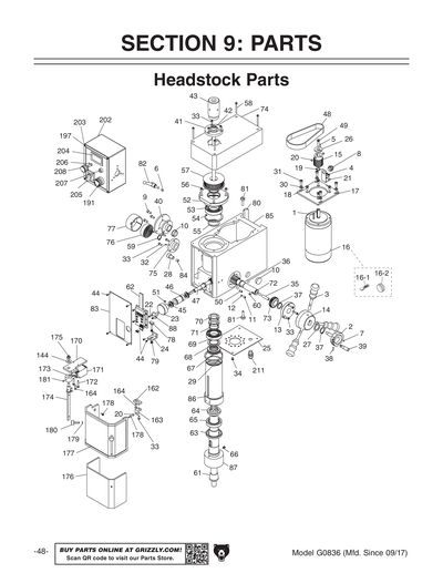

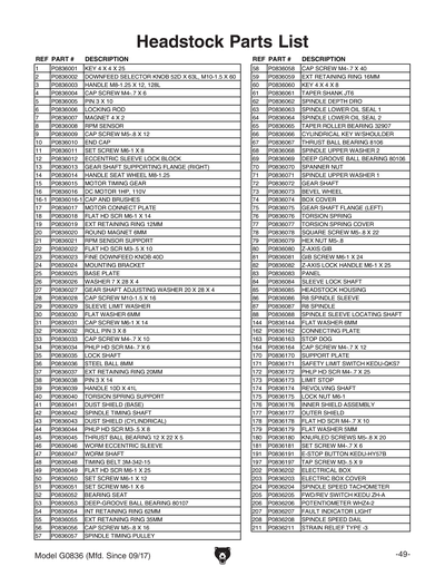

KEY 4 X 4 X 25
SELECTOR KNOB 52D X 63L, M10-1.5 X 60
HANDLE M8-1.25 X 12, 128L
CAP SCREW M4-.7 X 6
PIN 3 X 10
LOCKING ROD
MAGNET 4 X 2
RPM SENSOR
$29.90
CAP SCREW M5-.8 X 12
END CAP
SET SCREW M6-1 X 8
ECCENTRIC SLEEVE LOCK BLOCK
GEAR SHAFT SUPPORTING FLANGE (RIGHT)
HANDLE SEAT WHEEL M8-1.25
MOTOR TIMING GEAR
DC MOTOR 1HP, 110V
16-1
CAP AND BRUSHES
$15.15
MOTOR CONNECT PLATE
FLAT HD SCR M6-1 X 14
Now: PR03M
EXT RETAINING RING 12MM
ROUND MAGNET 6MM
$1.90
RPM SENSOR SUPPORT
FLAT HD SCR M3-.5 X 10
FINE DOWNFEED KNOB 40D
MOUNTING BRACKET
BASE PLATE
WASHER 7 X 28 X 4
$1.90
GEAR SHAFT ADJUSTING WASHER 20 X 28 X 4
CAP SCREW M10-1.5 X 16
SLEEVE LIMIT WASHER
Now: PW03M
FLAT WASHER 6MM
CAP SCREW M6-1 X 14
ROLL PIN 3 X 8
CAP SCREW M4-.7 X 10
Now: PS17M
PHLP HD SCR M4-.7 X 6
LOCK SHAFT
STEEL BALL 8MM
Now: PR09M
EXT RETAINING RING 20MM
PIN 3 X 14
HANDLE 10D X 41L
TORSION SPRING SUPPORT
401
CAP SCREW M8-1.25 X 30
402
Now: PB31M
HEX BOLT M10-1.5 X 40
403
Now: PW04M
FLAT WASHER 10MM
404
LOCK WASHER 10MM
405
TAPERED PIN W/INT THREAD M6-1 X 24
406
CAP SCREW M5-.8 X 30
407
Now: PB95M
HEX BOLT M5-.8 X 16
408
SET SCREW M6-1 X 10
409
LOCK RING M12-1 X 6
DUST SHIELD (BASE)
410
LARGE CONICAL GEAR
411
BEVEL PINION
412
TAPERED SET SCREW M5-.8 X 8
413
TAPERED SET SCREW M5-.8 X 10
414
CAP SCREW M6-1 X 12
415
TAPERED PIN W/INT THREAD M6-1 X 16
416
COLUMN NUT BLOCK
417
ROLL PIN 3 X 20
418
LIFT NUT
419
LIFT LOCK NUT
SPINDLE TIMING SHAFT
420
LIFT SUPPORT SET
421
DEEP-GROOVE BALL BEARING 6001
422
LIFTING SHAFT
423
ROLL PIN 3 X 16
424
Now: PK37M
KEY 4 X 4 X 16
425
HANDWHEEL TYPE-8 100D X 8B X M8-1.25
$20.15
426
SCALE LIFT RING
427

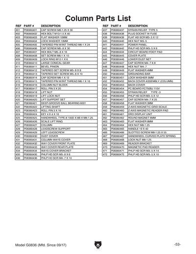

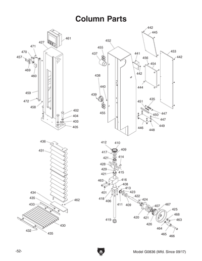

COLUMN
428
LEADSCREW SUPPORT
429
LEFT LEADSCREW
DUST SHIELD (CYLINDRICAL)
430
DUST COVER
431
COLUMN WAYS COVER
432
WAY COVER FRONT PLATE
433
WAY COVER REAR PLATE
434
WAYS COVER BRACKET
435
Now: PS19M
PHLP HD SCR M5-.8 X 6
436
Now: PS38M
PHLP HD SCR M4-.7 X 10
437
STRAIN RELIEF TYPE 5
438
PLUG SOCKET W FUSE
439
FLAT HD SCR M3-.5 X 12
Now: PS79M
PHLP HD SCR M3-.5 X 8
440
Now: PN07M
HEX NUT M3-.5
441
POWER PANEL
442
Now: PS12M
PHLP HD SCR M3-.5 X 6
444
CIRCUIT BOARD FOOT PAD
445
COVER PLATE
446
LOWER DUST NET
447
CAP SCREW M4-.7 X 8
448
Now: PN04M
HEX NUT M4-.7
449
Now: PW05M
FLAT WASHER 4MM
45
THRUST BALL BEARING 12 X 22 X 5
$9.00
450
GROUNDING BAR
451
LOCK WASHER 5MM
452
BACK COVER ASSEMBLY (COLUMN)
453
BACK COVER
454
PC BOARD FC750BJ 110V
$505.35
455
STRAIN RELIEF TYPE -3
456
Now: PS50M
PHLP HD SCR M3-.5 X 12
457
CAP SCREW M4-.7 X 25
458
FLAT WASHER 3MM
459
Z-AXIS MAGNETIC GRID SCALE
46
WORM ECCENTRIC SLEEVE
460
Z-AXIS MAGNETIC READER PAD
461
DRO DISPLAY UNIT
$386.40
462

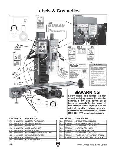

501
CONTROL PANEL LABEL
$9.70
502
READ MANUAL 1.5W X 2.5H
503
G0836 LABEL
504
GRIZZLY.COM LABEL 3.50",BEIGE
505
EYE/FACE INJURY
506
FINE DOWNFEED CONTROL LABEL
507
ENTANGLEMENT HAZARD 1.5W X 2.5H
508
WARNING LABEL
509
MACHINE ID LABEL
$16.40
51
SET SCREW M6-1 X 6
510
SPINDLE BREAK-IN LABEL
511
POWERFEED CONTROL LABEL
512
ELECTRICITY 1.4W X 1.2H
513
LOCK/UNLOCK LABEL
514
DISCONNECT 110V 1.5W X 2.5H
515
ELECTRICITY 0.5W X 0.4H
516
N/S GRIZZLY GREEN G1023S
517
GLOSSY BLACK

R8 SPINDLE
$109.25
88
SPINDLE SLEEVE LOCATING SHAFT
144
Now: PW03M
FLAT WASHER 6MM
162
CONNECTING PLATE
163
STOP DOG
164
CAP SCREW M4-.7 X 12
170
SUPPORT PLATE
171
SAFETY LIMIT SWITCH KEDU-QKS7
172
Now: PS18M
PHLP HD SCR M4-.7 X 25
173
LIMIT STOP
174
REVOLVING SHAFT
175
LOCK NUT M6-1
176
INNER SHIELD ASSEMBLY
$18.00
177
OUTER SHIELD
$21.95
178
FLAT HD SCR M4-.7 X 10
179
Now: PW02M
FLAT WASHER 5MM
180
KNURLED SCREWS M5-.8 X 20
$2.60
181
SET SCREW M4-.7 X 6
191
E-STOP BUTTON KEDU-HY57B
$21.60
197
TAP SCREW M3-.5 X 9
$1.90
202
ELECTRICAL BOX
203
ELECTRIC BOX COVER
$6.15
204
SPINDLE SPEED TACHOMETER
$133.70
205
FWD/REV SWITCH KEDU ZH-A
206
POTENTIOMETER WHZ4-2
$18.70
207
FAULT INDICATOR LIGHT
208
SPINDLE SPEED DAIL

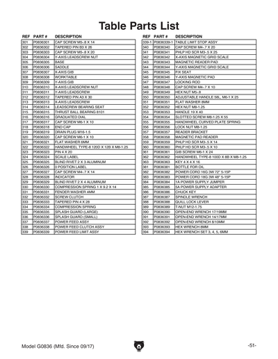

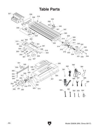

Y-AXIS LEADSCREW NUT
305
BASE
306
SADDLE
307
X-AXIS GIB
308
WORKTABLE
309
Y-AXIS GIB
310
X-AXIS LEADSCREW NUT
311
Y-AXIS LEADSCREW
312
TAPERED PIN A3 X 30
313
X-AXIS LEADSCREW
$24.15
314
LEADSCREW BEARING SEAT
$20.90
315
THRUST BALL BEARING 8101
$3.65
316
GRADUATED DIAL
$15.85
317
CAP SCREW M6-1 X 10
318
END CAP
319
DRAIN PLUG M16-1.5
320
CAP SCREW M6-1 X 10
321
Now: PW03M
FLAT WASHER 6MM
322
HANDWHEEL TYPE-8 120D X 12B X M8-1.25
$19.10
323
PIN 4 X 20
$1.90
324
SCALE LABEL
325
BLIND RIVET 2 X 3 ALUMINUM
326
0 POSITION LABEL
327
CAP SCREW M4-.7 X 14
328
INDICATOR
$1.90
329
BLIND RIVET 2 X 4 ALUMINUM
$1.90
330
COMPRESSION SPRING 1 X 9.2 X 14
331
FENDER WASHER 4MM
$1.90
332
SCREW CLUTCH
$15.15
333
TAPERED PIN 4 X 28
$1.90
334
COMPRESSION SPRING -
335
SPLASH GUARD (LARGE)
336
SPLASH GUARD (SMALL)
337
POWER FEED ASSY
$653.75
338
POWER FEED CLUTCH ASSY
339
POWER FEED LIMIT ASSY
$28.45
339-1
TABLE LIMIT STOP ASSY
340
CAP SCREW M4-.7 X 20
341
Now: PS34
PHLP HD SCR M3-.5 X 25
342
X-AXIS MAGNETIC GRID SCALE
343
MAGNETIC READER PAD
344
Y-AXIS MAGNETIC GRID SCALE
345
FIX SEAT
346
Y-AXIS MAGNETIC PAD
347
LOCKING ROD
348
349
Now: PN06M
HEX NUT M5-.8
350
ADJUSTABLE HANDLE 58L M6-1 X 25
351
Now: PW01M
FLAT WASHER 8MM
352
Now: PN03M
HEX NUT M8-1.25
353
HANDLE 19 X 40
$1.90
354
SLOTTED SCREW M8-1.25 X 55
$1.90
355
HANDWHEEL CURVED PLATE SPRING
$1.90
356
LOCK NUT M8-1.25
357
READER BRACKET
358
MAGNETIC PAD READER
359
Now: PS59M
PHLP HD SCR M3-.5 X 14
360
Now: PS55M
PHLP HD SCR M3-.5 X 10
361
GIB SCREW M6-1 X 24
362
363
Now: PK37M
KEY 4 X 4 X 16
381
BOTTLE FOR OIL
382
POWER CORD FOR MILL/DRILL
383
POWER CORD FOR POWER FEED
$22.35
384
1A POWER SUPPLY ADAPTER 1-15P
$22.35
385
5A POWER SUPPLY ADAPTER
386
CHUCK KEY
387
SPINDLE WRENCH
388
QUILL LOCK LEVER
389
T-NUTS M12-1.75
390
OPEN-END WRENCH 17/19MM
391
OPEN-END WRENCH 14/17MM
392
OPEN-END WRENCH 8/10MM
393
HEX WRENCH 8MM
394
HEX WRENCH SET 3, 4, 5, 6MM
