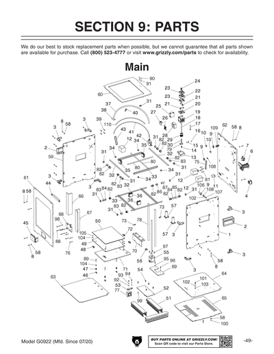

Parts for G0922 Enclosed 3D Printer
Parts Diagrams for G0922 - Enclosed 3D Printer

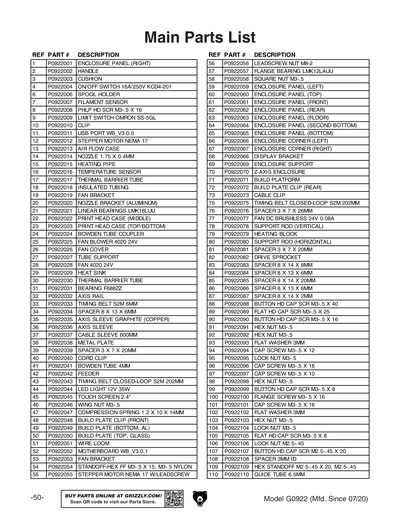

Parts List for Parts for G0922 Enclosed 3D Printer
ENCLOSURE PANEL (RIGHT)
*DISCD*HANDLE
*DISCD*CUSHION
ON/OFF SWITCH 16A/250V KCD4-201
*DISCD*SPOOL HOLDER
$9.50
FILAMENT SENSOR
Now: PS98M
PHLP HD SCR M3-.5 X 16
LIMIT SWITCH OMRON SS-5GL
CLIP
USB PORT WB_V3.0.0
STEPPER MOTOR NEMA 17
AIR FLOW CASE
*DISCD*NOZZLE 1.75 X 0.4MM
HEATING PIPE
TEMPERATURE SENSOR
THERMAL BARRIER TUBE
INSULATED TUBING
$2.05
FAN BRACKET
NOZZLE BRACKET (ALUMINUM)
LINEAR BEARINGS LMK16LUU
PRINT HEAD CASE (MIDDLE)
PRINT HEAD CASE (TOP/BOTTOM)
BOWDEN TUBE COUPLER
FAN BLOWER 4020 24V
FAN COVER
TUBE SUPPORT
FAN 4020 24V
HEAT SINK
$11.25
BEARING F688ZZ
AXIS RAIL
TIMING BELT S2M 6MM
SPACER 8 X 13 X 6MM
AXIS SLEEVE GRAPHITE (COPPER)
AXIS SLEEVE
*DISCD*CABLE SLEEVE 600MM
$6.05
METAL PLATE
SPACER 3 X 7 X 20MM
CORD CLIP
*DISCD*BOWDEN TUBE 4MM
$12.95
*DISCD*FEEDER
$25.30
TIMING BELT CLOSED-LOOP S2M 202MM
LED LIGHT 12V 35W
45
TOUCH SCREEN 2.4"
46
WING NUT M3-.5
COMPRESSION SPRING 1.2 X 10 X 14MM
48
*DISCD*BUILD PLATE CLIP (FRONT)
49
BUILD PLATE (BOTTOM, AL)
50
BUILD PLATE (TOP, GLASS)
51
WIRE LOOM
52
MOTHERBOARD WB_V3.0.1
53
FAN BRACKET
54
STANDOFF-HEX FF M3-.5 X 15, M3-.5 NYLON
55
STEPPER MOTOR NEMA 17 W/LEADSCREW
56
LEADSCREW NUT M8-2
57
FLANGE BEARING LMK12LAUU
58
SQUARE NUT M3-.5
59
ENCLOSURE PANEL (LEFT)
60
ENCLOSURE PANEL (TOP)
61
ENCLOSURE PANEL (FRONT)
62
ENCLOSURE PANEL (REAR)
63
ENCLOSURE PANEL (FLOOR)
64
ENCLOSURE PANEL (SECOND BOTTOM)
65
ENCLOSURE PANEL (BOTTOM)
66
ENCLOSURE CORNER (LEFT)
67
ENCLOSURE CORNER (RIGHT)
68
DISPLAY BRACKET
69
ENCLOSURE SUPPORT
70
Z-AXIS ENCLOSURE
71
*DISCD*BUILD PLATFORM
$13.80
72
*DISCD*BUILD PLATE CLIP (REAR)
73
CABLE CLIP
75
76
SPACER 3 X 7 X 26MM
77
FAN DC BRUSHLESS 24V 0.08A
78
SUPPORT ROD (VERTICAL)
79
HEATING BLOCK
$11.25
80
SUPPORT ROD (HORIZONTAL)
81
SPACER 3 X 7 X 20MM
82
DRIVE SPROCKET
83
SPACER 8 X 14 X 8MM
84
SPACER 8 X 13 X 6MM
85
SPACER 8 X 14 X 20MM
86
SPACER 8 X 13 X 6MM
87
SPACER 8 X 14 X 2MM
88
BUTTON HD CAP SCR M3-.5 X 40
89
FLAT HD CAP SCR M3-.5 X 25
90
BUTTON HD CAP SCR M3-.5 X 16
91
Now: PN07M
HEX NUT M3-.5
92
Now: PN07M
HEX NUT M3-.5
93
Now: PW07M
FLAT WASHER 3MM
94
CAP SCREW M3-.5 X 12
95
LOCK NUT M3-.5
96
CAP SCREW M3-.5 X 16
97
CAP SCREW M3-.5 X 10
98
Now: PN07M
HEX NUT M3-.5
99
BUTTON HD CAP SCR M3-.5 X 8
100
FLANGE SCREW M3-.5 X 16
Now: PW07M
FLAT WASHER 3MM
Now: PN07M
HEX NUT M3-.5
LOCK NUT M3-.5
FLAT HD CAP SCR M3-.5 X 8
106
LOCK NUT M2.5-.45
107
BUTTON HD CAP SCR M2.5-.45 X 20
108
SPACER 3MM ID
109
HEX STANDOFF M2.5-.45 X 20, M2.5-.45
110
GUIDE TUBE 6.5MM

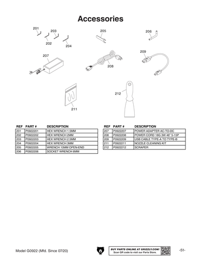

201
HEX WRENCH 1.5MM
202
HEX WRENCH 2MM
203
HEX WRENCH 2.5MM
204
HEX WRENCH 3MM
205
WRENCH 10MM OPEN-END
206
SOCKET WRENCH 6MM
207
*DISCD*POWER ADAPTER AC-TO-DC
208
*DISCD*POWER CORD 18G 3W 46" 5-15P
209
USB CABLE TYPE-A TO TYPE-B
$5.20
211
*DISCD*NOZZLE CLEANING KIT
212
Now: D3711
2" Stainless Scraper
301

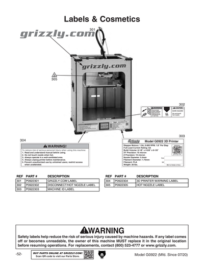

GRIZZLY.COM LABEL 10.5",GREEN
302
DISCONNECT/HOT NOZZLE LABEL
303
MACHINE ID LABEL
304
3D PRINTER WARNING LABEL
305
HOT NOZZLE LABEL
