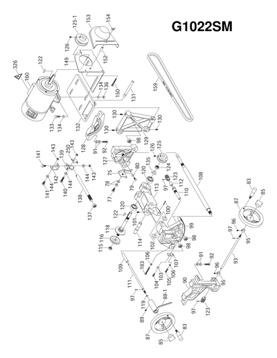

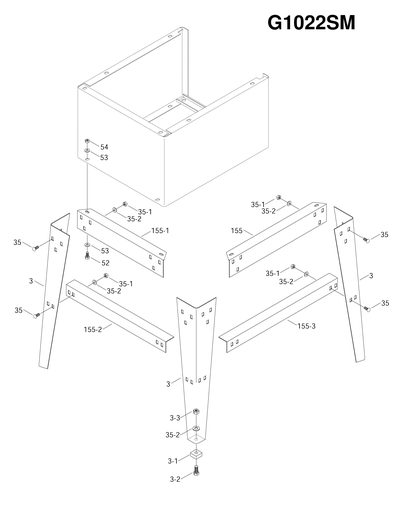

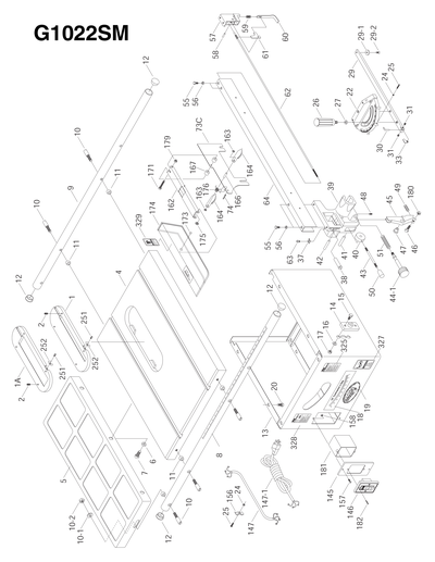

Parts for G1022SM 10" Table Saw
Parts Diagrams for G1022SM - 10" Table Saw

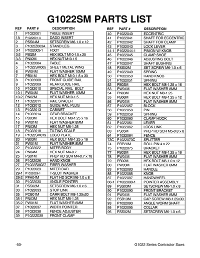

Parts List for Parts for G1022SM 10" Table Saw
Now: H0627
Zero Clearance Table Saw Insert for G1022 Series
1A
*DISCD*DADO INSERT
SET SCREW M6-1 X 12
*DISCD*LEG V2.03.00
3-1
*DISCD*RUBBER FOOT
3-2
Now: PB32M
HEX BOLT M10-1.5 X 25
3-3
Now: PN02M
HEX NUT M10-1.5
*DISCD*TABLE
*DISCD*SHEET METAL EXT WING
Now: PW04M
FLAT WASHER 10MM
Now: PB01M
HEX BOLT M10-1.5 X 30
*DISCD*FRONT GUIDE RAIL
*DISCD*REAR GUIDE RAIL
*DISCD*SPECIAL RAIL BOLT M10-1.5 X 57
10-1
Now: PW04M
FLAT WASHER 10MM
10-2
Now: PN02M
HEX NUT M10-1.5
*DISCD*RAIL SPACER
*DISCD*GUIDE RAIL PLUG
*DISCD*CABINET ASSEMBLY
*DISCD*GEAR BRACKET
Now: PB03M
HEX BOLT M8-1.25 X 16
Now: PW01M
FLAT WASHER 8MM
Now: PN03M
HEX NUT M8-1.25
*DISCD*TILTING SCALE
Now: G9987
Nameplate - Mini
Now: PB03M
Now: PW01M
FLAT WASHER 8MM
Now: H5774
Deluxe Cast-Iron Miter Gauge
Now: PN04M
HEX NUT M4-.7
Now: PS01M
PHLP HD SCR M4-.7 X 18
*DISCD*HAND KNOB
FIBER WASHER 16 X 3.5
$6.65
*DISCD*MITER BAR
29-1
*DISCD*T-SLOT WASHER 8MM BLACK
29-2
FLAT HD SCR M6-1 X 8
*DISCD*ANGLE POINTER
SET SCREW M6-1 X 6
*DISCD*STOP LINK
CARRIAGE BOLT M8-1.25 X 20
35-1
Now: PN03M
HEX NUT M8-1.25
35-2
Now: PW01M
FLAT WASHER 8MM
*DISCD*WIDTH POINTER PLASTIC V2.03.99
*DISCD*FENCE ADJUSTER
*DISCD*FRONT CLAMP
*DISCD*ECCENTRIC
*DISCD*SHAFT FOR ECCENTRIC
*DISCD*SHAFT FOR CLAMP
*DISCD*LOCK LEVER
44-1
*DISCD*PINION W/KNOB
45
*DISCD*CLAMP SHOE
46
*DISCD*ADJUSTING BOLT M10-1.5 X 25
*DISCD*SHAFT BUSHING
48
SET SCREW M6-1 X 6
49
*DISCD*SPRING 11 X 40 X 8
50
*DISCD*HANDLE KNOB
51
*DISCD*SPRING 16 X 65 X 9
52
Now: PB03M
53
Now: PW01M
FLAT WASHER 8MM
54
Now: PN03M
HEX NUT M8-1.25
55
Now: PB06M
HEX BOLT M8-1.25 X 12
56
Now: PW01M
FLAT WASHER 8MM
57
*DISCD*BLOCK
58
*DISCD*PIN 6.35 X 20
59
*DISCD*SPRING 10 X 25 X 8
60
*DISCD*CLAMP HOOK
61
*DISCD*LEVER
62
*DISCD*LOCK LINK
63
Now: PS05M
PHLP HD SCR M5-.8 X 8
64
*DISCD*FENCE
73C
COMPLETE BLADE GUARD ASSY
74
ROLL PIN 4 X 22
75
*DISCD*LINKING BRACKET
77
Now: PB03M
78
Now: PW01M
FLAT WASHER 8MM
79
Now: PB02M
HEX BOLT M6-1 X 12
80
Now: PW03M
FLAT WASHER 6MM
83
*DISCD*HANDLE W/SCREW
85
*DISCD*KNOB M8-1.25 50 X 24MM V1
87
*DISCD*HAND WHEEL
88-1
*DISCD*POINTER ASSEMBLY
89
SET SCREW M6-1 X 8
90
*DISCD*FRONT BRACKET
91
Now: PW01M
FLAT WASHER 8MM
92
CAP SCREW M8-1.25 X 30
93
*DISCD*ANGLE WORM SHAFT
95
*DISCD*COLLAR
96
SET SCREW M6-1 X 6
97
ROLL PIN 3 X 16
98
Now: PN05M
HEX NUT M16-1.5

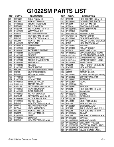

99
*DISCD*FRONT TRUNNION
100
ROLL PIN 5 X 24
SET SCREW M6-1 X 12
*DISCD*WAVY WASHER 18MM
Now: PW03M
FLAT WASHER 6MM
Now: PB08M
HEX BOLT M6-1 X 20
Now: PB10M
HEX BOLT M6-1 X 25
106
Now: PN01M
HEX NUT M6-1
107
*DISCD*SET PLATE
108
*DISCD*LINKING BAR
109
*DISCD*SPACER
110
*DISCD*ECCENTRIC SLEEVE
111
*DISCD*WORM SHAFT
112
*DISCD*SPACER
113
*DISCD*ARBOR BRACKET
114
*DISCD*ARBOR BRACKET PIN
115
*DISCD*ARBOR NUT MT15.875-P2.0
116
ARBOR FLANGE
118
*DISCD*BLADE ARBOR W/SHAFT
119
Now: PR01M
EXT RETAINING RING 10MM
120
BALL BEARING 6203-2RS
122
Now: PK01M
KEY 5 X 5 X 22
123
*DISCD*WORM
124
*DISCD*HEX NUT M17
125
Now: G5422
Single V-Groove Pulley - 2" Pitch Dia., 5/8" Bore
125-1
*DISCD*MOTOR PULLEY
126
SET SCREW M6-1 X 8
127
*DISCD*REAR TRUNNION
128
*DISCD*REAR BRACKET
129
*DISCD*MOTOR BRACKET
130
SET SCREW M6-1 X 12
131
*DISCD*MOTOR PLATE ROD
132
*DISCD*MOTOR PLATE
133
Now: PB07M
HEX BOLT M8-1.25 X 25
134
Now: PW01M
FLAT WASHER 8MM
135
Now: PLW06
LOCK WASHER 5/8
136
Now: PN03M
HEX NUT M8-1.25
137
Now: PN05M
HEX NUT M16-1.5
138
*DISCD*SHAFT
139
*DISCD*BRACKET
140
Now: PB26M
HEX BOLT M8-1.25 X 30
141
Now: PB03M
142
*DISCD*CONNECTING PLATE
143
Now: PN03M
HEX NUT M8-1.25
144
Now: PW01M
FLAT WASHER 8MM
145
SWITCH MOUNT FOR PSW06
146
PUSH BUTTON SWITCH 110/440V 2.2KW
147
POWER CORD 16G X 3W 24"L
147-1
POWER CORD 16G X 3W 73"L
148
*DISCD*HEX SPANNER WRENCH
149
*DISCD*PULLEY GUARD BRACKET
150
Now: PB10
HEX BOLT 1/4-20 X 2
152
FENCE RAIL SPACER
153
*DISCD*PULLEY COVER
154
Now: PWN02
WING NUT 1/4-20
155
*DISCD*UPPER BRACKET LONG-3 HOLE V3.05
155-1
*DISCD*UPPER BRCKT SHORT-3 HOLE V3.05.01
155-2
*DISCD*BRCKET LWER SHORT 2 HOLE V3.05.01
155-3
*DISCD*BRCKET LOWER LONG 2 HOLE V3.05.01
156
*DISCD*WIRE SEAT
157
Now: PS08M
PHLP HD SCR M5-.8 X 12
158
Now: PN06M
HEX NUT M5-.8
159
Now: PVA43
V-BELT A43
160
Now: G2535
Heavy-Duty Motor 1-1/2 HP Single-Phase 3450 RPM TEFC 110V/220V
161
STRAIN RELIEF TYPE-3 M16
162
*DISCD*SUPPORTING ARM
163
*DISCD*RETAINER
164
*DISCD*PAWL
166
*DISCD*HEADLESS CLEVIS PIN GROOVED
167
*DISCD*SPACER
171
Now: PB47M
HEX BOLT M6-1 X 40
173
PIVOT PIN
174
*DISCD*BLADE GUARD ONLY
175
*DISCD*RETAINER
176
*DISCD*SPRING
179
LOCK NUT M6-1
180
Now: PN02M
HEX NUT M10-1.5
181
*DISCD*SWITCH GUARD
182
Now: PS02M
PHLP HD SCR M4-.7 X 12
183
Now: PB39M
HEX BOLT M6-1 X 50
250
*DISCD*CLAMP
251
Now: PS05M
252
*DISCD*STEEL SPRING CLIP .4MM
325
WARNING LABEL
$4.25
326
ELECTRICITY 1.4W X 1.2H
327
SAFETY GLASSES LABEL
$4.25
328
MACHINE ID LABEL
329
*DISCD*BLADE GUARD LABEL
