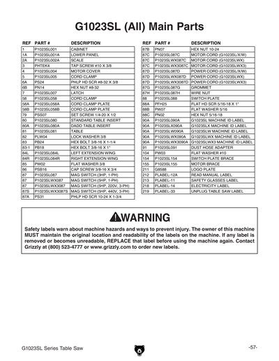

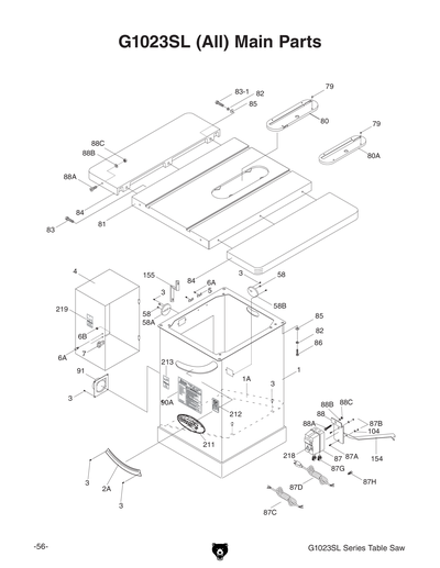

CABINET
1A
PANEL LOWER
SCALE V1.09.01
2A
SCALE V2.03.06
TAP SCREW 10-24 X 3/8
MOTOR COVER
CORD CLAMP
6A
Now: PS01
PHLP HD SCR 10-24 X 1/2
6B
Now: PN07
HEX NUT 10-24
LATCH
7A
STRIKE

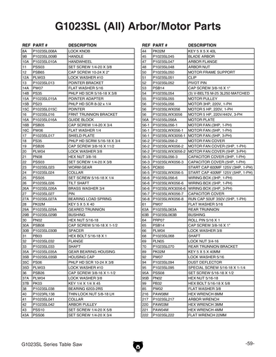

HANDWHEEL LOCK V2.01.06
8A
LOCK KNOB
HANDLE V1.12.95
9B
HANDLE
HANDWHEEL V2.01.06
10A
HANDWHEEL
Now: PSS03
SET SCREW 1/4-20 X 3/8
CAP SCREW 10-24 X 2
12A
Now: PLW03
LOCK WASHER #10
POINTER BRACKET
Now: PS35
PHLP HD SCR 5/16-18 X 3/4
14A
Now: PW07
FLAT WASHER 5/16
14B
Now: PS35
*DISCD*POINTER
15A
POINTER ADAPTER
15B
Now: PS23
PHLP HD SCR 8-32 X 1/4
15C
POINTER

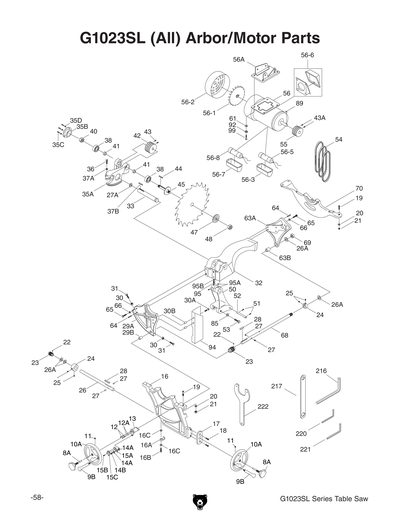

FRONT TRUNNION BRACKET
16A
GUIDE BLOCK
16B
CAP SCREW 1/4-20 X 3/4
16C
Now: PW06
FLAT WASHER 1/4
16D
Now: PW06
FLAT WASHER 1/4
PLATE
Now: PS35
CAP SCREW 3/8-16 X 1-1/2
Now: PLW04
LOCK WASHER 3/8
Now: PN08
HEX NUT 3/8-16
Now: PSS03
WORM 1.410" OD
COLLAR
Now: PSS05
SET SCREW 5/16-18 X 1/4
TILT SHAFT
26A
BRASS WASHER 3/4
DOWEL PIN
27A
***USE P0658004***
Now: PK15M
KEY 5 X 5 X 35
29A
*DISCD*GEARED TRUNNION
29B
BUSHING
Now: PN02
HEX NUT 5/16-18
30A
CAP SCREW 5/16-18 X 1-1/2
30B
SPACER
Now: PB03
HEX BOLT 5/16-18 X 1
FLANGE
SHAFT
*DISCD*GEAR BEARING HOUSING V1.09.01
35A
GEAR BEARING HOUSING V2.09.03
35B
HOUSING CAP
35C
Now: PS06
PHLP HD SCR 10-24 X 3/8
35D
Now: PLW03
LOCK WASHER #10
37A
Now: PLW04
LOCK WASHER 3/8
37B
Now: PK03
KEY 1/4 X 1/4 X 2
BALL BEARING 6203ZZ
Now: PR23M
INT RETAINING RING 40MM
THIN LOCK NUT 5/8-18 LH
COLLAR
ARBOR PULLEY
Now: PSS11
SET SCREW 1/4-20 X 1/4
43A
Now: PSS07
SET SCREW 1/4-20 X 1/2
Now: PK02M
KEY 5 X 5 X 40
45
*DISCD*BLADE ARBOR
46
BLADE
ARBOR FLANGE
48
***USE P1023RL108***
49

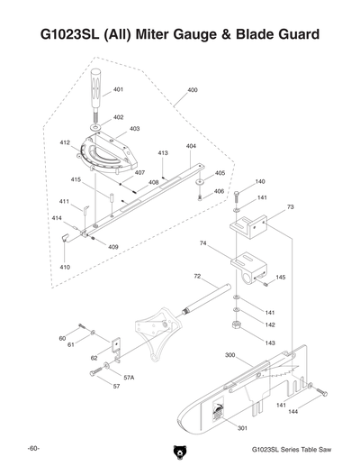

COLLAR
50
MOTOR FRAME SUPPORT
51
CLIP
52
*DISCD*PIVOT PIN
53
54
Now: PVM25
V-BELT M25 3L250
55
MOTOR PULLEY
56
*DISCD*MOTOR 3HP 220V 1-PH
56-1
MOTOR FAN 3HP 1PH
56-2
MOTOR FAN COVER
56-3
CAPACITOR COVER
56-5
Now: PC600
S CAPACITOR 600M 125V 1-3/4 X 3-1/2
56-6
WIRING BOX 3HP 1PH
56A
MOTOR MOUNT PLATE
57
Now: PB15
HEX BOLT 5/16-18 X 3/8
57A
Now: PW07
FLAT WASHER 5/16
58
*DISCD*CORD CLAMP
58A
CORD CLAMP PLATE
58B
CORD CLAMP PLATE
60
Now: PB07
HEX BOLT 5/16-18 X 3/4
61
Now: PW07
FLAT WASHER 5/16
62
SUPPORT BRACKET
63A
*DISCD*REAR TRUNNION
63B
BUSHING
64
Now: PRP07
ROLL PIN 5/16 X 1
65
66
Now: PLW04
LOCK WASHER 3/8
68
*DISCD*SHAFT
69
Now: PN03
HEX NUT 3/4-16
70
REAR TRUNNION BRACKET
72
SHAFT
73
*DISCD*UPPER GUARD BRACKET
74
*DISCD*GUARD BRACKET LOWER
79
Now: PSS07
80
*DISCD*STANDARD TABLE INSERT
80A
*DISCD*DADO TABLE INSERT
80B
SPRING CLIP 10 X 30.7 X 7.5
80C
Now: PS06
81
*DISCD*TABLE
82
Now: PLW04
LOCK WASHER 3/8
83
Now: PB24
HEX BOLT 3/8-16 X 1-1/4
83-1
Now: PB18
HEX BOLT 3/8-16 X 1
84
*DISCD*EXT WING 10" W/BLACK EDGE
84L
EXT WING LEFT
84R
EXTENSION WING RIGHT
85
Now: PW02
FLAT WASHER 3/8
86
CAP SCREW 3/8-16 X 3/4
87
MAGNETIC SWITCH 3HP 1PH
87A
Now: PS31
PHLP HD SCR 10-24 X 1-3/4
87B
Now: PN07
HEX NUT 10-24
87C
POWER CORD 12G X 3W 36"L
87D
POWER CORD 12G X 3W 86"L
87E
Now: G7301
1,000 pc. Cable Tie Assortment
87G
STRAIN RELIEF TYPE-3 MG20A
87H
*DISCD*STATOR
88
SWITCH MOUNT BRACKET
88A
Now: PFH25
FLAT HD SCR 5/16-18 X 1
88B
Now: PW07
FLAT WASHER 5/16
88C
Now: PN02
HEX NUT 5/16-18
89
Now: PK02M
KEY 5 X 5 X 40
90A
MACHINE ID LABEL
91
DUST PORT
92
Now: PW07
FLAT WASHER 5/16
94
*DISCD*DUST DEFLECTOR
95

300
BLADE GUARD ASSEMBLY
301
BLADE GUARD LABEL
30A

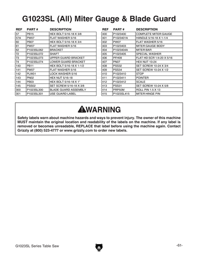

400
*DISCD*COMPLETE MITER GAUGE
401
MITER GAUGE HANDLE V2.10.01
402
Now: PW06
FLAT WASHER 1/4
403
MITER GAUGE BODY V2.05.07
404
MITER BAR ASSY V2.04.03
405
*DISCD*T-SLOT WASHER 8MM BLACK
406
Now: PFH09
FLAT HD SCR 1/4-20 X 5/16
407
Now: PN07
HEX NUT 10-24
408
Now: PSS31
SET SCREW 10-24 X 5/8
409
Now: PSS29
SET SCREW 10-24 X 1/4
410
MITER GAUGE STOP
411
*DISCD*POINTER
412
MITER GAUGE SCALE
413
Now: PSS31
414
ROLL PIN 1.5 X 13
415
MITER GAUGE HINGE PIN

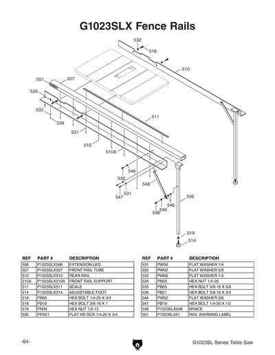

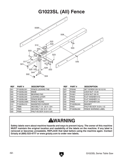

500
HANDWHEEL UPGRADE KIT
501
FENCE LOCKING TAB
502
KNOB 3/8-16, D1-9/16, TAPERED BALL V2.04.07
503
BEARING PAD
504
LOCKING LEVER
506
EXTENSION LEG
$50.75
507
FRONT RAIL TUBE 84"
$151.90
508
FENCE BODY
508A
FENCE FACING
510
REAR RAIL
510A
FRONT RAIL SUPPORT
511
SCALE 53"
$16.35
512
MAGNIFIED CURSOR
514
ADJUSTABLE FOOT
516
Now: PB05
HEX BOLT 1/4-20 X 3/4
516A
FRONT RAIL SUPPORT
517
Now: PB88
HEX BOLT 1/4-20 X 1-3/4
517A
REAR RAIL
518
Now: PB18
HEX BOLT 3/8-16 X 1
519
Now: PN06
HEX NUT 1/2-12
520
Now: PB25
HEX BOLT 3/8-16 X 1-3/4
522
Now: PS06
523
Now: PSS48
SET SCREW 1/4-28 X 5/8
526
Now: PFH21
FLAT HD SCR 10-24 X 3/4
527
Now: PLN02
LOCK NUT 1/4-20
528
Now: PLN01
LOCK NUT 3/8-16
530
Now: PW03
FLAT WASHER #10
531
Now: PW06
FLAT WASHER 1/4
532
Now: PW02
FLAT WASHER 3/8
533
Now: PW06
FLAT WASHER 1/4
534
Now: PN05
HEX NUT 1/4-20
535
Now: PB65
HEX BOLT 3/8-16 X 5/8
536
Now: PB21
HEX BOLT 3/8-16 X 3/4
544
MAGNET
545
Now: PS01
546
Now: PW02
FLAT WASHER 3/8
547
Now: PB19
HEX BOLT 1/4-20 X 1/2
548
BRACE
$10.30
550
FENCE WARNING LABEL
551
RAIL WARNING LABEL
