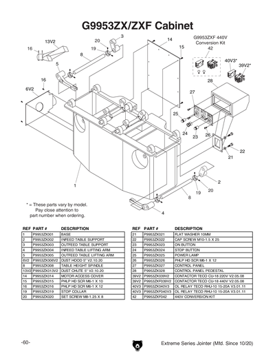

BASE
INFEED TABLE SUPPORT
OUTFEED TABLE SUPPORT
INFEED TABLE LIFTING ARM
OUTFEED TABLE LIFTING ARM
DUST HOOD
6V2
DUST HOOD 5" V2.10.20
$39.85
6V3
DUST HOOD 5" V3.01.21
$54.35
OUTFEED REAR HOUSING
TABLE HEIGHT SPINDLE
INFEED TABLE REAR HOUSING
FRONT TABLE COVER
Now: PW01M
FLAT WASHER 8MM
Now: PB03M
HEX BOLT M8-1.25 X 16
DUST CHUTE
13V2
DUST CHUTE 5" V2.10.20
$326.05
13V3
DUST CHUTE 5" V3.01.21
$398.50
MOTOR ACCESS COVER
Now: PS68M
PHLP HD SCR M6-1 X 10
Now: PS14M
PHLP HD SCR M6-1 X 12
16V2
Now: PB02M
HEX BOLT M6-1 X 12
Now: PW02
FLAT WASHER 3/8
KNOB M10-1.5 X 30
LOCK COLLAR
SET SCREW M8-1.25 X 8
Now: PW04M
FLAT WASHER 10MM
CAP SCREW M10-1.5 X 25
ON BUTTON RENY R9C1VN 22MM GRN
E-STOP BUTTON RENY R9C01VN
POWER INDICATOR LIGHT 22MM RED
Now: PS14M
CONTROL PANEL
CONTROL PANEL PEDESTAL
*DISCD*CONTACTOR TAIAN CN-25 220V V1
39V2
CONTACTOR TECO CU-27 220V V2.05.08
OL RELAY TECO RHN-80A2 40A V1
40V2
*DISCD*OL RELAY TECO RHN-80A2 30-40A V2.
40V3
OL RELAY TECO RHU-80A2 24.5-36A V3.01.11
BRAKE SWITCH
BRAKE PLATE
CAP SCREW M8-1.25 X 35
45
Now: PN03M
HEX NUT M8-1.25
46
BRAKE BRACKET
BRAKE PAD
48
Now: PS01
PHLP HD SCR 10-24 X 1/2
49
Now: PW03
FLAT WASHER #10
50
Now: PS06
PHLP HD SCR 10-24 X 3/8
51
CAP SCREW M8-1.25 X 16
52
Now: PN04M
HEX NUT M4-.7
53
SET SCREW M4-.7 X 50
54
Now: PB71M
HEX BOLT M6-1 X 45
55
Now: PN01M
HEX NUT M6-1
56
TENSION SPRING .9 X 60 X 50 MM
57
Now: W1400
Safety Push Block - Small
58
PNEUMATIC TORQUE WRENCH
59
AIR REGULATOR W/GAUGE
60
BREAKER BAR BIT HOLDER
61
TORX DRIVER T-20
62
TORX BIT T-20

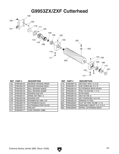

BEARING HOUSING FRONT
BEARING HOUSING REAR
BALL BEARING 6206ZZ
BALL BEARING 6208ZZ
106
BEARING END CAP
107
BRAKE NUT M30-1.5
108
BEARING CAP
109
SPANNER NUT M40-1.5P
110
CUTTERHEAD PULLEY
111
CUTTERHEAD STOP PLATE
112
END CAP
117
LOCK WASHER 10MM
118
Now: PB01M
HEX BOLT M10-1.5 X 30
119
CAP SCREW M5-.8 X 16
120
*DISCD*CUTTERHEAD REAR COVER
121
Now: PS21M
PHLP HD SCR M4-.7 X 15
122
STAR KNOB
123
Now: PN06M
HEX NUT M5-.8
124
SET SCREW M8-1.25 X 20
125
GREASE FITTING 1/8 NPT STRAIGHT

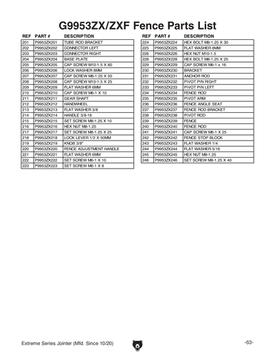

201
TUBE ROD BRACKET
202
CONNECTOR LEFT
203
CONNECTOR RIGHT
204
BASE PLATE
205
CAP SCREW M10-1.5 X 60
206
LOCK WASHER 8MM
207
CAP SCREW M8-1.25 X 50
208
209
Now: PW03M
FLAT WASHER 6MM
210
CAP SCREW M6-1 X 10
211
GEAR SHAFT
212
HANDWHEEL
213
Now: PW02
FLAT WASHER 3/8
214
HANDLE 3/8-16
215
SET SCREW M8-1.25 X 10
216
Now: PN03M
HEX NUT M8-1.25
217
SET SCREW M8-1.25 X 25
218
*DISCD*LOCK LEVER 2PC STANDARD V1
219
KNOB 3/8-16
220
FENCE ADJUSTMENT HANDLE
221
Now: PW03M
FLAT WASHER 6MM
222
SET SCREW M6-1 X 10
223
SET SCREW M6-1 X 8
224
Now: PB26M
HEX BOLT M8-1.25 X 30
225
Now: PW01M
FLAT WASHER 8MM
226
Now: PN02M
HEX NUT M10-1.5
227
Now: PB73M
HEX BOLT M10-1.5 X 50
228
Now: PB07M
HEX BOLT M8-1.25 X 25
229
CAP SCREW M6-1 X 16
230
BRACKET
231
ANCHOR ROD
232
*DISCD*PIVOT PIN RIGHT STANDARD V1
233
*DISCD*PIVOT PIN LEFT STANDARD V1
234
FENCE ROD
235
PIVOT ARM
236
FENCE ANGLE SEAT
237
FENCE ROD BRACKET
238
PIVOT ROD
239
FENCE
240
FENCE ROD
241
CAP SCREW M6-1 X 25
242
FENCE STOP BLOCK
$10.90
243
Now: PW06
FLAT WASHER 1/4
244
Now: PW07
FLAT WASHER 5/16
245
Now: PN03M
HEX NUT M8-1.25
246
SET SCREW M8-1.25 X 40

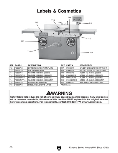

Extreme Series Nameplate
713
714
MACHINE ID LABEL
$16.40
715
PUSH BLOCK WARNING
716
Now: G8589
Nameplate - Large
717
N/S GRIZZLY GREEN G1023S
718
GREY PUTTY REF G0504
719
MODEL NUMBER LABEL
$16.40

901
FLAT HD TORX T20 M6-1 X 15
902
Now: H7319
Indexable Carbide Inserts - 14 x 14 x 2mm, 10-Pk.
903
SPIRAL CUTTERHEAD BODY
$2,381.55
