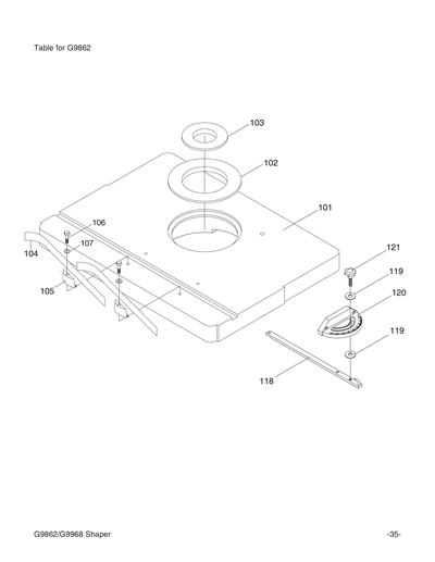

TABLE
*DISCD*TABLE INSERT LARGE
*DISCD*TABLE INSERT SMALL
SPRING PLATE
$18.15
BRACKET SUPPORT
$14.50
106
Now: PB38M
HEX BOLT M12-1.75 X 60
107
Now: PW06M
FLAT WASHER 12MM
108
EXTENSION TABLE
$453.70
109
IRON FRAME
$241.50
110
TABLE MOTION BAR
$105.55
111
FLAT WASHER D13
$2.60
112
Now: PB33M
HEX BOLT M12-1.75 X 50
113
Now: PW01
FLAT WASHER 1/2
114
LOCK WASHER 12MM
115
Now: PW06M
FLAT WASHER 12MM
116
CAP SCREW M12-1.75 X 25
117
TABLE EXTENSION LOCK KNOB
$3.45
118
MITER BAR
119
Now: PW07
FLAT WASHER 5/16
120
MITER BODY
121
LOCK KNOB 5/16-18 X 7/8

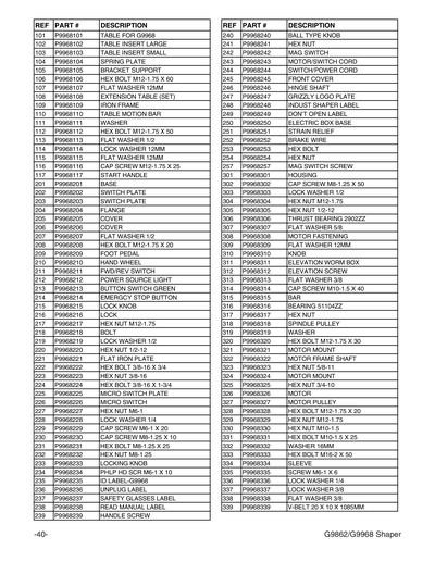

201
BASE
201-2
S CAPACITOR 800M 250V 2 X 4
202
SWITCH PLATE
203
SWITCH PLATE
204
FLANGE
$10.10
205
COVER
206
COVER
207
Now: PW01
FLAT WASHER 1/2
208
Now: PB47M
HEX BOLT M6-1 X 40
209
FOOT PEDAL
210
HANDWHEEL
$63.15
211
FWD/REV SWITCH
$57.70
212
POWER INDICATOR LIGHT 22MM RED
212V2
SWITCH BULB FOR 220V
$4.05
213
BUTTON SWITCH GREEN V1.03.05
$16.65
213V2
SWITCH BULB FOR 440V
214
E-STOP BUTTON AUSPICIOUS ES16G
$19.95
215
LOCK KNOB 1/2"
216
LOCK
$13.80
217
Now: PN09M
HEX NUT M12-1.75
218
ROD 1/2-12 X 108.5
219
Now: PLW07
LOCK WASHER 1/2
220
Now: PN06
HEX NUT 1/2-12
221
FLAT IRON PLATE
222
Now: PB21
HEX BOLT 3/8-16 X 3/4
223
Now: PN08
HEX NUT 3/8-16
224
*DISCD*SPECIAL HEX BOLT M6-1 X 10
225
MICRO SWITCH PLATE
$3.65
226
MICRO SWITCH W/COVER
$16.95
227
Now: PN01M
HEX NUT M6-1
228
Now: PLW02
LOCK WASHER 1/4
229
CAP SCREW M6-1 X 20
230
CAP SCREW M8-1.25 X 10
231
Now: PB07M
HEX BOLT M8-1.25 X 25
232
Now: PN03M
HEX NUT M8-1.25
233
LOCK KNOB
$38.85
234
Now: PS68M
PHLP HD SCR M6-1 X 10
235
WARNING ID LABEL
236
UNPLUG LABEL
237
SAFETY GLASSES LABEL
238
READ MANUAL LABEL
239
Now: PB09M
HEX BOLT M8-1.25 X 20
240
BALL TYPE KNOB 50 X 3/8"
241
Now: PN08
HEX NUT 3/8-16
242
MAG SWITCH TECO 220V V2.03.10
242-1
*DISCD*OL RELAY TECO RHN-18 16/23A V1
242-2
*DISCD*CONTACTOR TAIAN CN-18 440V V1
242A
MAG SWITCH TECO CU-18 440V
242A-1
OL RELAY TECO RHN-10 8.5-12.5
242A-2
CONTACTOR TECO CU-18 440V
242V2
$83.35
242V2-1
CONTACTOR TECO CU-18 220V V2.03.10
242V2-2
OL RELAY TECO RHU-10A1 21-25A V2.03.10
243
MOTOR SWITCH CORD
244
SWITCH/POWER CORD
245
FRONT COVER
246
HINGE SHAFT
247
GRIZZLY LOGO PLATE
248
INDUST SHAPER LABEL
249
DON'T OPEN LABEL
250
ELECTRIC BOX BASE
251
STRAIN RELIEF
252
BRAKE WIRE
$37.00
253
$4.05
254
Now: PN08
HEX NUT 3/8-16
255
*DISCD*HEX BOLT
256
*DISCD*ROUND HD SCREW
257
MAG SWITCH SCREW
258
*DISCD*CONVERSION KIT 440V
259
OFF BUTTON
$11.85

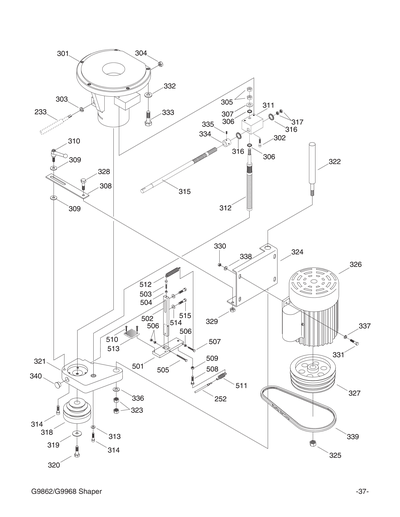

301
HOUSING
302
CAP SCREW M8-1.25 X 50
303
Now: PLW07
LOCK WASHER 1/2
304
Now: PN09M
HEX NUT M12-1.75
305
Now: PN06
HEX NUT 1/2-12
306
Now: P2902
THRUST BEARING 2902
307
Now: PW14
FLAT WASHER 5/8
308
MOTOR FASTENER
$10.95
309
Now: PW06M
FLAT WASHER 12MM
310
KNOB 1/2" X 75MM
311
ELEVATION WORM BOX
312
ELEVATION LEADSCREW M24-4 X 300
313
Now: PW02
FLAT WASHER 3/8
314
CAP SCREW M10-1.5 X 40
315
BAR
316
THRUST BEARING 51104
317
ELEVATION WORM BOX HEX NUT M20-1.5
318
SPINDLE PULLEY
$163.05
319
FENDER WASHER 12MM
$1.49
320
Now: PB27M
HEX BOLT M12-1.75 X 30
321
MOTOR MOUNT
$74.50
322
MOTOR FRAME SHAFT
$17.55
323
Now: PN04
HEX NUT 5/8-11
324
*DISCD*MOTOR MOUNT
$74.50
325
Now: PN17
HEX NUT 3/4-10
326
MOTOR 7-1/2HP 220V/440V 3-PH
$546.75
326-1
*DISCD*CAPACITOR 800MFD 250VAC
327
MOTOR PULLEY
$100.05
328
Now: PB47M
HEX BOLT M6-1 X 40
329
Now: PN09M
HEX NUT M12-1.75
330
Now: PN02M
HEX NUT M10-1.5
331
Now: PB32M
HEX BOLT M10-1.5 X 25
332
Now: PW08M
FLAT WASHER 16MM
333
Now: PB48M
HEX BOLT M10-1.25 X 20
334
SLEEVE
335
Now: PS36
PHLP HD SCR 10-24 X 2-1/2
336
Now: PLW02
LOCK WASHER 1/4
337
Now: PLW04
LOCK WASHER 3/8
338
Now: PW02
FLAT WASHER 3/8
339
V-BELT 20 X 10 X 1085MM
$79.70

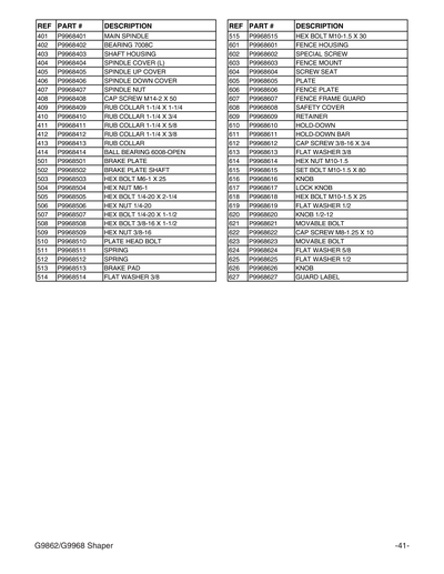

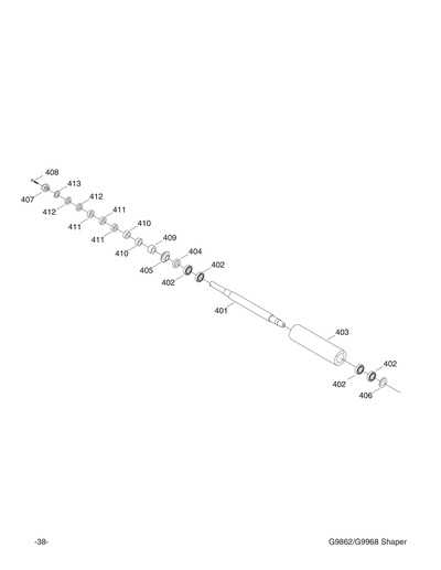

401
*DISCD*MAIN SPINDLE D50 X 693
402
ANGULAR CONTACT BEARING 7008C
403
SHAFT HOUSING
$518.05
404
LEFT SPINDLE COVER
$15.70
405
SPINDLE UP COVER
$23.90
406
SPINDLE DOWN COVER
$13.60
407
SPINDLE NUT
$27.20
408
CAP SCREW M14-2 X 50
409
RUB COLLAR 1-1/4 X 1-1/4
$11.50
410
RUB COLLAR 1-1/4 X 20MM
$8.50
411
RUB COLLAR 1-1/4 X 15MM
$6.40
412
RUB COLLAR 1-1/4 X 10MM
$7.90
413
RUB COLLAR 1-1/4 X 5MM
$4.30
414
BALL BEARING 6008-OPEN
501
BRAKE PLATE
502
BRAKE PLATE SHAFT
$24.75
503
Now: PB10M
HEX BOLT M6-1 X 25
504
Now: PN01M
HEX NUT M6-1
505
Now: PB68
HEX BOLT 1/4-20 X 2-1/4
506
Now: PN05
HEX NUT 1/4-20
507
Now: PB26
HEX BOLT 1/4-20 X 1-1/2
508
Now: PB16
HEX BOLT 3/8-16 X 1-1/2
509
Now: PN08
HEX NUT 3/8-16
510
Now: PS22
PHLP HD SCR 10-24 X 5/8
511
SPRING D22 X D92 X L17MM
$10.90
512
*DISCD*SPRING D2 X D16 X L11MM
513
BRAKE PAD
$10.90
514
Now: PW02
FLAT WASHER 3/8
515
Now: PB01M
HEX BOLT M10-1.5 X 30
601
FENCE HOUSING
602
FENCE MOUNT SCREW M12-1.75 X 76
603
FENCE MOUNT
$196.40
604
ADJUSTMENT KNOB W/O THREADS
$12.95
605
PLATE 25 X 25 X 60
$11.50
606
FENCE PLATE
$289.80
607
FENCE FRAME GUARD
$107.80
608
SAFETY COVER
$72.45
609
RETAINER
$10.90
610
HOLD DOWN 1.5 X 35 X 260
$16.35
611
HOLD DOWN BAR D5/8 X 300
$18.15
612
CAP SCREW 3/8-16 X 3/4
613
Now: PW02
FLAT WASHER 3/8
614
Now: PN02
HEX NUT 5/16-18
615
LEADSCREW M10-1.5 X 80
616
KNOB M10 X 80
$54.35
617
LOCK KNOB M10-1.5 X 25
$7.25
618
Now: PB32M
619
Now: PW01
FLAT WASHER 1/2
620
KNOB 1/2-12
