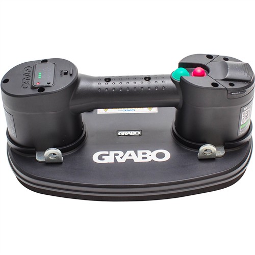

T33783 Nemo GRABO Pro
An electric suction cup that is changing the way to carry heavy items.
Say good-bye to unreliable, and often dangerous, manual suction cups for the job. With GRABO you’ll double your work efficiency with enhanced safety.
The tool is ergonomically designed to provide better grip and less fatigue when moving heavy objects.
The handle is also equipped with a digital display that shows the maximum weight that the GRABO Pro can safely lift at that very moment. The weight is displayed in both pounds and kgs.
Just like the Classic version the powerful vacuum pump and rechargeable battery pack are concealed within the grab handle. The pump makes it possible to lift dusty, semi-porous or rough surfaces.
The foam rubber vacuum seal is strong and resistant to loss of vacuum pressure.
Once the pressure pump is activated, it creates a strong suction and firmly attaches to any non-porous flat surface. The suction is strong enough to hold firm even loads as heavy as 375 pounds.
For maximum lift, the vacuum can stay activated even while you are moving your item. The maximum weight can depend on how you are carrying the material and what material you are carrying. A carrying capacities chart provides you with the safe guidelines for carrying various materials.
GRABO Pro works with the following materials:
  • Glass
  • Laminated cardboard
  • Plastics of all types
  • Wood, both rough and smooth
  • Metals, even ones with diamond plate or other uneven patterned surfaces
  • Tiles, smooth and patterned/uneven surfaces
  • Concrete, paving stones, granite and other less porous stone
  • Dry wall
GRABO Pro is easy to use! Simply do the following:
  1. Place the GRABO on the item that you want to move
  2. Press the green button to activate the vacuum
  3. Smoothly lift the item and move it to where you want to place it.
  4. Monitor the vacuum pressure level via the rubber-protected pressure gauge
  5. Press the red button to release the item
Replacement batteries and seals are available for GRABO Calssic and Pro cups.
Contact GRABO regarding technical support and warranties on their products.
  • Battery type: Li-ion 14.8V DC 2600mAh
  • Rated power: 16W
  • Charger input voltage: 100-240V AC 50/60 HZ
  • Full battery charging time: Approximately 2 hours
  • Non-stop running time on full charge: 1.5 hours
  • Running cycles on full charge: 900 On/off cycles
  • Pump service life: 100,000+ On-Off cycles/800+ hours continuous
  • Stand-by mode charge hold: 30 days
  • Rated air flow: 0.7 cfm
  • Maximum Vacuum Rate: 11.6 PSI
  • Maximum lifting capacity: 375 lbs.
  • Dimensions: 11.67 " x 7.12" x 4.76"
  • Weight including battery: 3.3 lbs.
  • Working temperature: 32°–140° F
  • Applicable surface: Peak/valley heights less than 0.1", arc less than 5°
