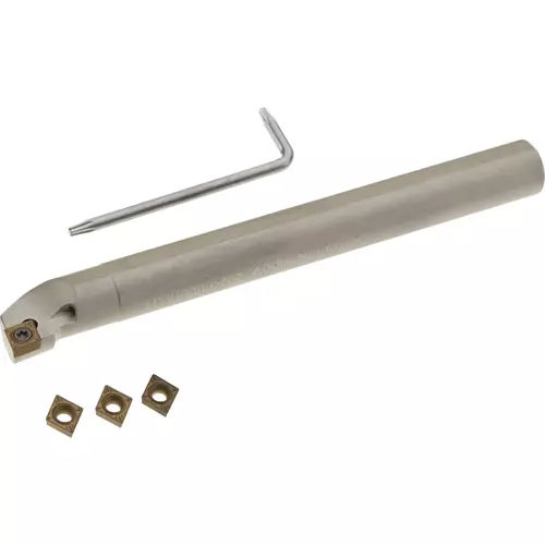

Image for Grizzly T24973 - 1/2" x 5" Length 5 Pc Boring Bar Set with 4 Carbide Inserts
T24973 1/2" x 5" 5-Piece Boring Bar Set with 4 Carbide Inserts
A five-piece set for precision boring.
The geometry of the T24973 Boring Bar Set is designed to allow straight boring to a shoulder, as well as internal facing cuts.
This boring bar uses CCMT inserts.
A very versatile boring bar with a useful for a large range of applications including boring, facing, and internal profiling.
The insert pockets are cut for a tight fit and the -5° cutter profile is fully supported.
Four CCMT 060204 inserts are included. The T20669 Carbide Inserts for steel, stainless, and cast-iron, T20668 Carbide Inserts for cast-iron and aluminum, T10241 Carbide Inserts for steel, stainless, and cast-iron, and H5682 Carbide Inserts for cast-iron are available.
Uses and includes hardened Torx® screw for securing inserts.
The T24972 comes with a 1-year warranty assuring the set is free from factory defects.
The Grizzly Customer Service and Technical Support teams are U.S. based.
  • Overall Length: 4-15/16"
  • Shank: 1/2" Diameter
  • Bore Depth: 3"
  • Minimum Bore: 0.630"
  • Hand: RH
  • Cutting Edge Angle: -5°
  • Bit type: Insert
