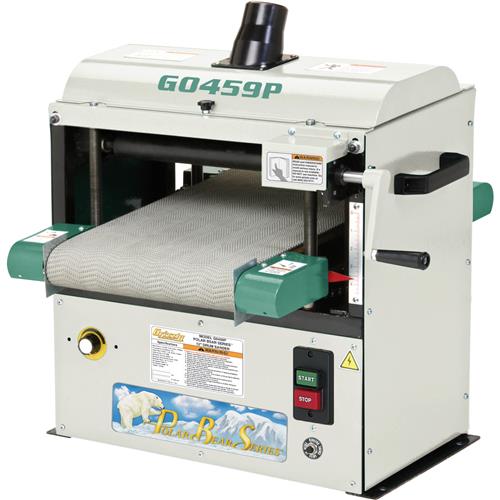

Grizzly G0459P - 12" Baby Drum Sander, Polar Bear Series
This machine is identical to our model G0459 with the exception of the dazzling white color.
We think this baby Polar Bear looks pretty cute in its white coat and green trim, but its ability to surface sand boards up to 12" wide and 3-1/2" thick is all business. Two adjustable pressure rollers ensure uniform results and the variable-speed conveyor lets you dial in the perfect sanded finish. So, take the bite out of surface sanding and put this Polar Bear to work for you! CSA certified meeting CSA C22.2 #71.2-10 and UL 987-7 standards!
  • Sanding motor: 1-1/2 HP, 115V, single-phase, 13A
  • Conveyor motor: 1/8 HP, 115V, single-phase, variable-speed 5-55 RPM, 0.3A
  • Drum surface speed: 2127 RPM
  • Maximum stock dimensions: 12" wide x 3-1/2" thick
  • Minimum stock length: 8"
  • Minimum stock thickness: 1/8"
  • Sanding drum size: 4"
  • Sanding belt size: 3" x 70" hook & loop
  • Dust collection port: 2-1/2"
  • Approximate shipping weight: 166 lbs.
Features:
  • Steel dust hood maximizes dust collection efficiency
  • Two adjustable pressure rollers
  • Thickness scale
  • Independent conveyor motor
  • Industrial-duty conveyor belt
  • Side handles for portability
  • Comes with 120 grit sanding paper
