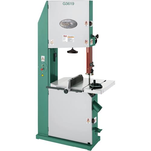

This 900 pound beast can chew through any species of wood that will fit into its 16" vertical capacity, 22-7/8" throat. Dual-belt driven wheels ensure consistent 5200 F.P.M. performance and blades ranging from 1/2" to 2" can be mounted. A strategically placed 4" dust port quickly removes most of the dust generated by the machine. The wheels, fence and 45° tilting table are solid cast iron, a foot brake is provided for quick stops and a blade tensioning scale is mounted for easy front viewing. We have taken considerable effort to ensure that everything about this saw is heavy-duty. If you use it in a production shop, you will not be disappointed.
Features:
  • 23-3/4" x 31-1/2" precision ground cast iron table
  • Foot pedal brake with auto disconnect
  • Built-in 4" dust port
  • Blade guides provide rigid, positive side support
  • Table tilts 45° for bevel cuts
  • Blade speed: 5200 F.P.M.
  • Balanced cast iron wheels
  • Convenient blade tension adjustment using handwheel, scale for correct adjustment of the tension for different blade widths
  • Includes cast iron fence and miter gauge
  • 34-1/4" table height
  • 80-3/4" overall height
  • Cutting height: 13-3/4"
  • Throat capacity is 22-7/8"
  • Rack & pinion upper guide adjustment
  • Uses blades from 1/2" to 2" wide
  • Blade length: 173-5/8" - 176-1/2"
  • Saw includes one 2" blade
  • Sealed and lubricated bearings
  • Weight in place: 748 lbs.
  • Shipping weight approx.: 900 lbs.
