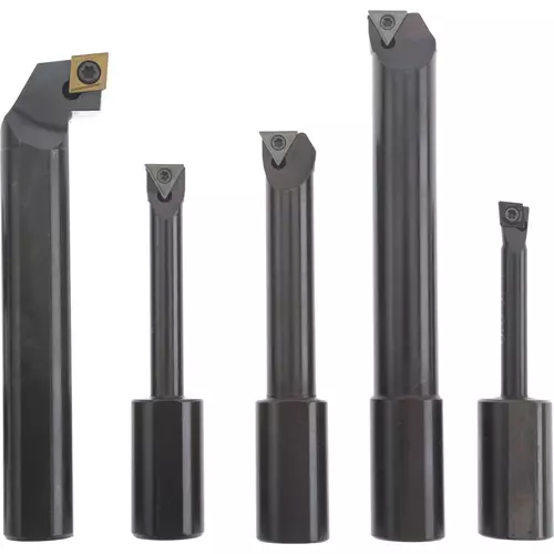

T25936 3/4" 5-Piece Axial and Radial Boring Bar Set
A set of high-end boring bars for precision cutting.
The precision made, five-piece Axial and Radial Boring Bar Set can be used in a 3" boring head as well as lathe tool holders.
Set includes one radial boring bar, four axial boring bars, T8 and T15 wrenches, and a case.
All shank sizes measure 3/4".
The T25936 comes with a 1-year warranty assuring the set is free from factory defects.
The Grizzly Customer Service and Technical Support teams are U.S. based.
  • Overall Length: 5-3/8", Shank: 3/4", Bore Depth: 3-1/2", Min. Bore: 3/4", RH, Cutting Edge Angle: 90°, Replacement bit: T10381
  • Overall Length: 4-7/8", Shank: 3/4", Bore Depth: 2-1/2", Min. Bore: 1-3/16", LH, Cutting Edge Angle: 5°, Replacement bit: H8332
  • Overall Length: 4-1/8", Shank: 3/4", Bore Depth: 2-3/4", Min. Bore: 9/16", RH, Cutting Edge Angle: 90°, Replacement bit: T10381
  • Overall Length: 3-3/4", Shank: 3/4", Bore Depth: 2-1/4", Min. Bore: 1/2", RH, Cutting Edge Angle: 90°, Replacement bit: T10381
  • Overall Length: 3-3/8", Shank: 3/4", Bore Depth: 2", Min. Bore: 3/8", RH, Cutting Edge Angle: 3°, Replacement bit: H5682
INCLUDES:
  • (2) CCMT060204 (CCMT21.51) inserts
  • (1) CCMT09T304 (CCMT32.51) insert
  • (2) TCMT110204 (TCMT21.51) inserts
