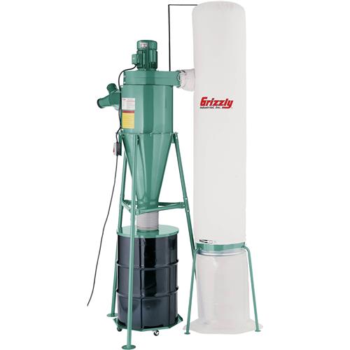

This Two Stage Dust Collector separates heavy particles from the fine particles before they go through the impeller and drops them into your steel or plastic 55 gallon drum. A drum dolly is included for easy mobility. The fine particles are trapped by the filter bag and fall into the disposable plastic bag for easy clean-up. The three-port intake manifold handles multiple machines simultaneously, or it can be removed to connect the dust collector to a mainline duct.
55 gallon drum not included.
  • Intake hole size: 8"
  • Intake adapter hole size (1): 4" x 3 Hole
  • Bag size: 19-5/8" x 32-1/4"
  • Bag capacity: 33 gallon
  • Bag material: Plastic
  • Impeller size: 13"
  • Suction capacity: 2100 CFM
  • Static pressure (inch of water): 14"
  • Overall dimensions of base: 24-3/4" x 24-3/4"
  • Height with bag inflated: 120"
  • Base construction: Pre-formed steel
  • Radial impeller: 3/32" steel, riveted
  • Motor: TEFC capacitor-start induction, 3 HP, single-phase, 220V
  • Amps: 18
  • Cycle/RPM: 60 Hertz/3450 RPM
  • Switch: On/off push-button
  • 1 micron filter bag
  • Approximate shipping weight: 228 lbs.
