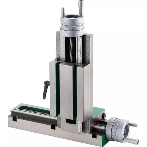

T31765 4" 90° Horizontal/Vertical Slide Table
A stout and precise sliding table for cross slides of metal lathes during milling operations.
The T31765 4" 90° Horizontal/Vertical Slide Table can be used either vertically or horizontally, based on your needs, for milling operations.
This table features heavy-duty construction including two 5/16" T-Slots for locking down your workpieces.
The table has 8-7/8" of horizontal travel and 4-7/8" of vertical travel.
The table measures 3-15/16" x 5-7/8"
The dial has fine graduation of 0.0005" for precision drilling.
The T31765 comes with a 1-year warranty covering parts and assuring the unit is free from factory defects.
Parts and accessories for Grizzly products are available online and shipped from the Grizzly parts warehouse in Springfield, MO.
  • Lead screw: 10 TPI
  • Graduations: 0.0005"
  • Table size: 3-15/16" x 5-7/8"
  • Horizontal travel: 8-7/8"
  • Vertical travel: 4-7/8"
  • T-Slot size: 5/16"
  • Mounting bolt hole: 6 @ 0.350 dia.
  • Footprint: 3-15/16" x 11-7/8"
  • Overall dimensions: 15-3/8" L x 15-1/2" H
  • Weight: 36 lbs.
  • Fine graduations (0.0005")
  • Backlash is adjustable
  • Table lock
  • Quick reference inch scale with 1/8" divisions
