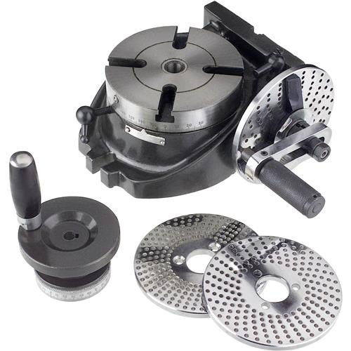

H5940 4" Rotary Table with Indexing
This remarkable little rotary table is priced affordably, too!
A great rotary table for all you model makers and those doing smaller, precision work.
A rotary table allows drilling or cutting at exact intervals around vertical and horizontal axes.
The H5940 4" Rotary Table can be used in the horizontal position for a variety of milling applications.
These different operations include milling eccentric features, cutting arcs, create large diameter holes, and circular profiles.
Control is very accurate and precise thanks to the 5° table movement per handle rotation and 10 second vernier scale.
Features a whole degree scale on the dial, worm gear drive, lash adjustment screw, reference lines and ball bearing rotary support
Like all Grizzly rotary tables, the H5940 comes with a 1-year warranty which covers parts and assures the unit is free from factory defects.
The Grizzly Customer Service and Technical Support Teams are U.S. based. Parts for the rotary table may be available online and shipped from the Grizzly parts warehouse in Springfield, MO.
  • Size: 4"
  • Total T-slots: 4
  • T-Slot size: 5/16"
  • Center Hole: MT #1
  • Approximate weight: 9 lbs.
  • Can be used in horizontal or vertical position
  • 1:72 Ratio or 5° per Revolution
  • Vernier Scale Reads to 10 Seconds
  • Coolant Trough
  • 10mm Locating Keys
