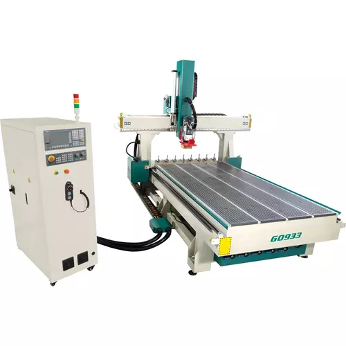

G0933 4' x 8' 4-Axis CNC Router w/ Vacuum Table and Linear Tool Changer
Increase precision and productivity in your production shop.
The G0933 4-Axis CNC Router is a unique machine with a spindle that turns 90 degrees left or right. Creating a true 4th axis, this gives the machine the ability to cut in 3D.
From small surface engraving to large organic shapes, this machine will truly allow your creativity to run wild.
Featuring a linear automatic 8-tool changer, this is the most advanced CNC router we offer, capable of machining complex surfaces over the entire surface of the 4' x 8' bed.
The table has four independently controlled vacuum zones to secure your workpieces during cutting operations.
The compact and user-friendly Siemens® Sinumerik 808D Advanced control is a panel-based CNC controller for basic turning and milling applications.

  • Spindle motor: 12HP, 220V, 3-phase, 24.3A
  • A-, X-, Y-, Z-axis motors: Servo, 3.0A
  • Cutting area: 51-3/16" X x 98-7/16" Y x 15-3/4" Z
  • Spindle speed: 0–24,000 RPM
  • X-Axis travel: 51-3/16"
  • Y-Axis travel 98-7/16"
  • Z-Axis travel: 15-3/4"
  • A-Axis travel 0–90° L/R
  • X- and Y- travel speeds: 1969 IP
  • Z- travel speeds: 787 IPM
  • Collet type: ER32
  • Collet sizes: 1/4", 1/8", 4mm, 6mm
  • Overall dimensions: 128" W x 136" D x 98-1/2" H
  • Approximate shipping weight: 4631
  • Siemens® Sinumerik 808D Advanced with built-In digital display and input
  • Linear automatic 8-tool changer
  • HSD air-cooled spindle motor
  • Vacuum table with four independently controlled zones
  • Tool touch-off pad for quickly setting Z-axis height
  • Two-stage air vacuum pump (requires separate 3-phase, 220V hardwire connection)
  • Automatic oiler for bearing rails
  • Helical rack-and-pinion X- and Y- gantry travel
  • 4th-axis machining capability around Y-axis
