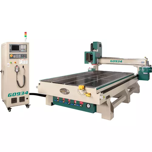

G0934 5' x 10' CNC Router w/ Vacuum Table & 8-Position Rotary Tool Changer
Maximize throughput of your shop.
The G0934 CNC Router features six independently controlled zones on the a massive 5' x 10' vacuum table.
This table enables the user to quickly remove finished parts and then fixture the next workpiece.
The 8-tool rotary automatic tool changer on this machine makes this the most production-ready machine in the Grizzly CNC router product line.
To maximize efficiency, the tool changer is attached to the gantry, meaning tool changes can be done in a matter of seconds right near the cutting area without extra gantry travel.
A bed-mounted tool setter ensures highly repeatable cutting results and helps mitigate manufacturing creep.
The robust and user-friendly Siemens® Sinumerik 808D Advanced control is a panel-based CNC controller for turning and milling applications.
The G0934 is compatible with many common CAD/CAM platforms including, but not limited to:
  • Vcarve and Vcarve Pro
  • Aspire
  • Cut2D
  • Fusion360
  • Solidworks
Like all Grizzly CNC machines, the G0934 comes with a 1-year warranty covering parts and assuring the unit is free from factory defects.
Parts for the CNC machine may be available online and shipped from the Grizzly parts warehouse in Springfield, MO.
  • Spindle motor: 12 HP, 220V, 3-phase, 24.3A
  • A-, X-, Y-, Z-axis motors: Servo, 3.0A
  • Cutting area: 59-1/16" X- x 118-1/8" Y- x 7-7/8" Z-
  • Spindle speed: 0–24,000 RPM
  • X-Axis travel: 59-1/16"
  • Y-Axis travel 118-1/8"
  • Z-Axis travel: 7-7/8"
  • X- and Y- travel speeds: 1969 IPM
  • Z- travel speeds: 787 IPM
  • Overall dimensions: 115" W x 146" D x 76-1/2" H
  • Approximate shipping weight: 3749
  • Siemens® Sinumerik 808D Advanced with built-In digital display and input
  • Rotary automatic 8-tool changer
  • HSD air-cooled spindle motor
  • Vacuum table with six independently controlled zones
  • Tool touch-off pad for quickly setting Z-axis height
  • Two-stage air vacuum pump (requires separate 3-phase, 220V hardwire connection)
  • Automatic oiler for bearing rails
  • Helical rack-and-pinion X- and Y- gantry travel
