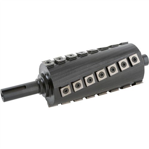

Grizzly T27699 6" Helical Cutterhead
Upgrade your 6" cutterhead and finish at the same time.
The T27699 6" Helical Cutterhead provides quiet operation, better dust collection and dramatic improvement in finish over straight-knife cutterheads.
Each indexable carbide insert can be rotated up to three times to expose a new sharp edge. No more changing and resetting knives every time a blade gets dull.
The indexable carbide inserts are positioned along a helical pattern with the cutting edges at a slight angle to the workpiece for a shearing action that leaves a glassy-smooth cut even on the toughest of woods.
The T27699 comes with all 30 inserts on the cutterhead.
The T27699 installation instructions were written by our U.S. based Technical Documentation Department and is packed with useful information.
The complete and easy to read instructions makes it easier to change the cutterhead on your planer.
We strongly recommend replacing the old cutterhead bearings at the time of installation. The T27699 uses (2) 6004ZZ bearings.
Parts and accessories for the cutterhead are available on-line and shipped from the Grizzly parts warehouse in Springfield, MO.
FITS:
  • Grizzly G0604 6" Jointers
  • Grizzly G0604X 6" Jointers
  • Maximum width of cut: 6"
  • Cutterhead diameter: 75 mm
  • Number of indexable carbide inserts: 30
  • Indexable carbide insert size: 15 x 15 x 2.5mm
Note: Helical heads not capable of rabbeting.
