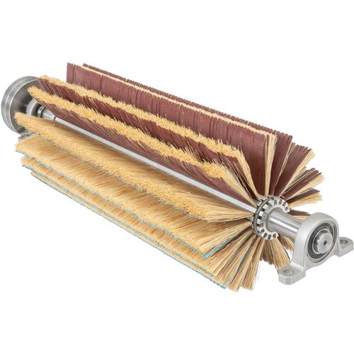

T34379 8" Flatter Brush, 240-Grit
Effortless contour sanding, exceptional results.
The T34379 8" Flatter Brush is the perfect accessory for your G0400 17" Brush Sander. Smooth imperfections in flat and contoured workpieces to leave a uniform finish and reduce hand sanding labor. This brush features premium Swiss aluminum oxide abrasive cloth and durable yet gentle tampico bristles.
Whether you're a production shop owner, cabinetmaker, or high-end DIYer, a 240-grit brush significantly improves your efficiency and the quality of your work. Use it to smooth out lumber imperfections, remove sanding marks on drawer faces, restore molding, and prepare surfaces for finishing on both simple and complex projects.
  • Finish Sanding: Refines edges and contours for a professional look.
  • Smooth Finish: Flexible tampico bristles conform to the contours of workpieces to create a smooth and even finish.
  • Long-Lasting Performance: Durable 240-grit aluminum oxide abrasive ensures long-lasting performance, even under heavy use.
  • Easy to Use: Quickly install in your G0400 sander and start sanding in less than 5 minutes.
Additional flatter brushes are available in the 150-grit T34377 and 180-grit T34378 are sold separately.
The abrasive strips can be easily removed from the hub and replaced when worn, or to switch out grit types. 16-piece replacement flatter brush strip sets are available in 150, 180, and 240-grit varieties.
PRO TIP: Running the brush head with only 8 strips installed increases the maximum depth of sanding and decreases the number of consumables being used. A great method for deep profiles and when learning to operate the G0400 17" Brush Sander.
  • Brush size: 17" Wide x 8" diameter
  • Abrasive grain: Aluminum oxide
  • Abrasive grit: 240
  • Fingers: 87 @ 3/16" wide
  • Suggested RPM range: 400–800
FITS:
  • G0400 G0400 17" Brush Sander
  • T34380 150-Grit Replacement Strips
  • T34381 180-Grit Replacement Strips
  • T34382 240-Grit Replacement Strips
Need help? We offer U.S.-based customer service and technical support to get your questions answered and help keep your equipment running in top condition. And to ensure your satisfaction, the T34379 comes with a 1-year warranty.
