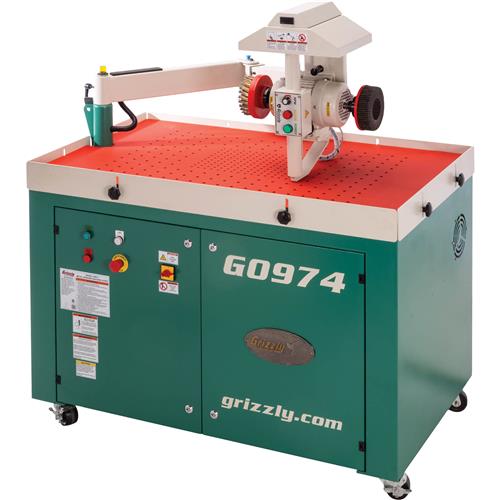

G0974 Deburring Machine
Use this precision-crafted machine to grind, deburr, and polish metal pieces up to four times faster than by hand!
With the four-point articulating arm, the single grinding head allows for two different sanding accessories to be mounted at the same time. Rotate the head 180 degrees to quickly change between grinding metal parts and removing heavy burrs, with the other side brushing and rounding metal to a smooth finish.
The high-friction table keeps larger parts in place as you work, and the vacuum hold-down prevents smaller items from moving during grinding, deburring, and polishing.
The 4" high adjustable table sides provide space for articulating arm movement and keep removed material in a concentrated area.
This efficient and unique metal grinding machine also offers a spindle speed DRO, so it is easy to monitor your speed and adjust as needed via the VFD controller.
There are many discs, brushes, and fastener systems available from T34037–T34061.
The G0974 manual was written by our U.S.-based Technical Documentation Department and is packed with useful information.
CSA certified
  • Main motor: 1 HP, 220V, 3-phase, 3A
  • Vacuum pump motor: 3 HP, 220V, 3-phase, 9A
  • Table size: 51-1/4" W x 31-1/2" D
  • Vacuum table size: 13-3/4" W x 9-7/8 D"
  • Minimum workpiece size: 3-1/8" x 1-7/8"
  • Spindle speed, Variable, 240–1500 RPM
  • Wheel diameters: 150mm
  • Wheel bores: 25mm
  • Maximum height deslagging brush: 2-3/8"
  • Maximum height sanding disc: 3-15/16"
  • Maximum height deburring disc: 3-1/8"
  • Maximum height oxide brush: 2-3/8"
  • Dust collection port: 5"
  • Footprint: 52" x 32"
  • Overall dimensions: 54" W x 36" D x 59" H
  • Approximate shipping weight: 926 lbs.
  • Four-point articulating arm with weight compensation
  • Dual-spindle 1 HP motor rotates 180°
  • Variable spindle speed digital readout
  • Vacuum table for small workpieces
  • Four adjustable table guards
  • Four swivel casters for maneuverability
  • 1-year limited warranty
