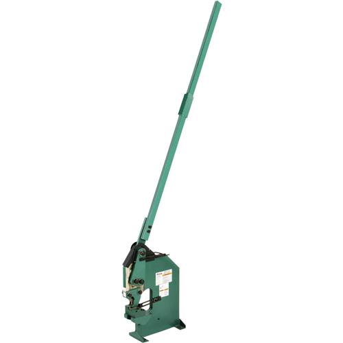

Grizzly T21321 Hand Puncher
Punch holes in steel up to 3/16" thick.
This hand puncher is ideal for hobbyists or metalwork enthusiasts who work on projects with sheet metal up to 3/16" thick.
It's a relatively inexpensive and easy-to-use tool compared to electric or powered punching machines.
Professionals in sheet metal work, HVAC, electrical work, or fence installation will find this hand puncher useful for quick on-site punching needs.
It's portable, doesn't require electricity, and can make clean holes through mild steel for tasks like running electrical conduit, attaching ductwork, or installing fence panels.
Additional punch and die sets are available.
  • Maximum thickness: 3/16" Mild steel
  • Notch stroke: 3/4"
  • Footprint: 6-1/2" x 13-3/4"
  • Approximate shipping weight: 192 lbs.
  • Extra-long handle for increased leverage
  • Leverage multiplying linkage
  • 1/2" Punch and die
  • Work stop for repetitive operations
  • Heavy-duty cast-iron construction
