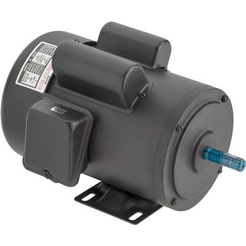

G2535 Heavy-Duty Motor 1-1/2 HP Single-Phase 3450 RPM TEFC 110V/220V Motor
We are very pleased to offer this exceptionally high-quality replacement motor at a discount price.
Is your 1-1/2 HP motor tired and limping on its last legs? No need to buy an entire new woodworking machine, replace the motor!
Made to demanding specifications, these motors offer the same quality as the motors we install on our heavy-duty machines.
If you have applications where dust, oil, chips, or other foreign particles are the norm rather than the exception, you should use a Totally Enclosed Fan-Cooled motor (TEFC).
This 3450 RPM motor has a NEMA 56 frame and is not for air compressor use.
The G2535 instruction sheet was written by our U.S.-based Technical Documentation Department and is packed with useful information.
  • Power: 1-1/2 HP
  • Type: TEFC
  • Cycle: 60 Hz
  • Voltage: 110V/220V
  • Prewired: 110V
  • Amperage: 15.6A/7.8A
  • Phase: Single-phase
  • Speed: 3450 RPM
  • Class: E
  • Start capacitor: 400MFD 125VAC
  • Run capacitor: 25MFD 250VAC
  • Rotation: Reversible
  • U: 5/8"
  • N: 1.89"
  • Key: 3/16"
  • C: 13.12"
  • O: 8.08"
  • D: 3.55"
  • F: 2.95"
  • E: 4.92"
  • Totally Enclosed Fan-Cooled motor (TEFC)
  • Reversible rotation
  • 1-year limited warranty
Note: See second photo with motor schematic breakdown.
