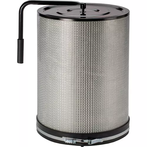

T30488 HEPA Filter Upgrade for G0548ZP & G0562ZP
It is time to upgrade your dust collector with a HEPA filter.
The T30488 HEPA Filter Upgrade for G0548ZP and G0562ZP is a MERV-17 rated filter that captures the finest dust.
The filter has three layers; the spun-bond polyester first layer is rated at 1-micron.
The second layer is the HEPA layer and captures 99.98% of 0.3-micron particles.
The third layer is a fiberglass-reinforced layer to strengthen the HEPA layer.
Replacing your filter not only helps increase the longevity of your dust collector, but also leads to a cleaner work environment and optimal lung health.
Simply turn the handle on the top a half turn in either direction to clean the canister.
The handle controls three flappers inside and shakes the dust from the filter letting the fine dust fall directly into the collection bag
  • Filtration rating: 0.3-micron
  • MERV rating: MERV-17
  • Filter dimensions: 19-5/8" diameter x 23-5/8" length
