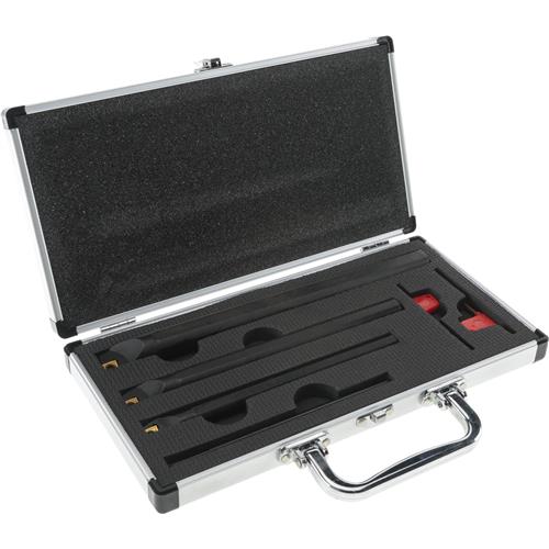

Grizzly H8185 - Indexable Boring Bar 4 pc. Set
H8185 Indexable Boring Bar 4-Piece Set
A set of high-end boring bars for precision cutting.
The precision made four-piece H8185 Indexable Boring Bar Set features 80° diamond CCMT inserts with negative 5° end and side cutting angles.
The 6" long by 3/8" shank boring bar uses a smaller carbide insert than the other three bars.
The smaller-sized T20669 and larger-sized H8332 replacement inserts are available.
The other bars are 7" long by 1/2" shank, 8" long by 5/8" shank, and 10" long by 3/4" shank respectively.
The set includes a fitted and cushioned aluminum box and two Torx® wrenches.
The H8185 comes with a 1-year warranty assuring the set is free from factory defects.
The Grizzly Customer Service and Technical Support teams are U.S. based.
  • Overall Length: 6", Shank: 3/8", Bore Depth: 3", Min. Bore: 1/2", RH
  • Overall Length: 7", Shank: 1/2", Bore Depth: 3-1/2", Min. Bore: 5/8", RH
  • Overall Length: 8", Shank: 5/8", Bore Depth: 5", Min. Bore: 3/4", RH
  • Overall Length: 10", Shank: 3/4", Bore Depth: 7", Min. Bore: 7/8", RH
