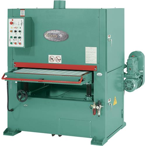

Image for Grizzly G7217 - Industrial 37" Wide Belt Sander
Whether you're a huge furniture factory or a one man production shop, you know the man hours it takes to prepare stock for finishing. Our Grizzly wide belts make it cost effective to sand doors, frames, panels, and wood parts in preparation for the finishing room for a perfect finish. You'll get the exact results you couldn't achieve from hand sanding, and best of all, the time it saves will actually save you money in the long run. Air control belt replacement is super fast.
Features:
  • Sands up to 36" wide by 5" thick
  • 3 separate drive motors for sanding belt, table raising and belt feed
  • Table feed and table height adjustment with separate controls from front panel
  • Pneumatic belt tension / tracking
  • Electronic eye for oscillator control and limit switch
  • Emergency shut off to eliminate belt run-off damage
  • Load meter
  • Overall Dimensions: 67-1/2" H x 57" D x 62" W
  • Variable-speed conveyor: 17.5 - 80 FPM
  • Belt feed motor: 2 HP
  • Sanding drum motor: 15 HP
  • Table height motor: 1/2 HP
  • Requires three phase, 220V/440V electrical and 50 PSI air
  • Drum diameter: 5-1/8"
  • Sanding belt speed: 2800 SFPM
  • Air requirement: 75 PSI, 6.6 CFM
  • Approx. shipping weight: 2600 lbs.
