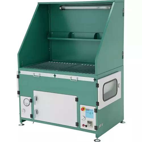

This Downdraft Table uses a unique paper filter on a roll to trap oil contamination, which would otherwise clog the pleated filters. Maximum CFM is maintained by an electronic paper filter advance mechanism.
- Motor: 1-1/2 HP
- CFM: 1,500
- Overall size: 54-3/4" x 39-3/8" x 70-7/8"
- Approximate shipping weight: 794 lbs.
Features:
- 4-stage filter system
- Stainless steel mesh captures sparks and steel chips
- Rolling paper filter with automatic advance absorbs oil and mist
- Pleated filters with vibrating function captures 85% of 1 micron particles
- Pleated HEPA filter cleans noxious fumes and captures 99.97% of 0.3 micron particles
- Manometer gauge indicates filter efficiency
- Sealed fluorescent lamp and built-in shelf
