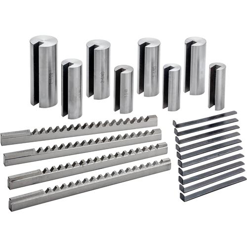

G9773 22-Piece HSS Keyway Broach Set
Cut and bore keyways in gears, pulleys, and shafts.
Using the G9773 22-Piece HSS Keyway Broach Set is the quickest and easiest way to produce a keyway.
A keyway is a slot that is cut on a gear, pulley, or shaft which covers the other half of the key projecting out of the shaft in which it is seated.
This set is comprised of four broaches, eight bushings or inserts, and ten shims.
The teeth of the broaches were ground in a graduated taper. As the tool is being pushed into the material, each tooth cut a little bit of material at a time.
This set is considered a multiple pass kit meaning a shim can be added to the bushing after every pass to cut a deeper slot.
It is recommended to use liberal amounts of an appropriate cutting fluid for the material being cut.
The set comes in a fitted wood case.
INCLUDES:
  • 5/16"D broach
  • 3/8" D broach
  • 7/16" D broach
  • 1/2" D broach
  • 1-1/2"D bushing
  • 1-5/8"D bushing
  • 1-3/4"D bushing
  • 1-7/8" D bushing
  • 2" D bushing
  • 2-1/8" D bushing
  • 2-1/4" D bushing
  • 2-1/2" D bushing
  • Ten shims
