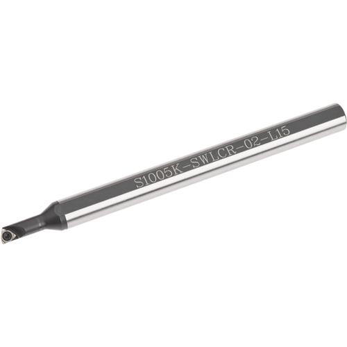

T10242 10mm Shank to 5mm, Right-Hand Mini Boring Bar
Made to exacting specifications for rigidity and precision.
The T10240 Mini Boring Bar features a large shank and cut down neck to help ensure rigidity and precision when boring small holes on big machines.
Maximum depth of cut is 0.515".
The insert pockets are cut for a tight fit and the -5° cutter profile is fully supported.
Inserts are not included. The T10247 Carbide Inserts for cast-iron and aluminum are available.
Uses and includes hardened Torx® screw for securing inserts.
The T10242 comes with a 1-year warranty assuring the set is free from factory defects.
The Grizzly Customer Service and Technical Support teams are U.S. based.
  • Overall Length: 125mm
  • Shank: 10mm Diameter
  • Bore Depth: 2"
  • Minimum Bore: 0.230"
  • Hand: RH
  • Cutting Edge Angle: -5°
  • Bit type: Insert
