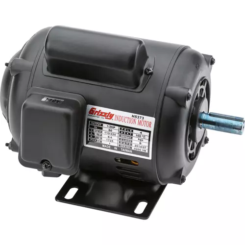

H5373 1/2 HP Single-Phase 1725 RPM ODP 110V/220V Motor for G4008-09
A direct replacement motor for a Grizzly G4008 and G4009 drill presses.
Is your motor tired and limping on its last legs? No need to buy an entire new drill press, replace the motor!
We are very pleased to offer this exceptionally high-quality motor at a discount price for the G4008 Benchtop Drill Press and G4009 Heavy-Duty Drill Press.
This Open Drip Proof motor (ODP) is for use in relatively clean environments.
This motor has a NEMA 56 frame and is not for air compressor use.
The H5373 instruction sheet was written by our U.S.-based Technical Documentation Department and is packed with useful information.
  • Power: 1/2 HP
  • Type: ODP
  • Cycle: 60 Hz
  • Voltage: 110V/220V
  • Prewired: 110V
  • Amperage: 8A/4A
  • Phase: Single-phase
  • Speed: 1725 RPM
  • Class: B
  • Start capacitor: 200MFD 125VAC
  • Rotation: Reversible
  • U: 5/8"
  • N: 1.56"
  • Key: 3/16"
  • C: 10.07"
  • O: 5.81"
  • D: 3.00"
  • F: 3.00"
  • E: 5.00"
  • Open vent ODP motor
  • Reversible rotation
  • 1-year limited warranty
Note: See second photo with motor schematic breakdown.
